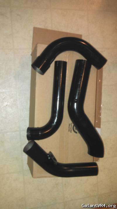

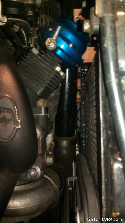

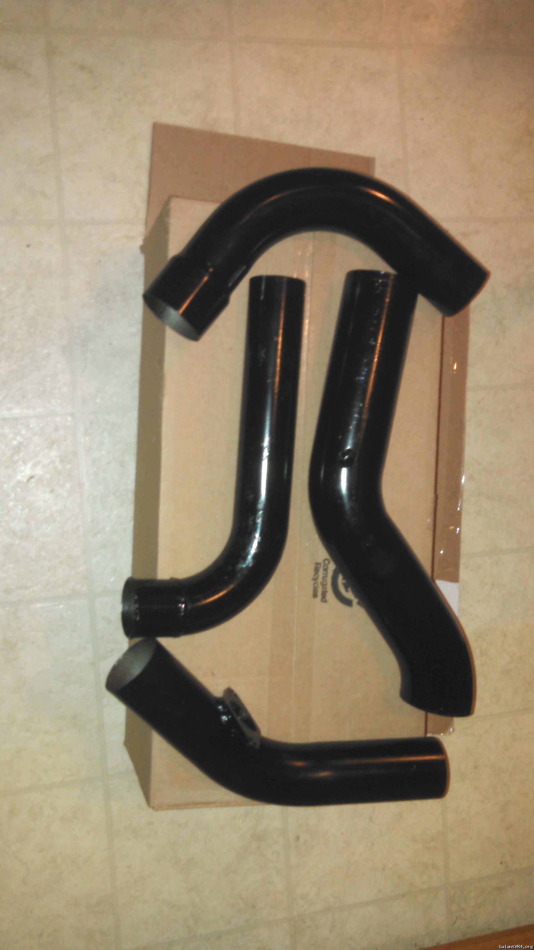

Anyway Intake and intercooler are done.

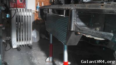

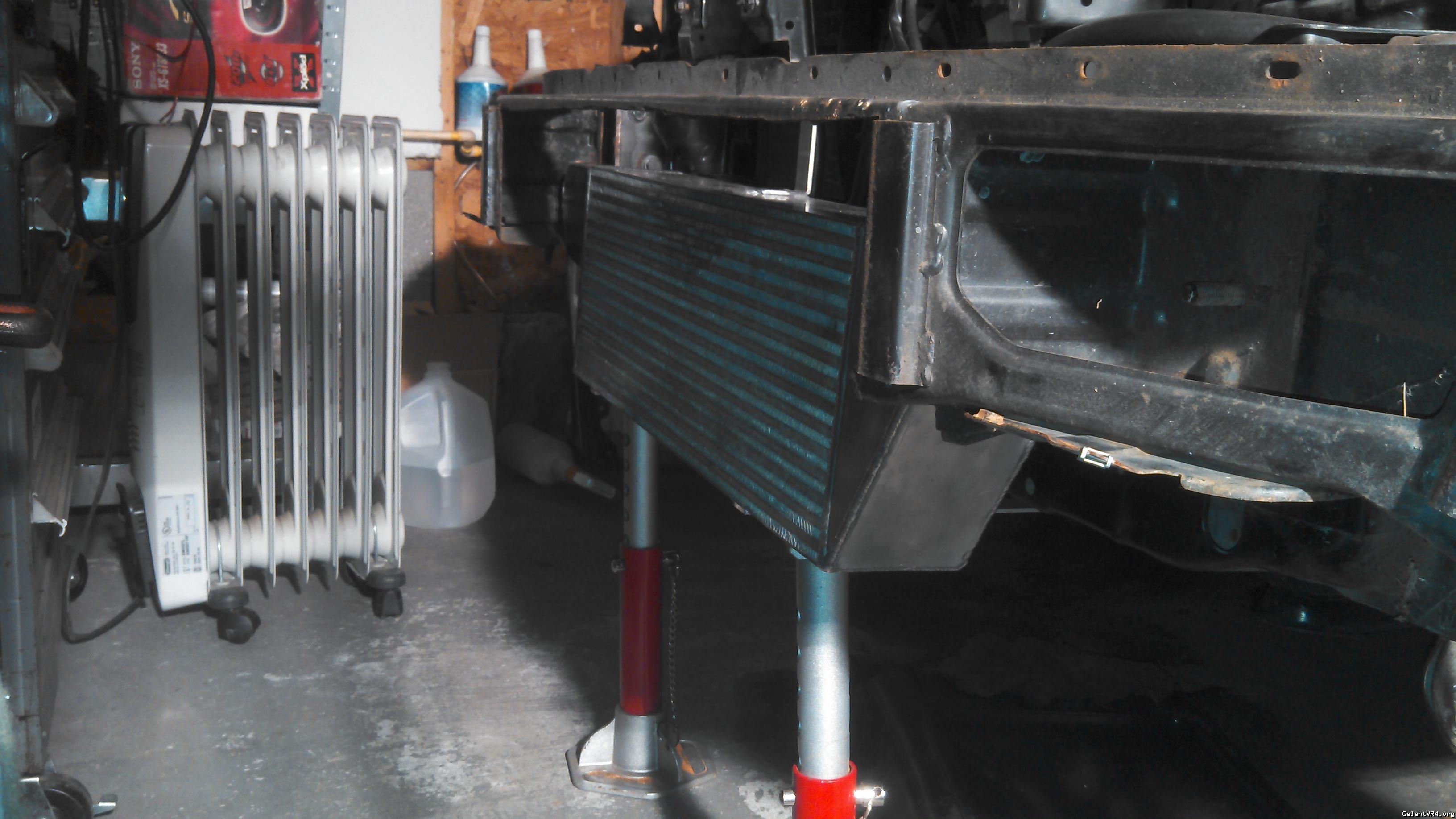

Test fit of my intercooler piping.
Spearco intercooler, front bumper crash bar already precut.
My measurements for the lower mounting tab was 1/2" off /ubbthreads/images/graemlins/banghead.gif, Now I need to get this thing rewelded.

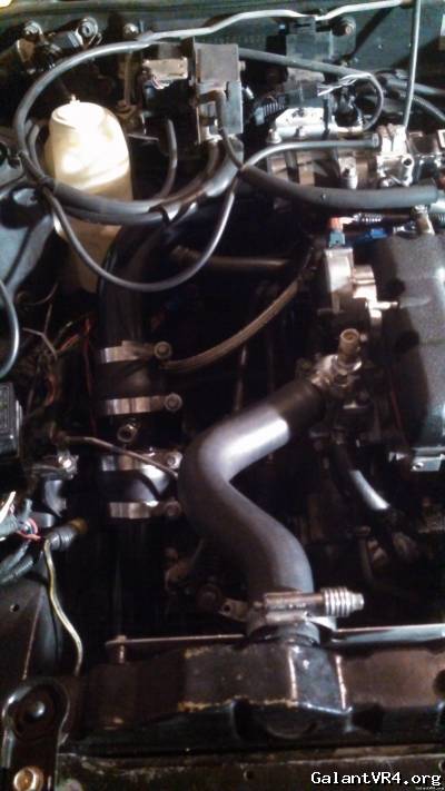

Next I did a boost leak test and I couldn't even build past 1 PSI. I had a major leak coming from the TB seal, so I had to order a new one.
