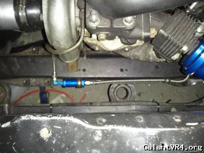

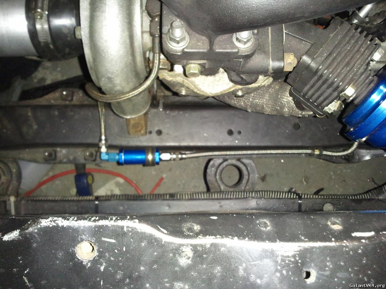

-Made and Routed Oil feed line for turbo, including an Earl's -4 AN inline filter.

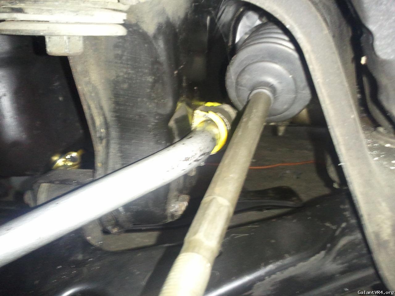

You have anymore info on those brackets? It also looks like something was welded on the side.

The brackets were custom made locally. The welding you can see is on the sway bar itself and not the bracket. With stock or poly bushings the bar is held tight and any movement is taken up by the elasticity of the bushing itself. Here the bar rotates freely inside a hard 'bushing' inside the bracket. It isn't loose but at the same time sufficient force would cause some lateral movement. The 'stop' was welded on to the bar to prevent that and keep the bar central. It has one at each end.
I agree it seems highly likely that that is why I never managed to get my bushings to fit. These brackets have worked so well for me I recently had the same thing done for the 27 mm bar I am putting onto the rear of the daily and eventually I may do something similar at the front on that car as well.

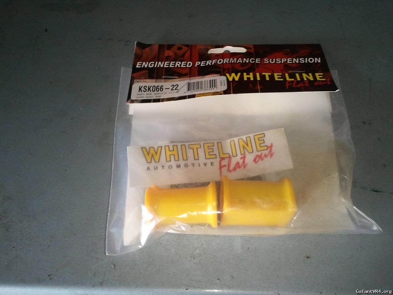

After waiting 17 days I got these in yesterday.
Here they are installed and they do fit. Installation was not the easiest thing to do, but overall not as bad as everybody makes it out to be or maybe it's the aircraft mechanic skills. /ubbthreads/images/graemlins/devil.gif. My Whiteline 22mm anti-sway bar was up, bolted and tq'ed to spec in 10 minutes.

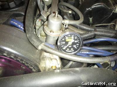

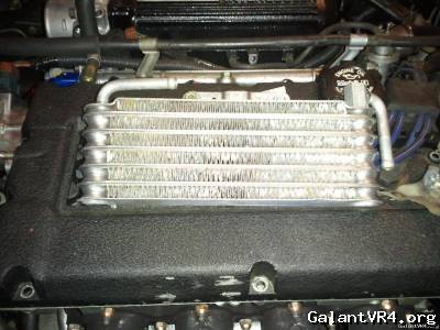

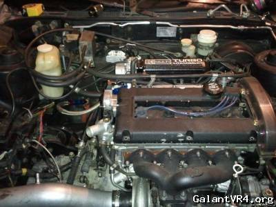

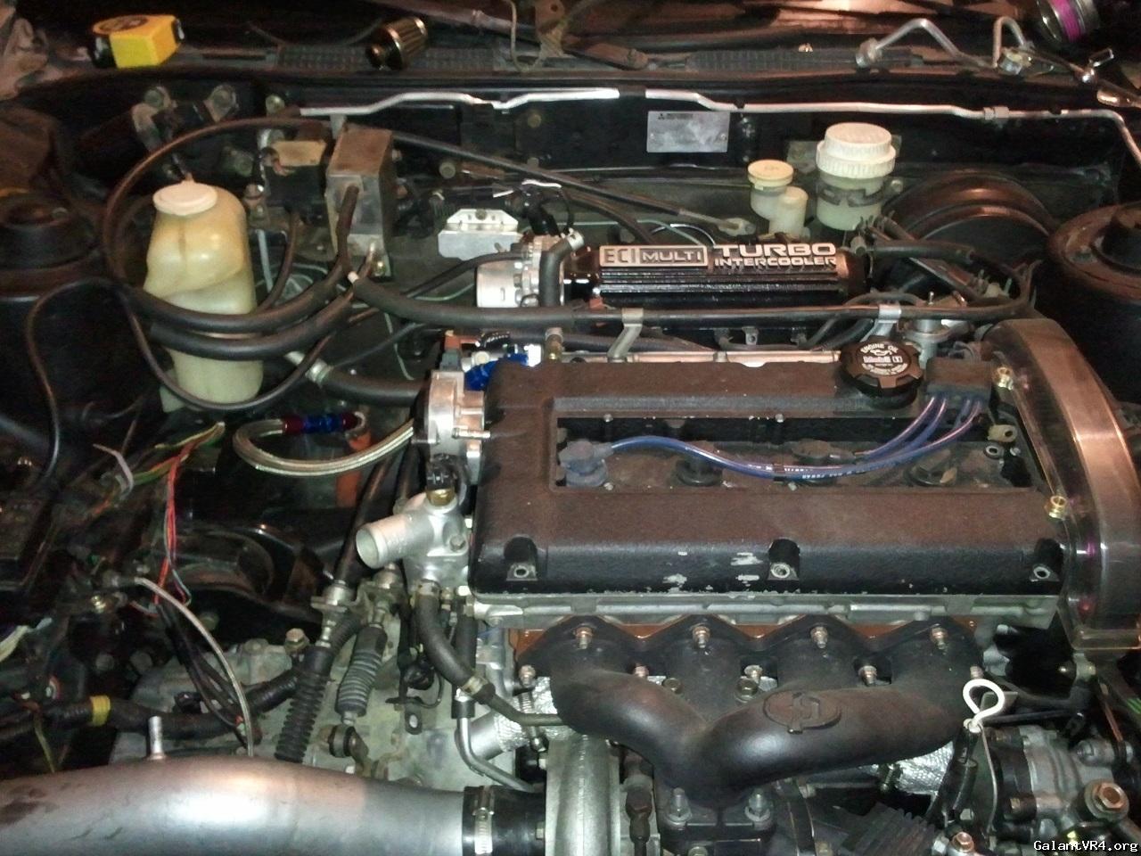

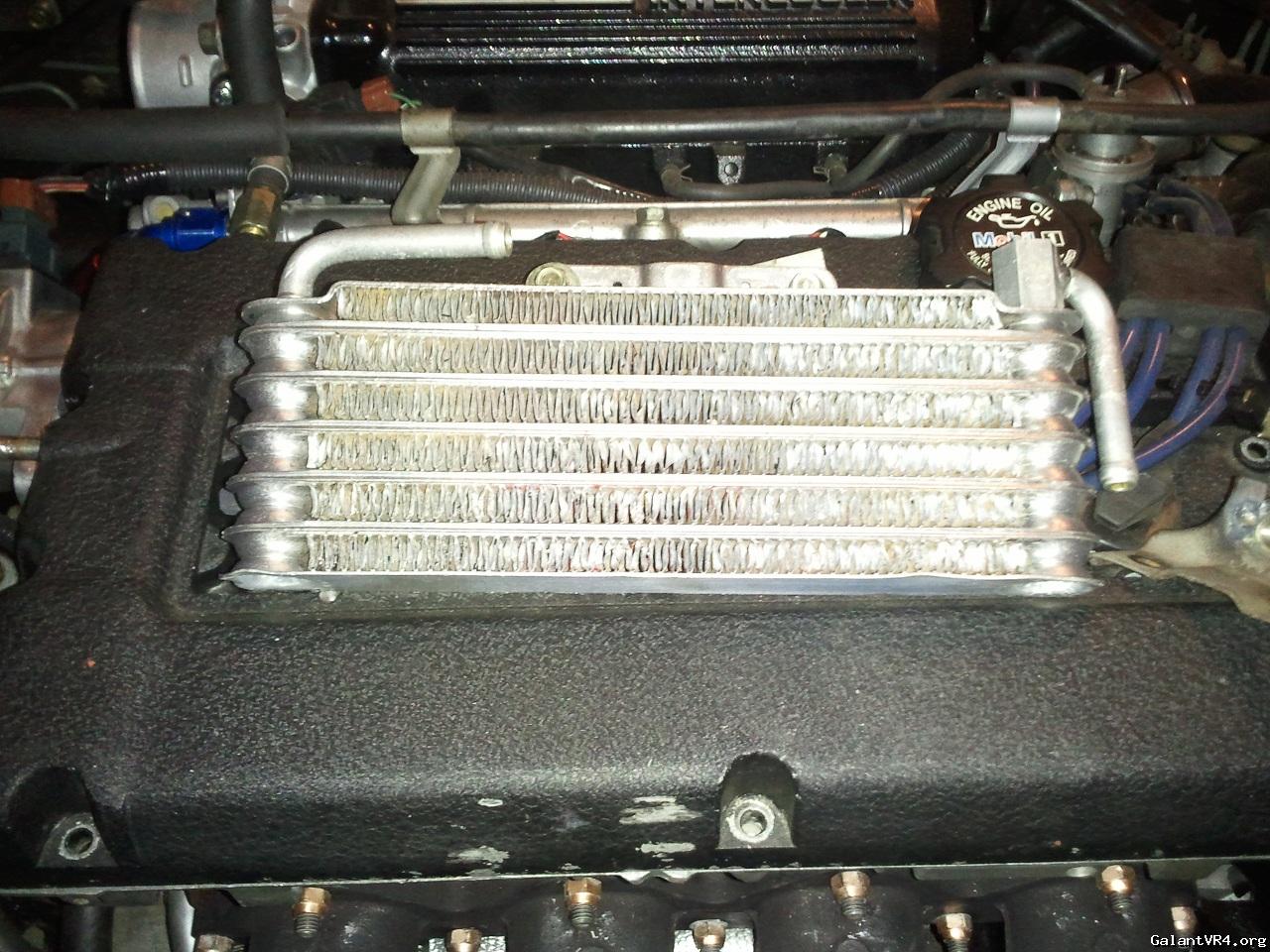

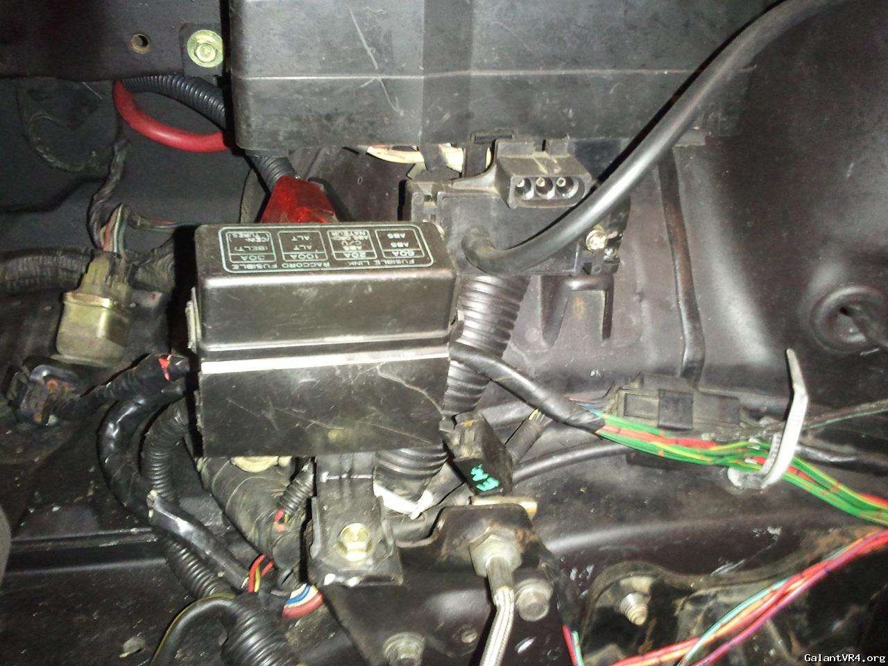

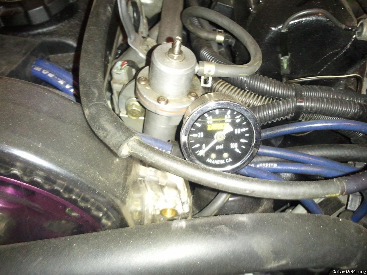

This is the engine bay in its current state. I'm waiting until end of the build to paint the valve cover since it's tool holder most of the time.
Old school Charged Air Systems AFPR with Jegs gauge.
Fuse holder that everybody always leave danging, and 3 BAR GM MAP sensor mounted.
-4 AN Oil feed hose that I made fed from OFH. Inline Earl's filter. The 90 deg there to clear my Civic FAL fan.
My "new" power steering cooler, since I never had one.

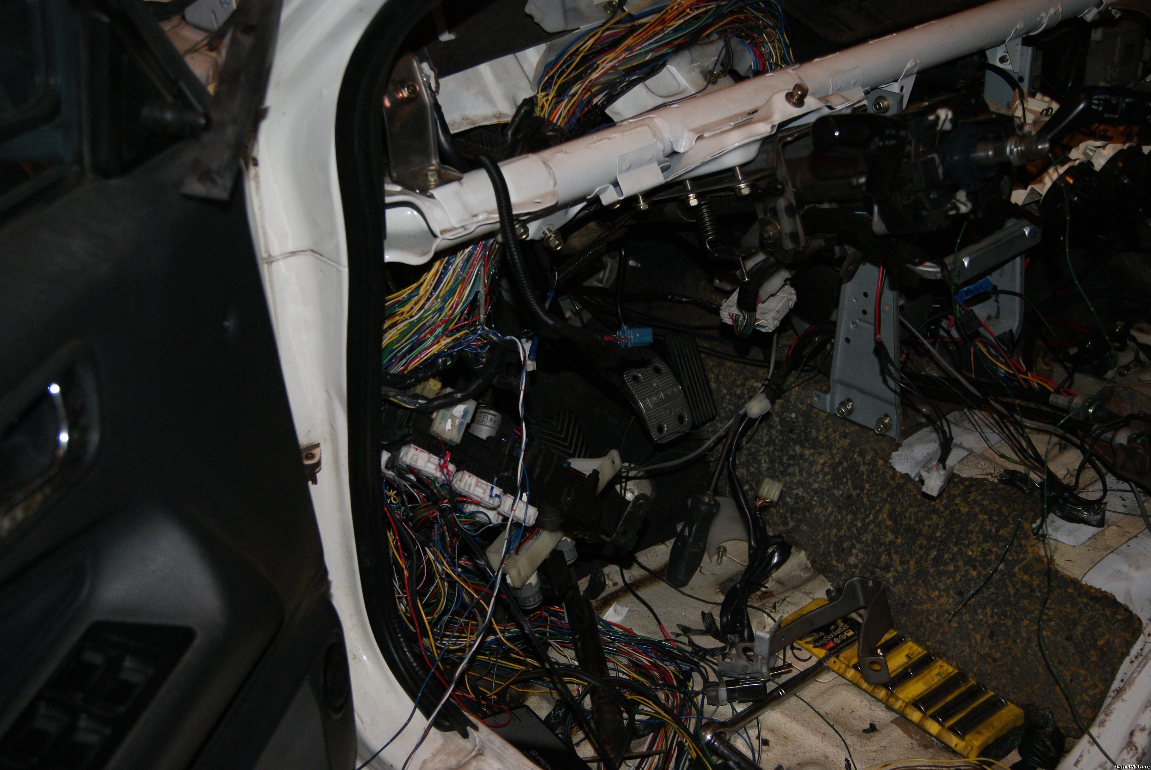

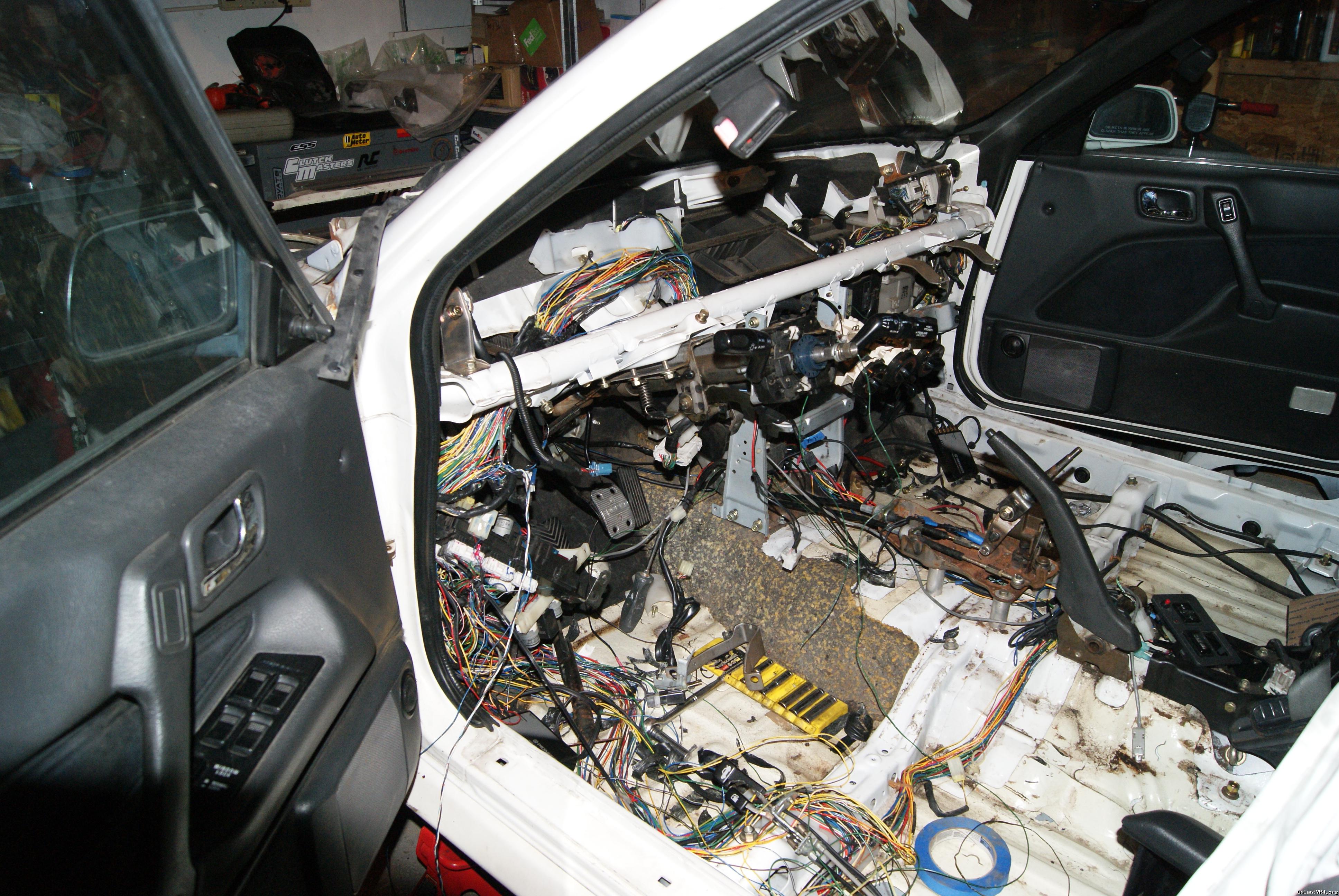

Quoting citymunky:

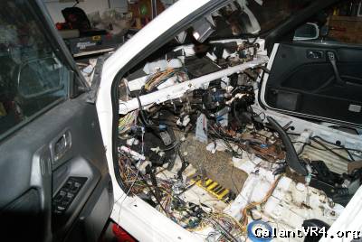

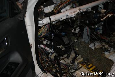

I removed the dash yesterday, so I can finish removing all trances of the ABS wiring.
Pulling wires in the under the dash.
these pics make me want to reach for the ibuprofen or booze and close my eyes.
citymunky
Sep 22, 2010
1,761
Chesapeake, VA
^LOL. It was not as bad as you think.

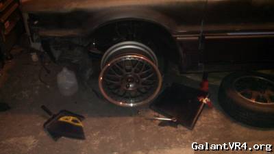

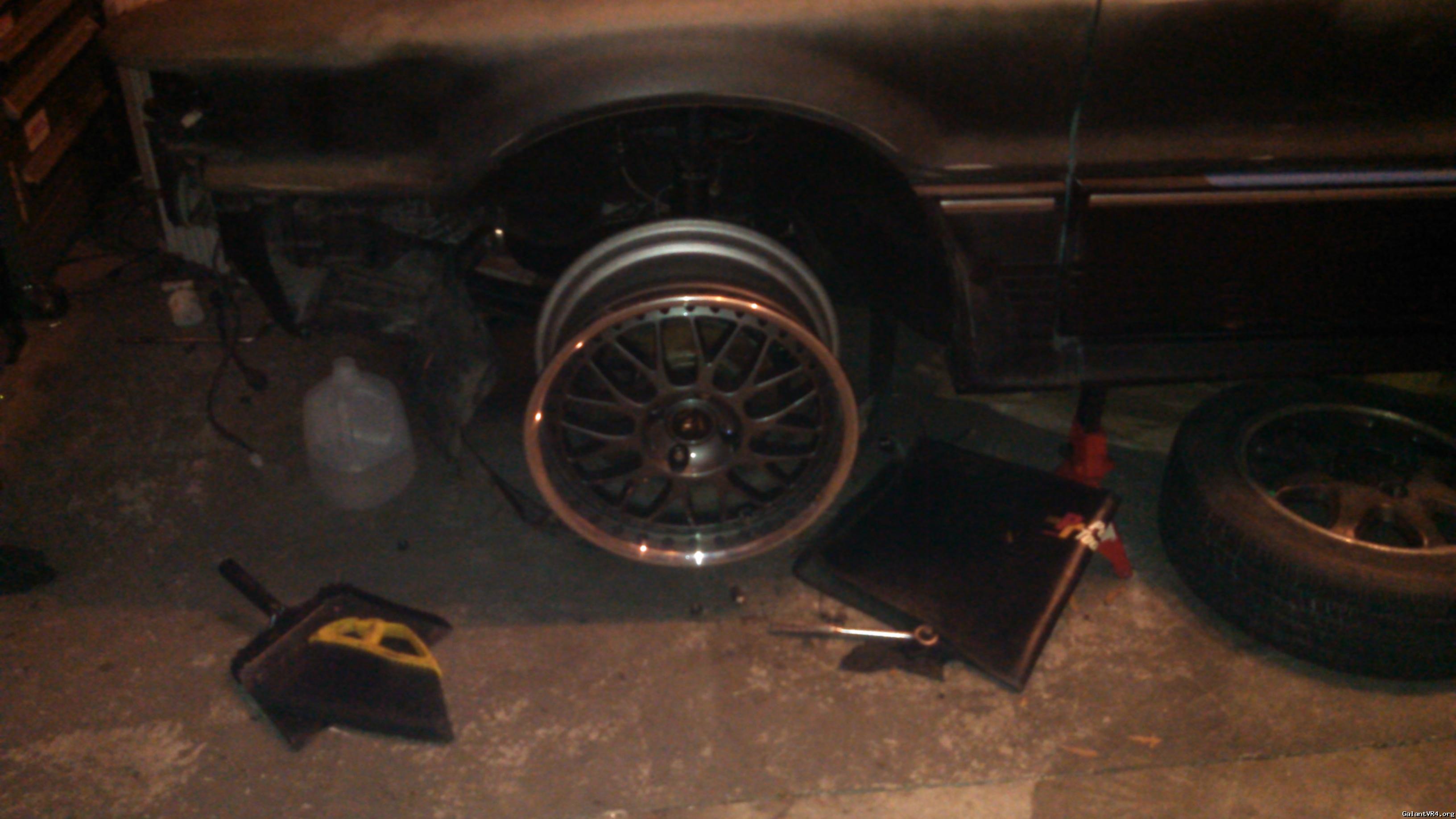

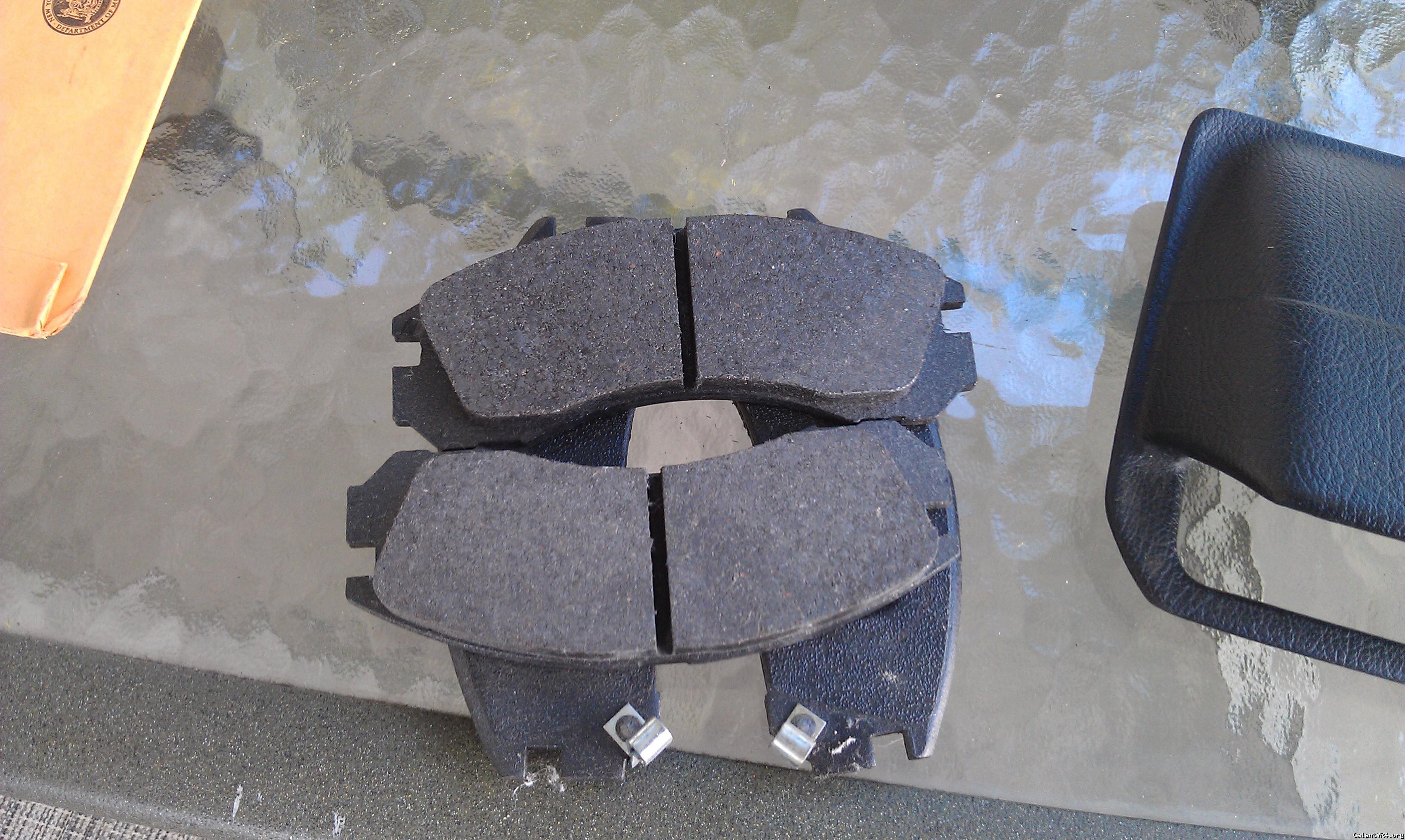

I just test fitted these /ubbthreads/images/graemlins/smile.gif, and there is no way of fitting 3000GT VR4 calipers behind them /ubbthreads/images/graemlins/frown.gif.
