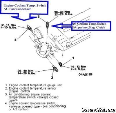

and to clarify, since your temp gauge stopped working, you are looking for sensor number 1 on the above.
I'd check if it's connected/if the wire broke. I had a few miles on my car before all those wires fell apart from vibration and being so old.
