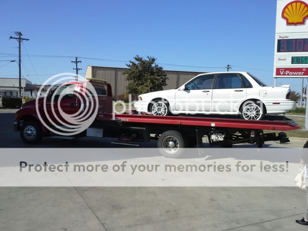

I've recently been fully depending on the Gvr4 to go work, grocery store, and trips. Well, just earlier this year, I had replaced the 22 spline output shaft and tcase with a 23 spline output shaft and tcase. I was heading to pick up a b16g and visit the folks at FP. I'm working on getting an old school FP red to have under the tree. I broke down about a mile from FP, in the middle of a busy highway intersection. 53 three miles away from home. It just locked up. I was afraid of the galant being wrecked. Luckily, the folks out in Mckinney are very friendly, unlike Arlington. I did some searching and found that 92+ 23 spline will fit the galant. I want just verification that the info I received is correct.

On a side note...I'm diggin the price of gas in Texas!

3.35 for 93

You lucky mofo!! the cheapest we have out here is 3.65 for crappy 87 Oct and that’s kind of cheap from what it was before.
