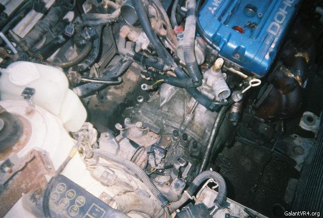

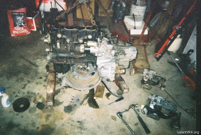

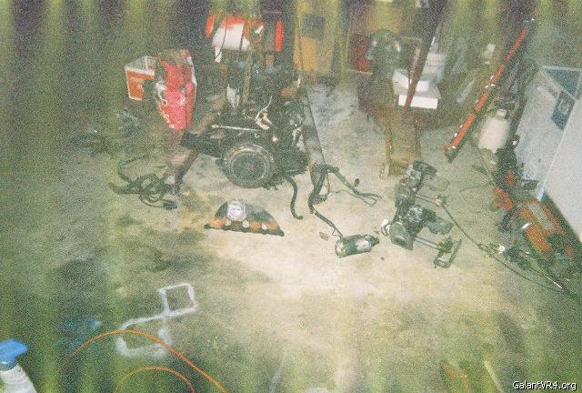

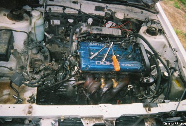

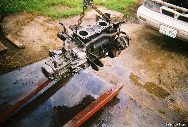

New update: I got the engine/tranny in last night. It's been slow going, since it's been too hot to get motivated to work on it. All I have left is to hook everything up, run the intake and exhaust, and turn the key (oh, and pray).
FYI: I measured the diameter of the FWD shaft where it fits into the tranny, and the AWD shaft at the same place. They are the same diameter, so there should be no fitment problems there.

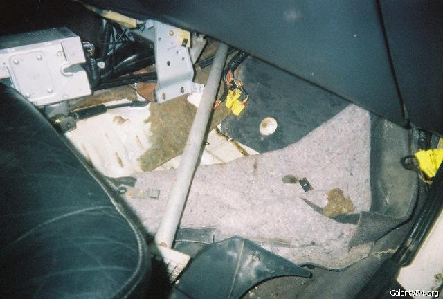

To get the AUTO shift cable out, you have to drop the exhaust, drop the heat shield and take out three bolts. Easy.
The motor mounts on the engine are interchangeable. The ones in the car don't look to be, due to the fwd only having one crossmember. Also, the AWD tranny mount, will not fit a FWD tranny. Wish I would have known that when I got the tranny, so I could pull the mount then.

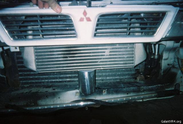

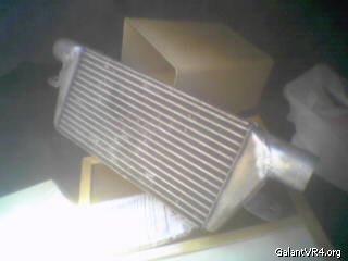

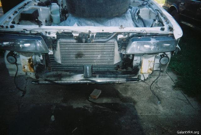

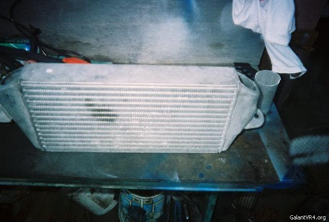

Got my starion I/C yesterday, and started fabbing it up. It's gonna fit in front of the condenser perfect, and I'll be able to keep the stock GS bumper (sleeeeeeper). Piping should be easy, and shouldn't take long. I'm working on getting a bigger o2 housing, so I can do the exhaust. I still need to get the pix up.

Here's how the Starion I/C should have been made:
Went from stock, which is 1 7/8" IIRC, to 2 1/2" now. That oughta flow a little better. Once it's all up-and-running, I'll probably get a bigger I/C, but this will work for now.

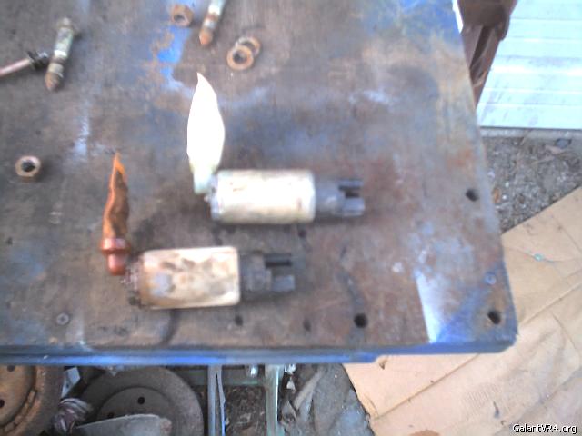

Ok, I took the stock fuel pump out of my gs since I've been told it is smaller than the vr4 pump. hmmmmm
Looks the same to me, even has the same part number. It needed replaced due to the nastiness, but apparently it's no different. ALSO: Gs has disk back brakes, don't know how different they are than the vr4, but it may be worth looking into.
Try not to make the outlets on the IC straight across. Staggered or at least in the middle is better. Otherwise you don't get the full use of all the rows.

I also got a hob-cobbled intake with all the stock stuff from Hertz, so I can get it running (It's got a 90 T/B, so it doesn't all work perfect). I want to try to get it as close to a stock vr4 as possible to get it up and going, then upgrade. Plus, the stock vr4 I/C fits the GS with no issues at all, and will fit behind the stock gs bumper. I am wondering about the MAS, as the vr4 and gs sensors are different. I seem to remember something about having to add wires for it, but need some knowledgable assistance. It's just got to be temp to get it running, as I have a maf for it that will be going on with the bigger I/C.

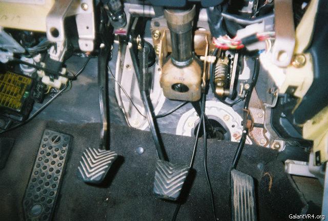

Ok, after driving it a day, I'm learning the quirks of it. Tranny is out of a 91-92 manual galant N/A, using my stock vr4 clutch. Shifts like buda. /ubbthreads/images/graemlins/grin.gif Never even had to adjust anything, just put the tranny, shifter, cables all in, and it worked great. It has pretty bad idle surge and tries to stall at lights though. I'm gonna adjust the biss, but I'm getting error code 25 (baro). Think my mas is wired up wrong, or the mas is bad? It also backfires and cuts out when accelerating hard, which may actually be due to fuel cut, since it's hitting upwards of 15psi of boost. When I looked, inj were at 100%, along with the three things right above/below it. They are the vr4 stockers with the resistor mod.
