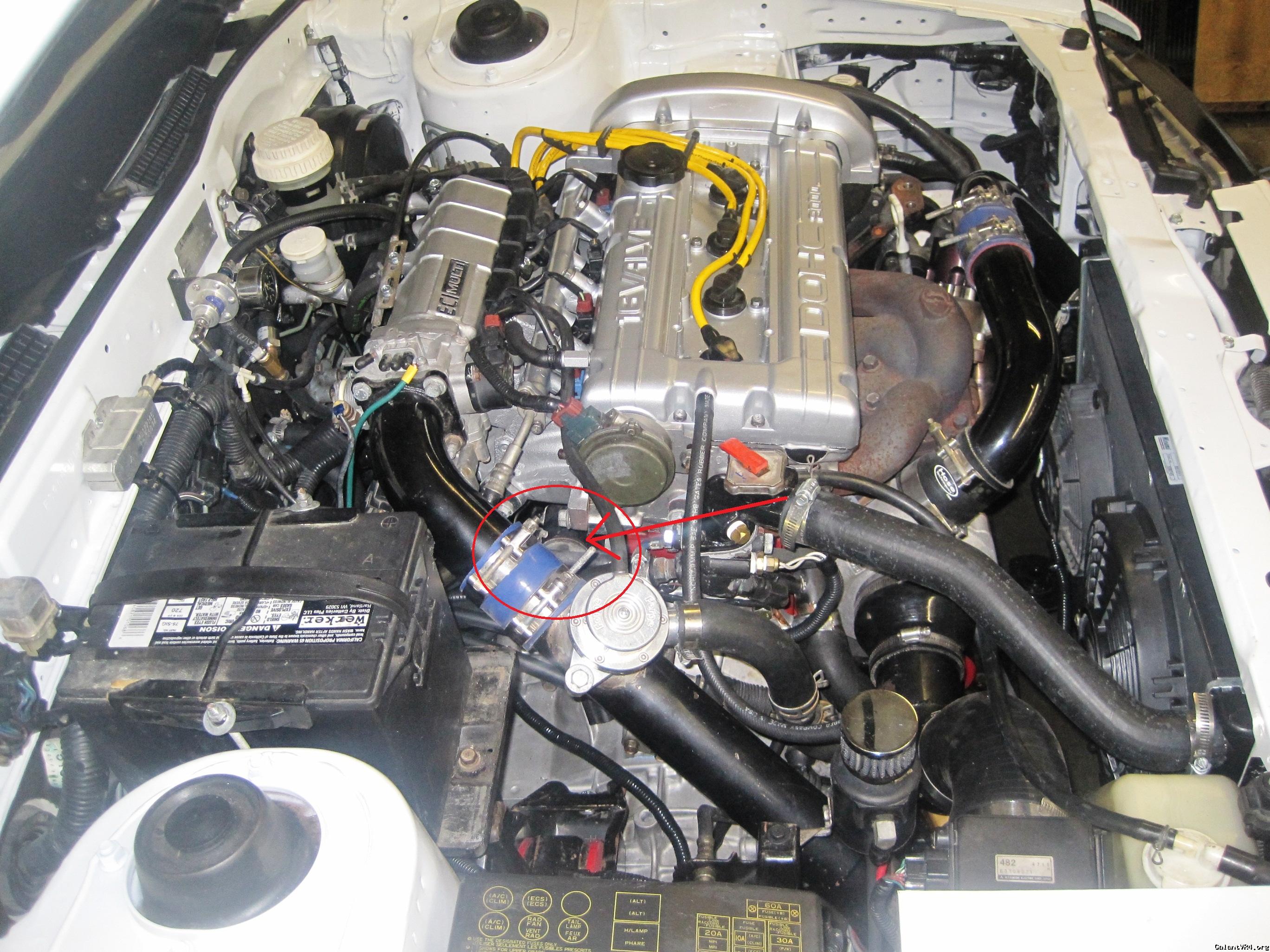

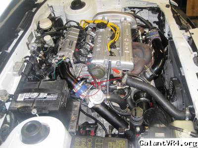

Stand at the passenger side fender wheel well and face the motor. Reach under the intake manifold and place your hand at about 11 o-clock on the tranny bell housing. You will see a semi-round hump and 2 bolt heads. That is the cone of the starter under that hump. The starter is behind it.
The red circle and arrow are pointing to the solenoid on top of the starter.
