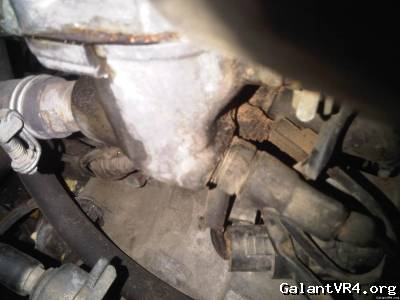

Just bumping to add a little more confidence to future searches. CLT used by ECU to adjust fuel trims is, in fact, located lower front of thermostat housing. Here's a picture for future reference. CLT is the big, fattie closest to the camera with the boot on the connector. Big, dark object in top right of picture is upper radiator hose. Picture taken between upper radiator hose and battery.
Hope this helps someone in the future.
