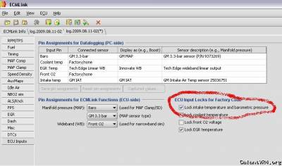

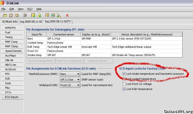

For those with ECMLink SD, is your IAT sensor actually working? Mine is stuck at 77* for no apparent reason.
Is your sensor hooked to the IAT wire that originally went to the ECU? I am using the ECmlink native GM MAFS cable for the harness and mine works ok. That sensor needs a buffer to work properly and can only be attached to the original ECU temp wire.
That is the Locked value that would be going to the ECU. This value is locked as soon as you select SD of the mafcomp page. You need to set up the GM IAT on the logged values page to see the GM sensor in the logs.You also have to configure the ECU so that it uses the GM sensor to run on. This is on the intake sensors page My factory IAT value on the log is also 77.
