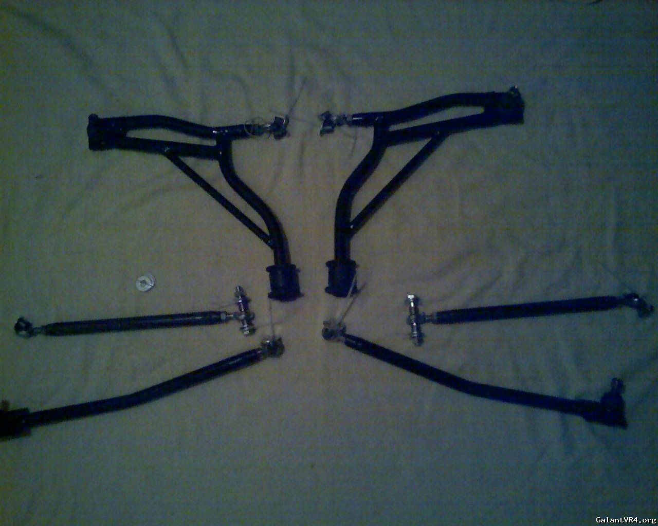

Control arms for the front need nothing and come complete with bushings, new ball joint(factory style so replaceable) and high quality rod end.
The rears use different hardware, included of course.
Sway bar mounts are available for front.

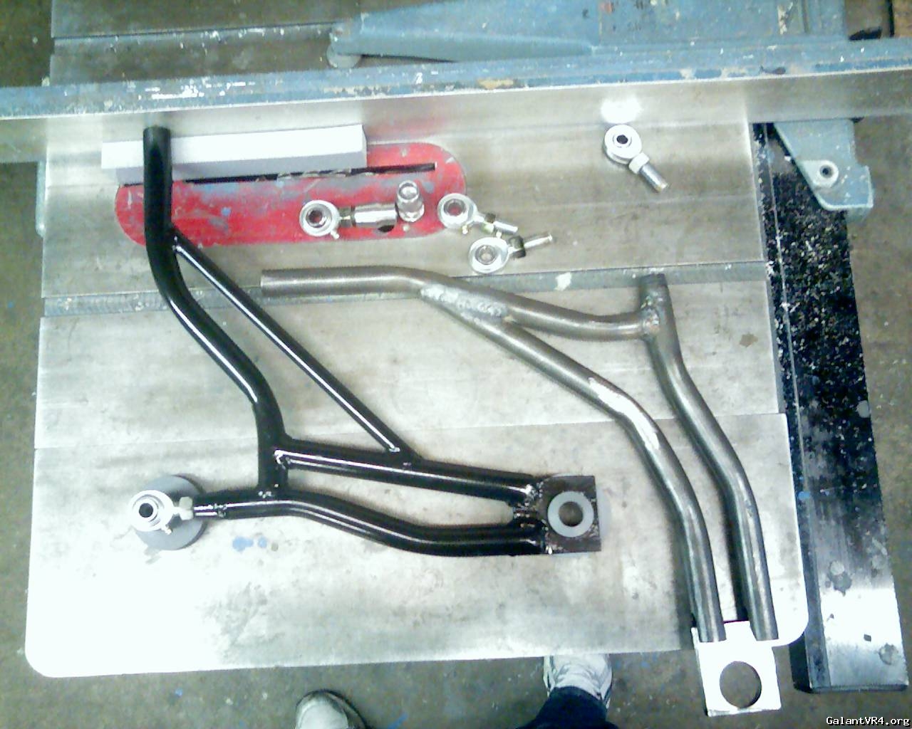

There are 2 different arms for the front and rear lowers. The fronts are avaiable in a double adjustable and single(to obtain caster, use a Whiteline bushing). I have a drag only arm and a street/road race version. The rear lower has 2 different designs, one for no sway bar use and one factory style adjustable with mount for sway bar links. Again, all hardware, bushings, spacers,etc. are included.
Also I have the camber arms for the rear available, adjustable with all new hardware, less than the Ingalls since they are pretty simple to build!

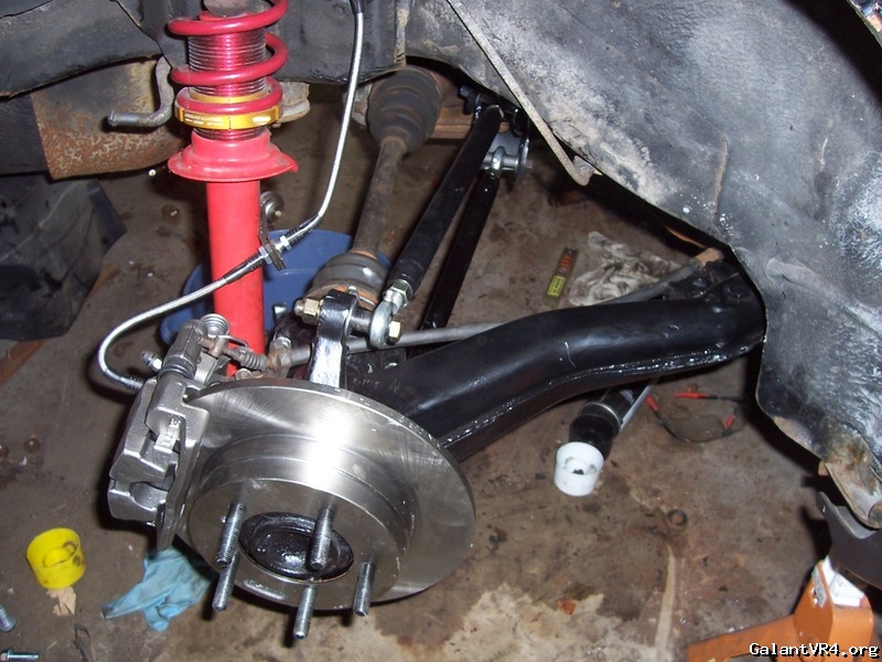

I will frequent the board more. I dug up a pic of my drag arm for a customer so you can get an idea. The other arm was one of my r&d pieces tested and beat to hell.(street version). Pm me or give me a call to discuss your needs!-Jason
I will take some much better quality pics tomorrow. This particular set is for a drag application with no sway bar provisions. Brackets are avaiable for the front and the rear lower is a different design.
The kit shown above packaged, boxed and on its way is 24 lbs. minus the packaging it is 22.8 lbs. If I remember correctly the stock arms together are close to 40 lbs.
The rear lower arm set is 2 lbs heavier if using a sway bar. Hope this helps answer your question!

It does, thanks! So total weight savings about 15 lbs. of unsprung weight on the rear suspension arms. That's like having lost the mass of an entire wheel (albeit a light wheel). That's definitely significant. If they fit well and are as strong as the stockers... it's a great addition to the possible upgrades for these cars.
