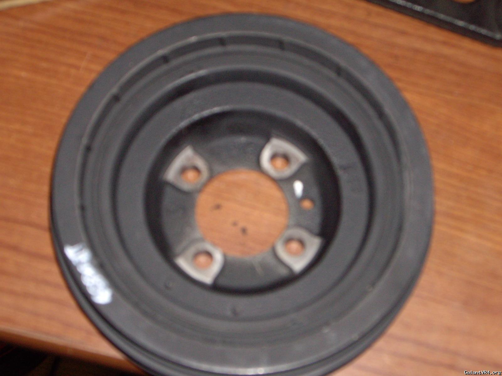

Good crankshaft pulley

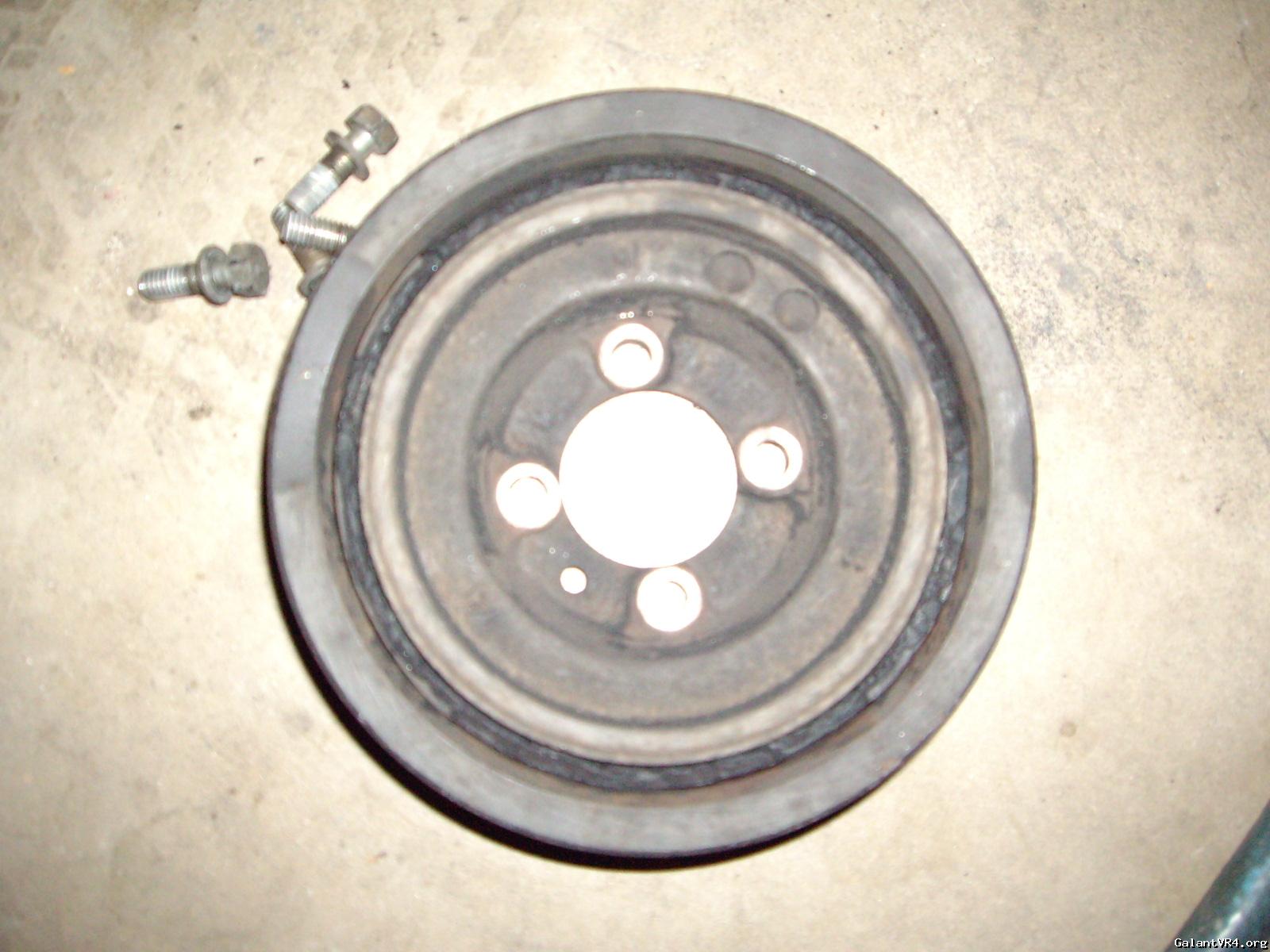

Bad crankshaft pulley (click for high res to see how disintegrated the rubber got)

I need to replace the bearing in the AC's tensioner pulley, but otherwise, it's just a matter of reassembly. As you can tell from the pics, there is zero doubt that the crankshaft pulley was the culprit. I was able to wiggle it while it was still bolted to the crankshaft, so it's no wonder the belt got kicked off.
