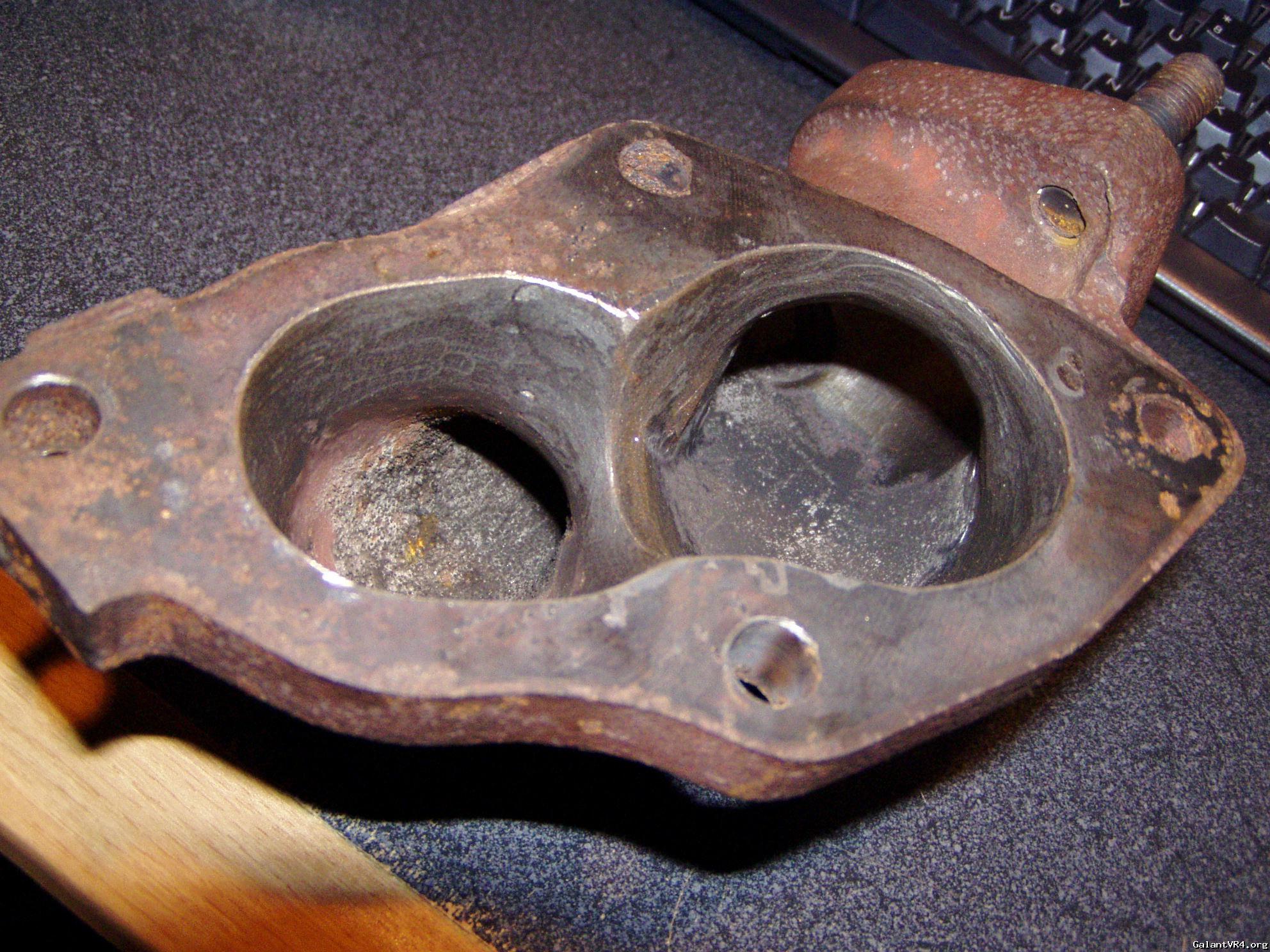

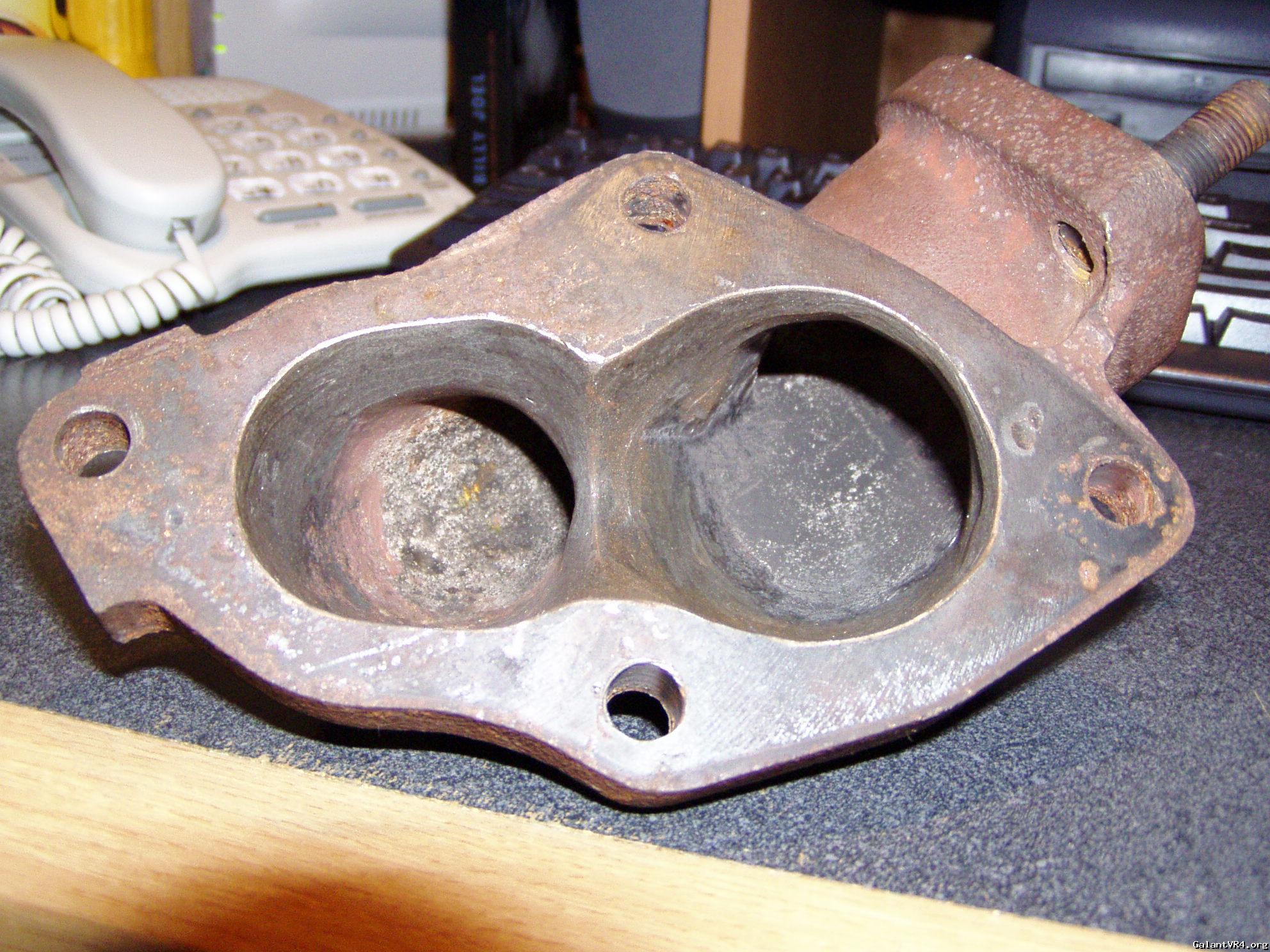

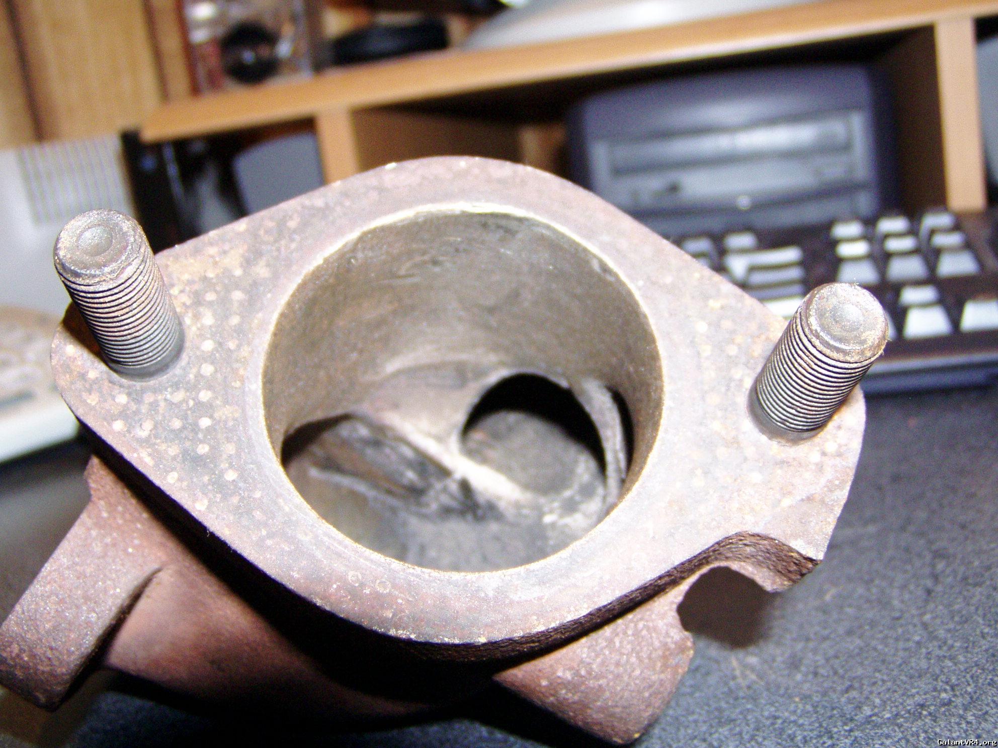

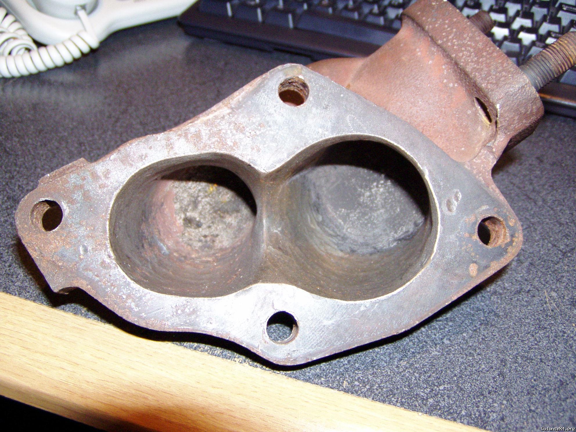

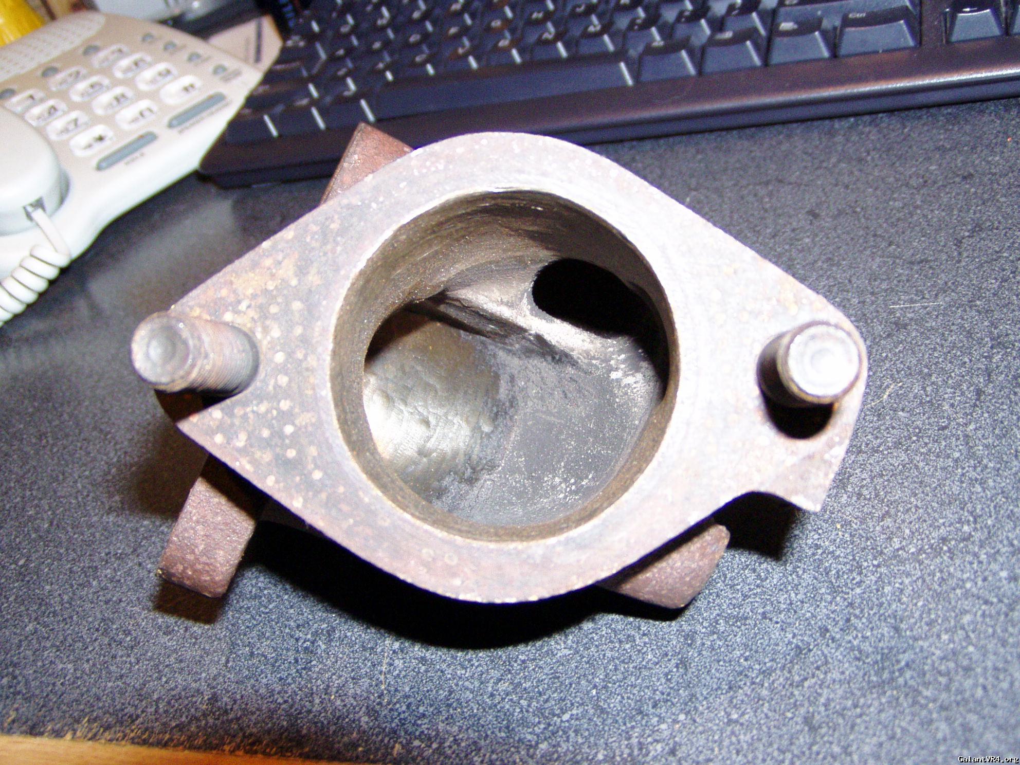

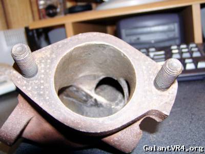

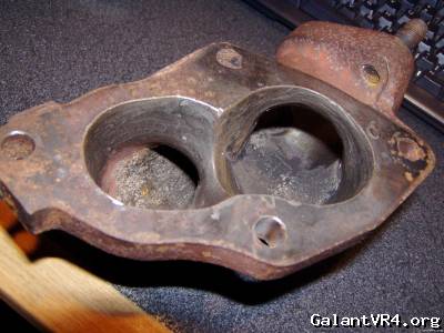

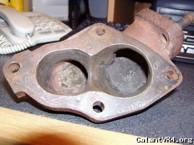

Take the stock 2G housing and port the hell out of it. Concentrate on the waste-gate side and how the gases re-join. If you can, get a down pipe that is at least 2.5" at the flange and goes to 3" really quickly.
Something like this. On my Evo III turbo, I saw full 22psi pressure at 3000rpm and it hit like a ton of bricks. It would pull super hard all the way to 6800. (Once over 6500, stock cams start to give up though)
