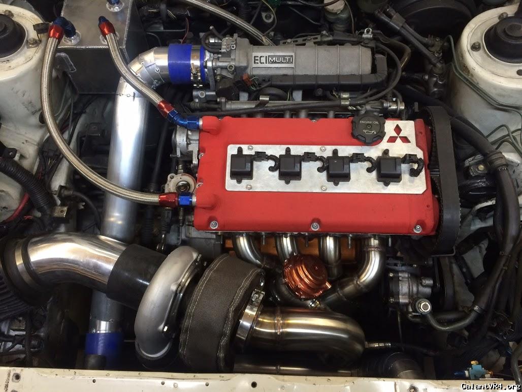

Lookin really good! Car has definitely come a long ways and its nice to see a DIY'er with some skills. It looks like the car didnt come with AC? Was trying to see how the intercooler and everything all fit in. I have to ask, why no twin scroll on the mani though?
Mdlimy
Apr 30, 2015
111
Gresham, oregon
Thanks man, im happy with the progress lately!
It did have a/c but I ripped it out, only a couple months of hot weather a year and I dont like driving it in that heat anyways.

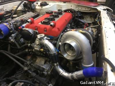

I got a smoking deal on this great condition garrett 35r for $500 bucks and its single scroll, I would have loved to do twin scroll, next time for sure.

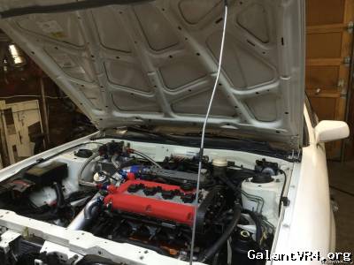

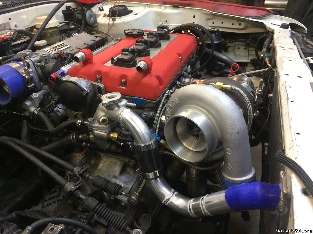

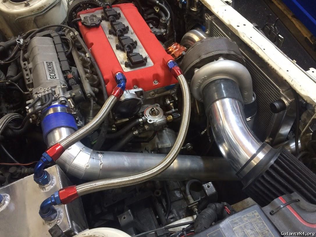

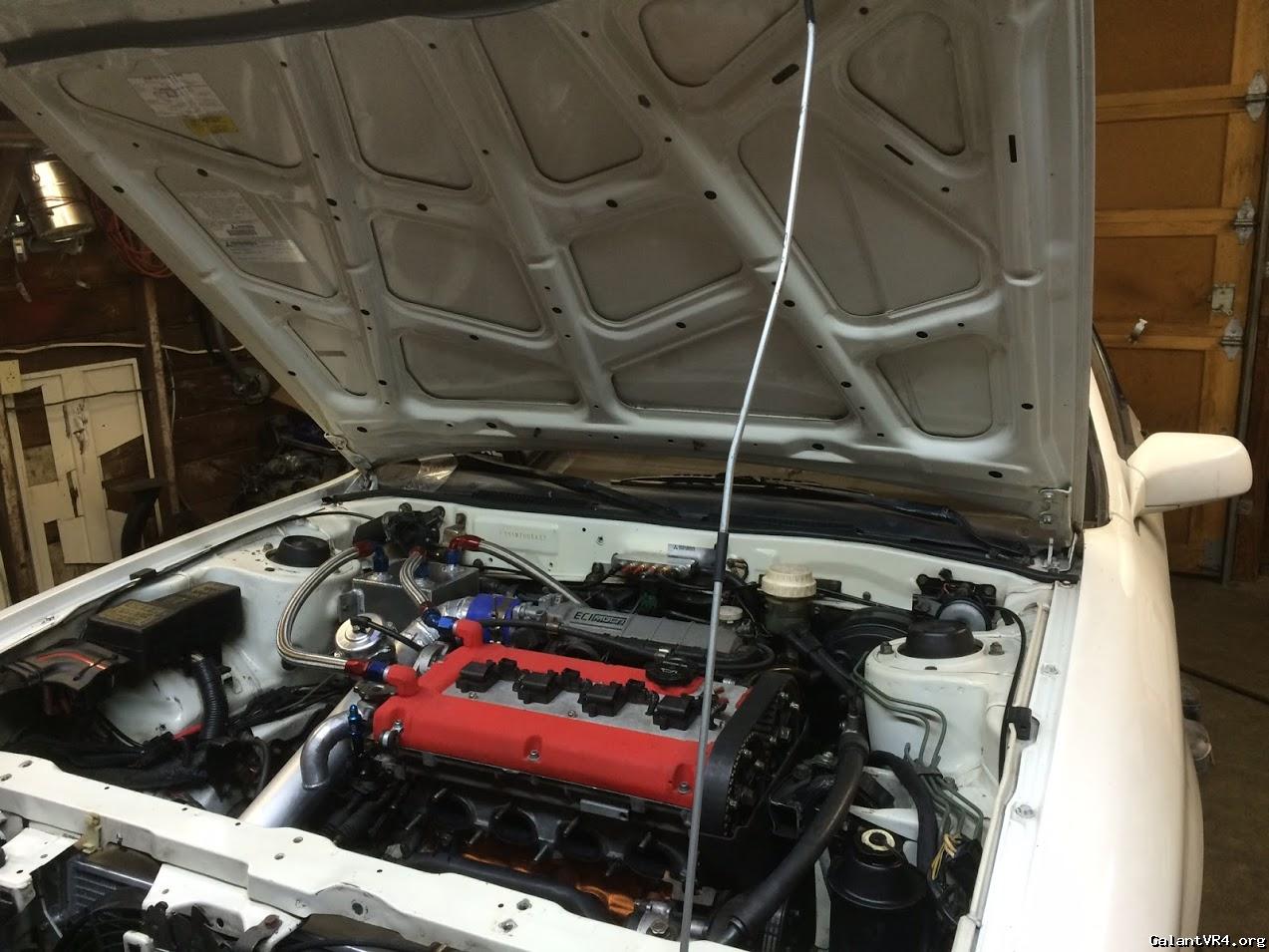

Decided to go 3" intercooler piping...Cut off the 2.5" in/out on the fmic and welded on 3". Redid all the piping, somewhat short route now. Somehow managed to fit 3" on the stock TB flange, lots of porting to make it smooth and work but atleast I have 3" all the way to the manifold for when I build an Intake with a 3" tb.

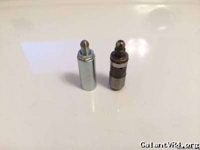

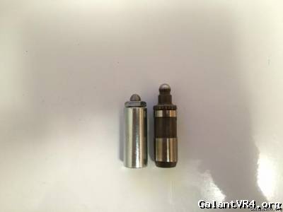

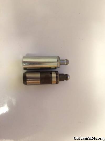

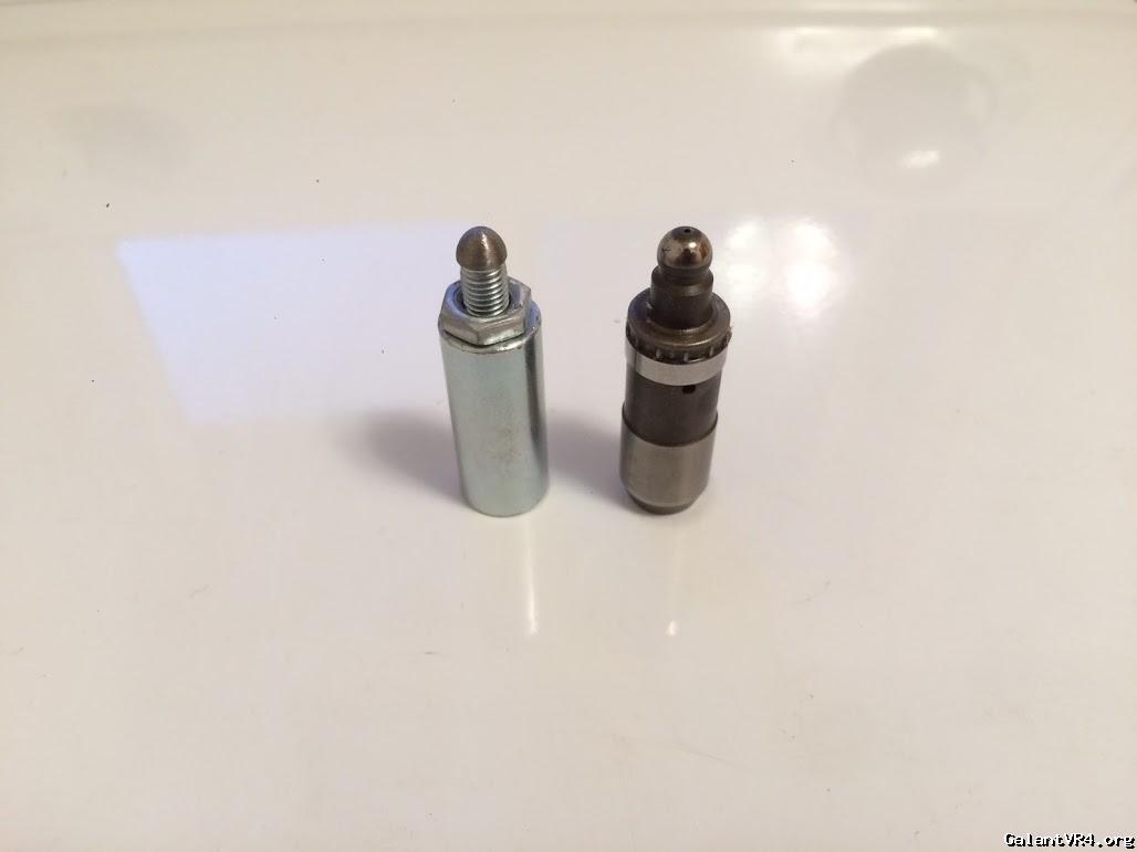

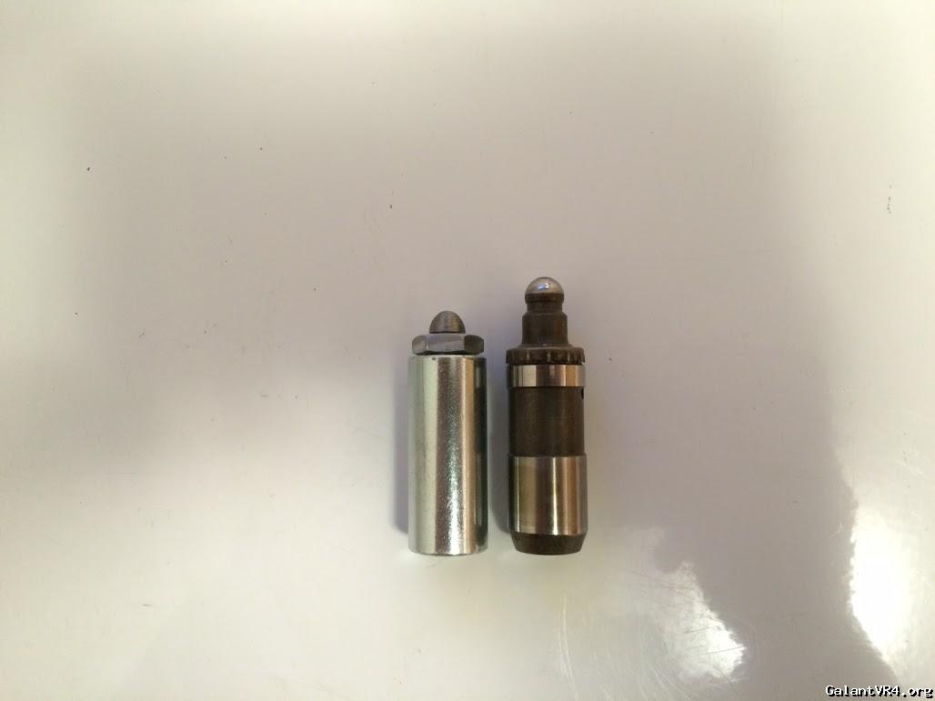

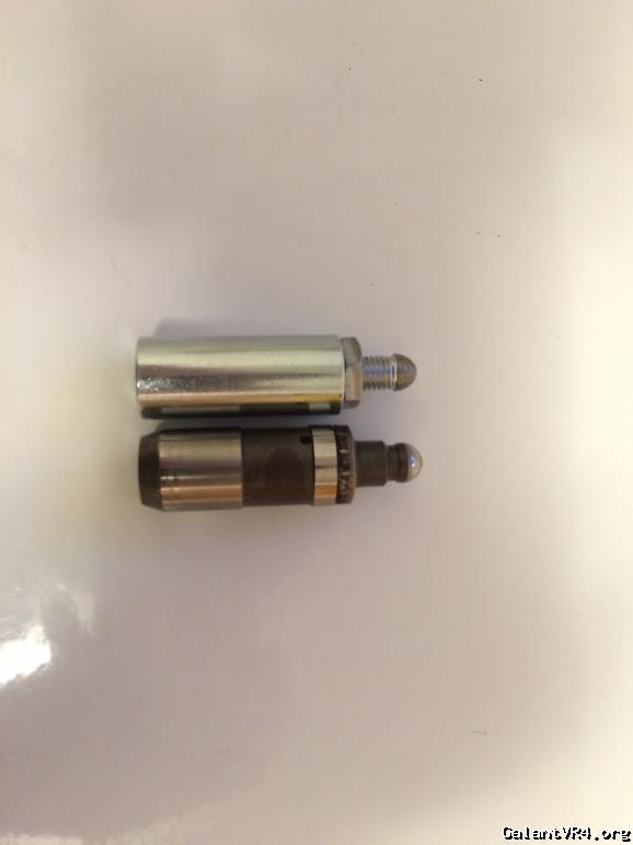

Also made a couple solid adjustable lifters for degreeing the camshafts. I think I will be selling these in pairs for anyone that needs them for degreeing.

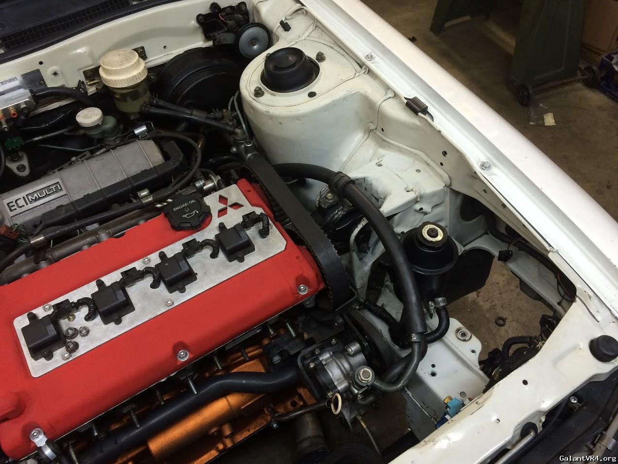

Not a whole lot new, been tying up lots of the little things. Still waiting on the shop to finish my stainless lines /ubbthreads/images/graemlins/mad.gif

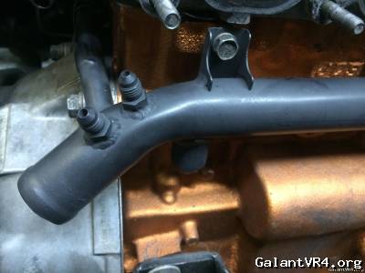

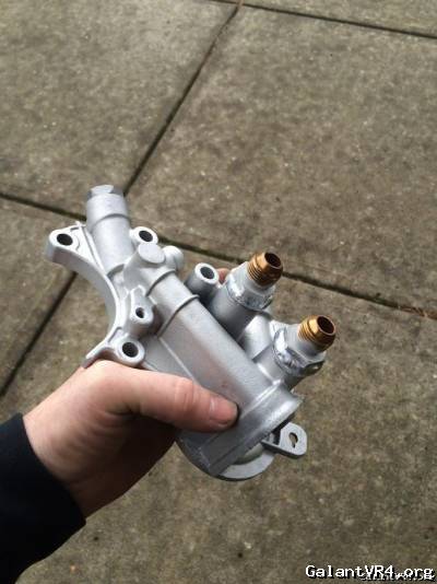

Did a little cleaning in the bay, acetone worked well to remove the nasty cosmoline. Cant wait to ditch the abs and build a new engine harness!

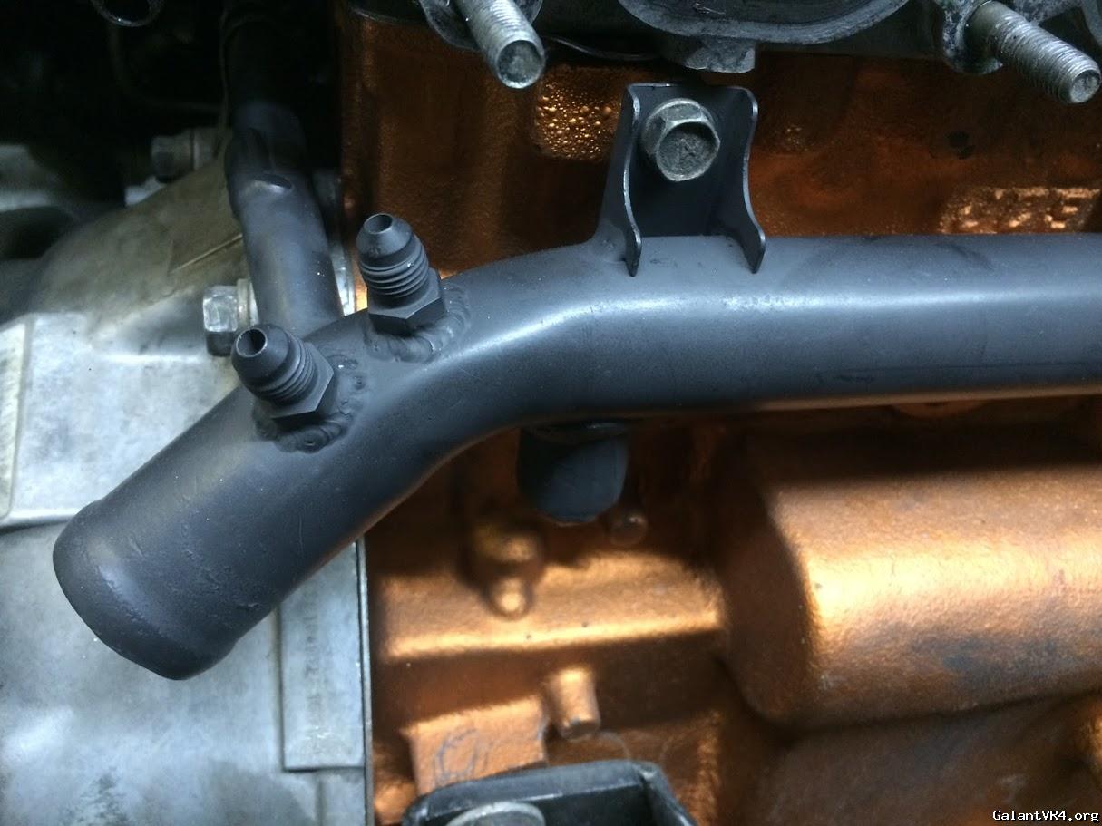

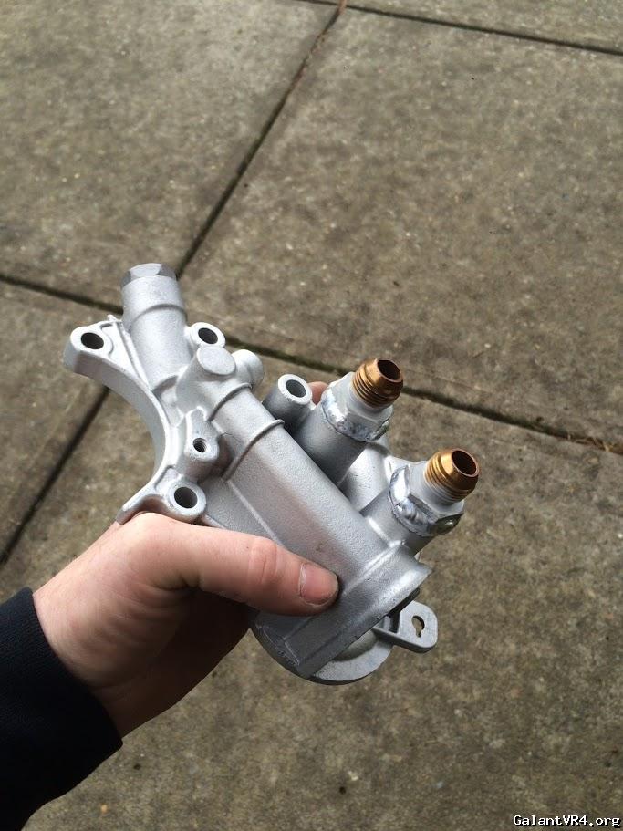

One -4an for the turbo coolant and the other for wastegate coolant. The other two -4an fittings are on the Tstat housing.

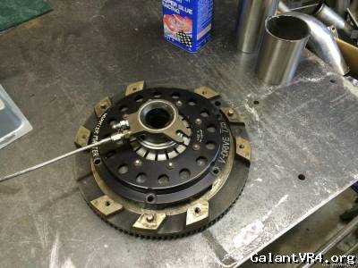

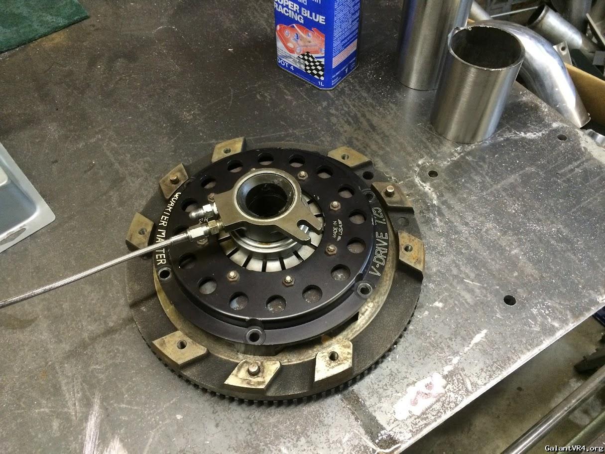

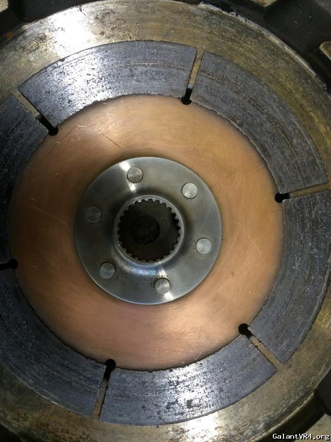

My used nascar quartermaster 7.25" twin disc arrived, along with a hydraulic throwout bearing. So I can now get started on my budget twin disc setup. New 7/8"-20spline discs should arrive soon.

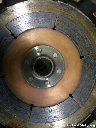

My plan is to machine the flywheel to accept this pressure plate, which wont be hard but I am now noticing that the friction discs dont make full contact towards the center of the flywheel. In hopes of not having to buy a $400 flywheel, I have a solution, Ill update when that ball gets rolling.
The used twin disc cost me $300 to my door, all the plates measure within spec, the disc have to be replaced since they are the wrong spline size/count, a pair of new discs cost me $150. The hydraulic throw out bearing cost me $80.
I am hoping to have a full twin disc and hydraulic throw out bearing setup working with brand new discs for under $700.

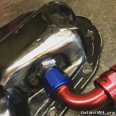

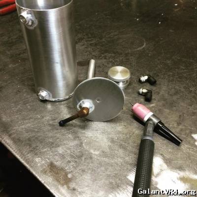

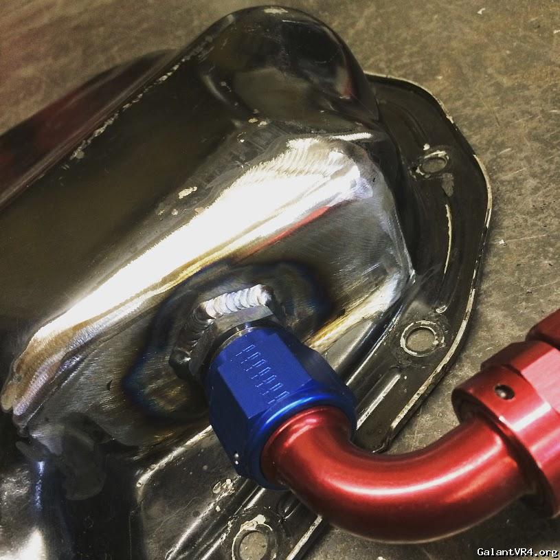

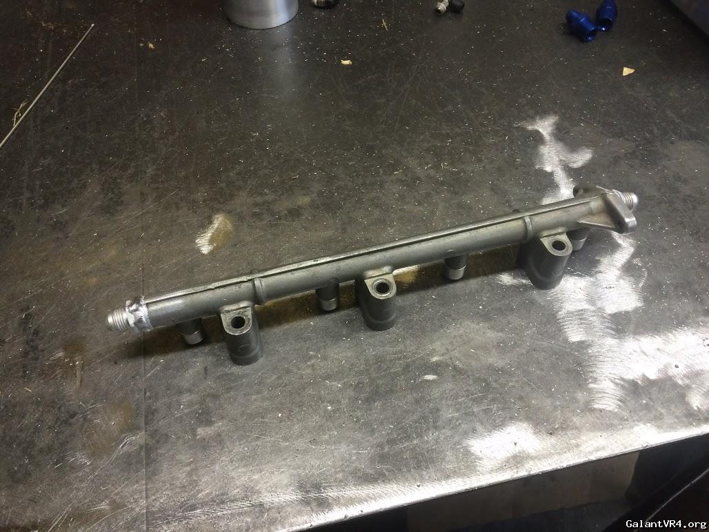

No more pesky leaky flange/bolt holes /ubbthreads/images/graemlins/cool.gif
We getting ready for some ethanol!

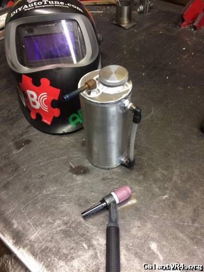

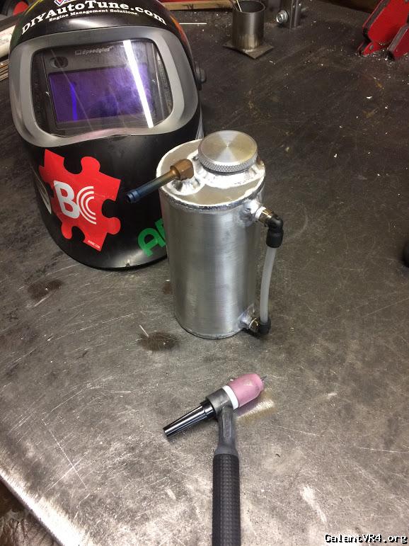

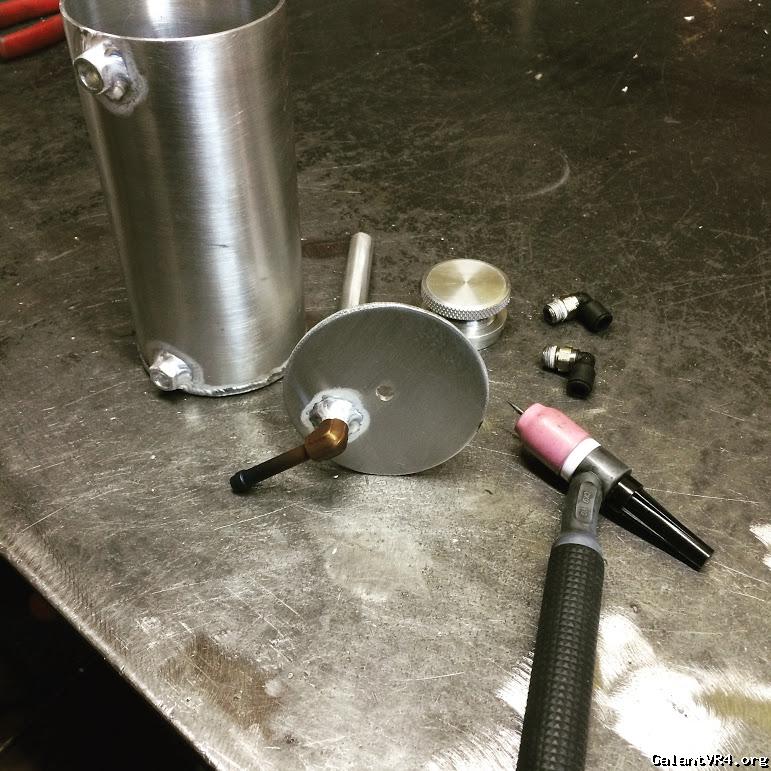

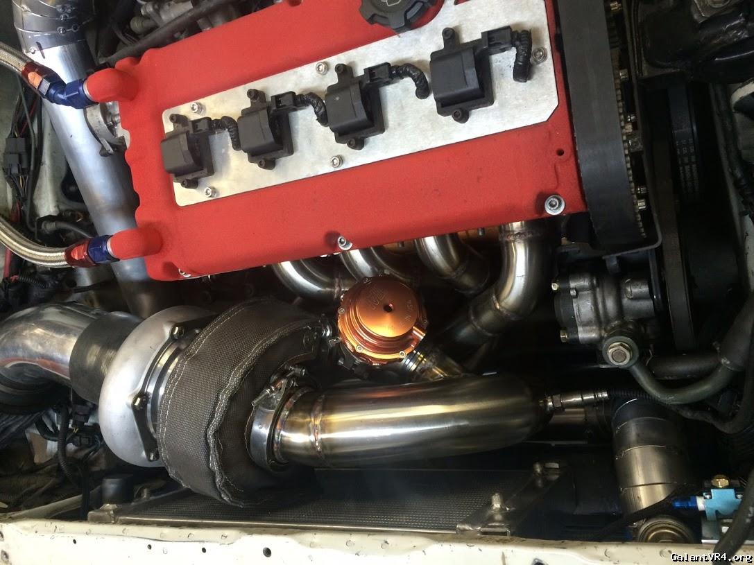

Made a coolant overflow, should have stripped all the anodize off the fitting /ubbthreads/images/graemlins/frown.gif

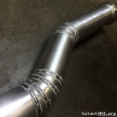

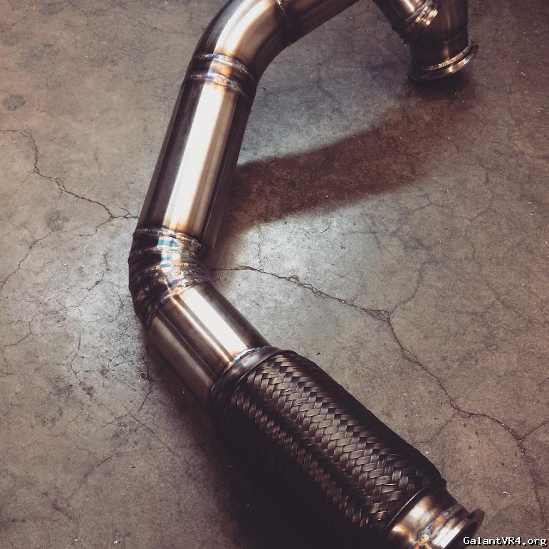

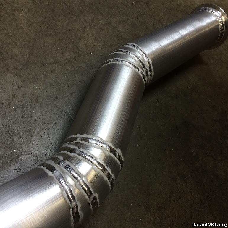

Finished the downpipe and got started on the aluminum exhaust /ubbthreads/images/graemlins/devil.gif
