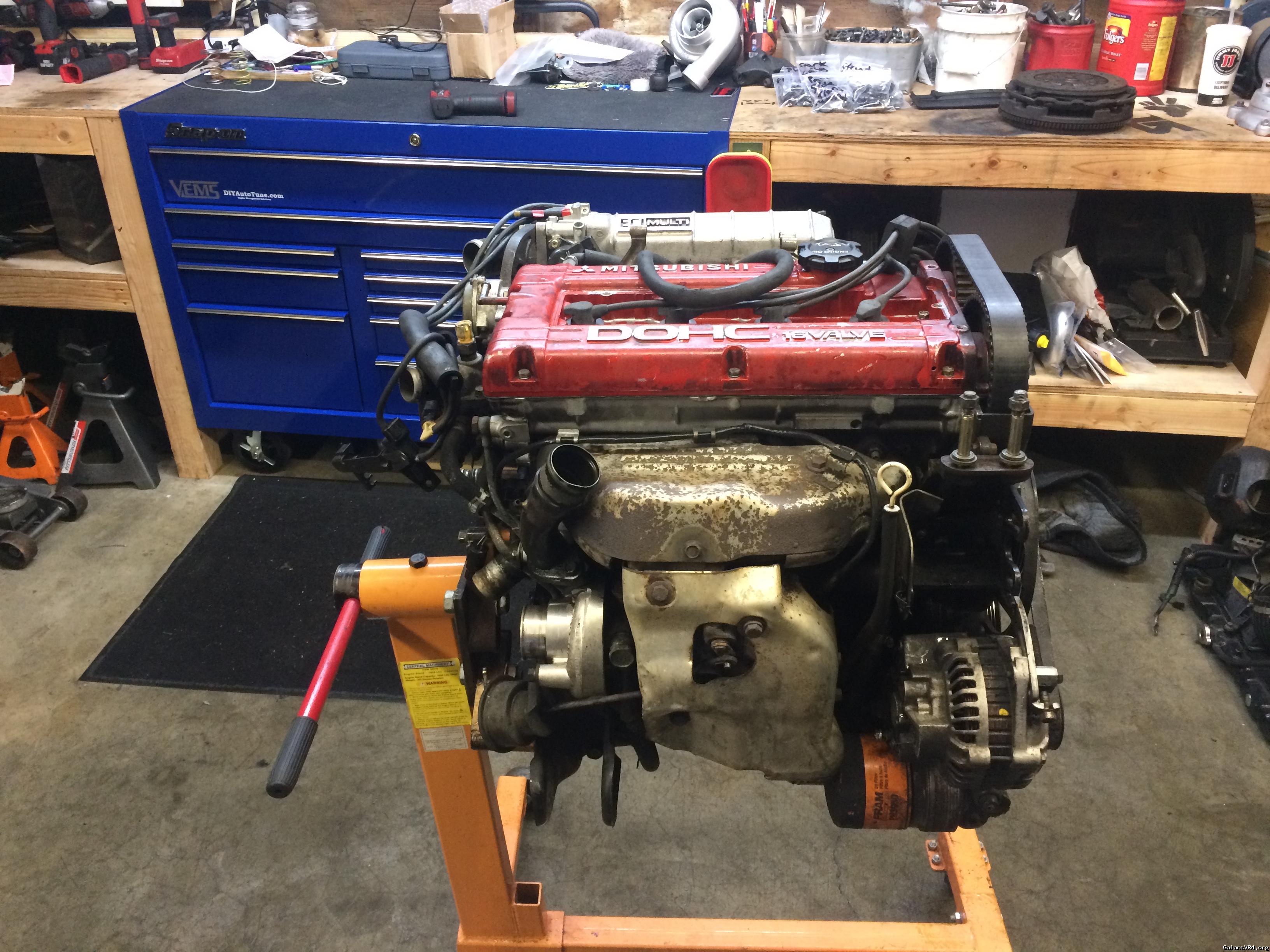

I am going to pull the motor tonight and start stripping it for disassembly.

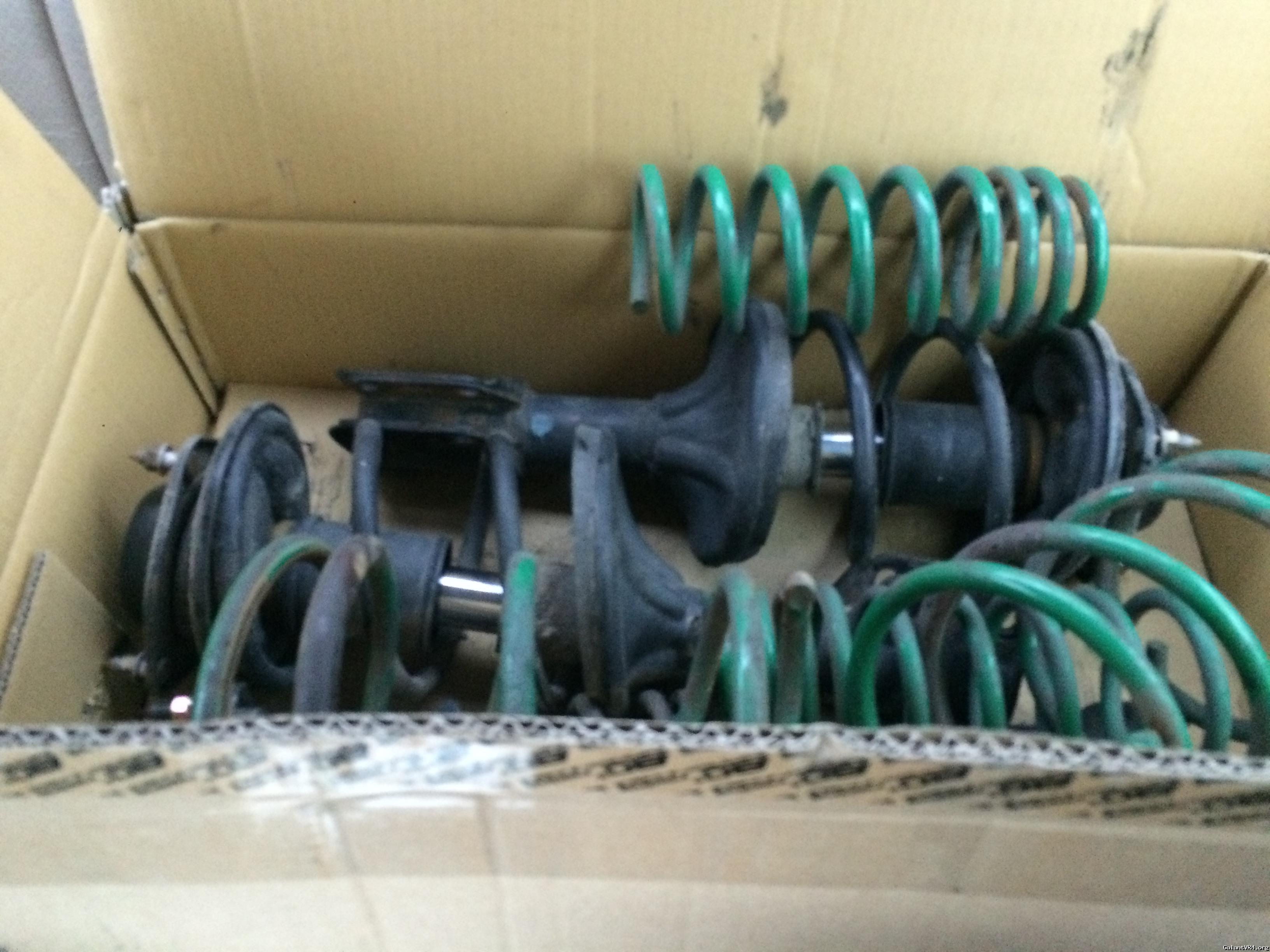

Picked up some stock evo 8 suspension and tein springs for 240 bucks, that should hold me over until im ready for coilovers.

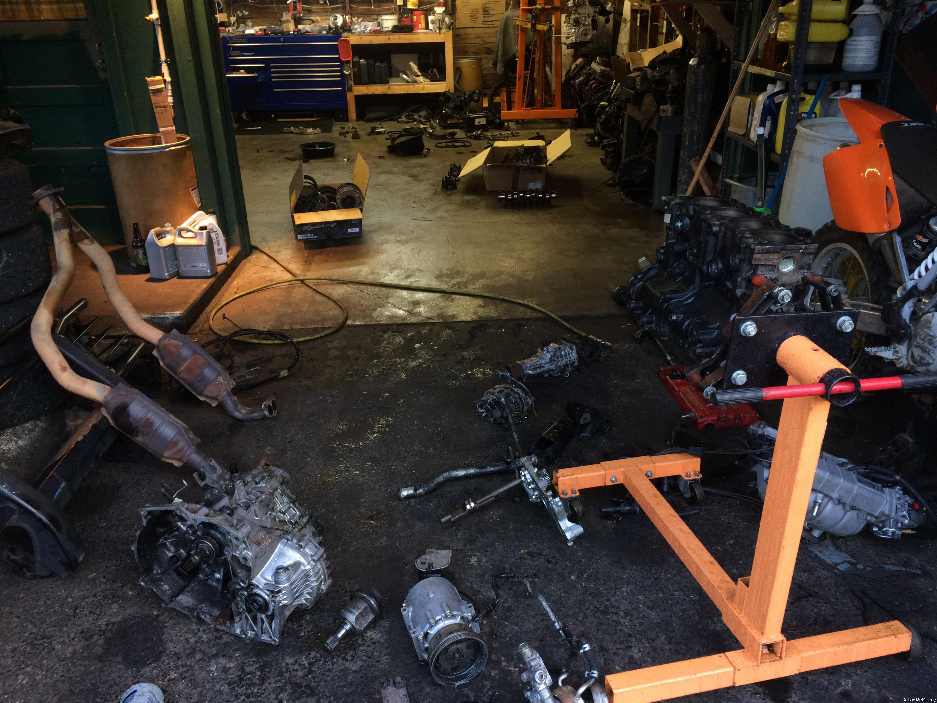

The motor came out tonight, not going to tear it down until I pressure wash it, I will do that tomorrow after work, then disassemble and inspect.

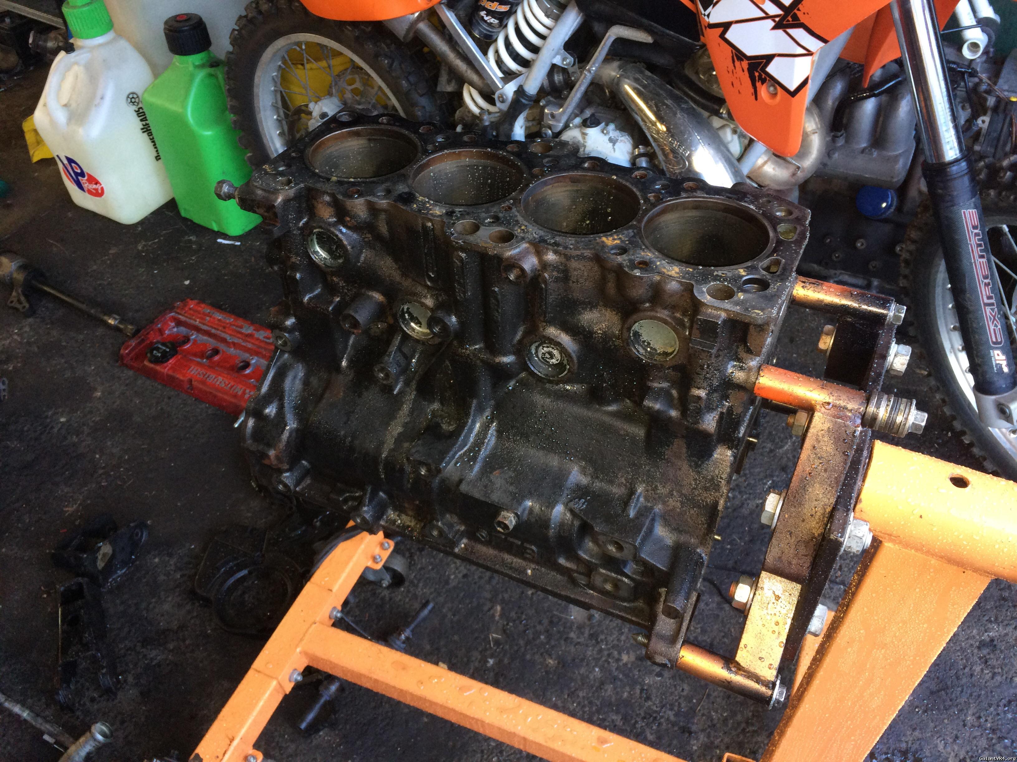

Well the garage is a disaster, but the motor is torn down. Cylinders look good, rod and main bearings not so much. Head has atleast 2bent valves, possibly more. Pistons arrive tommorow, I will drop the block and head off at the machine shop on Friday.
