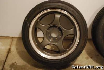

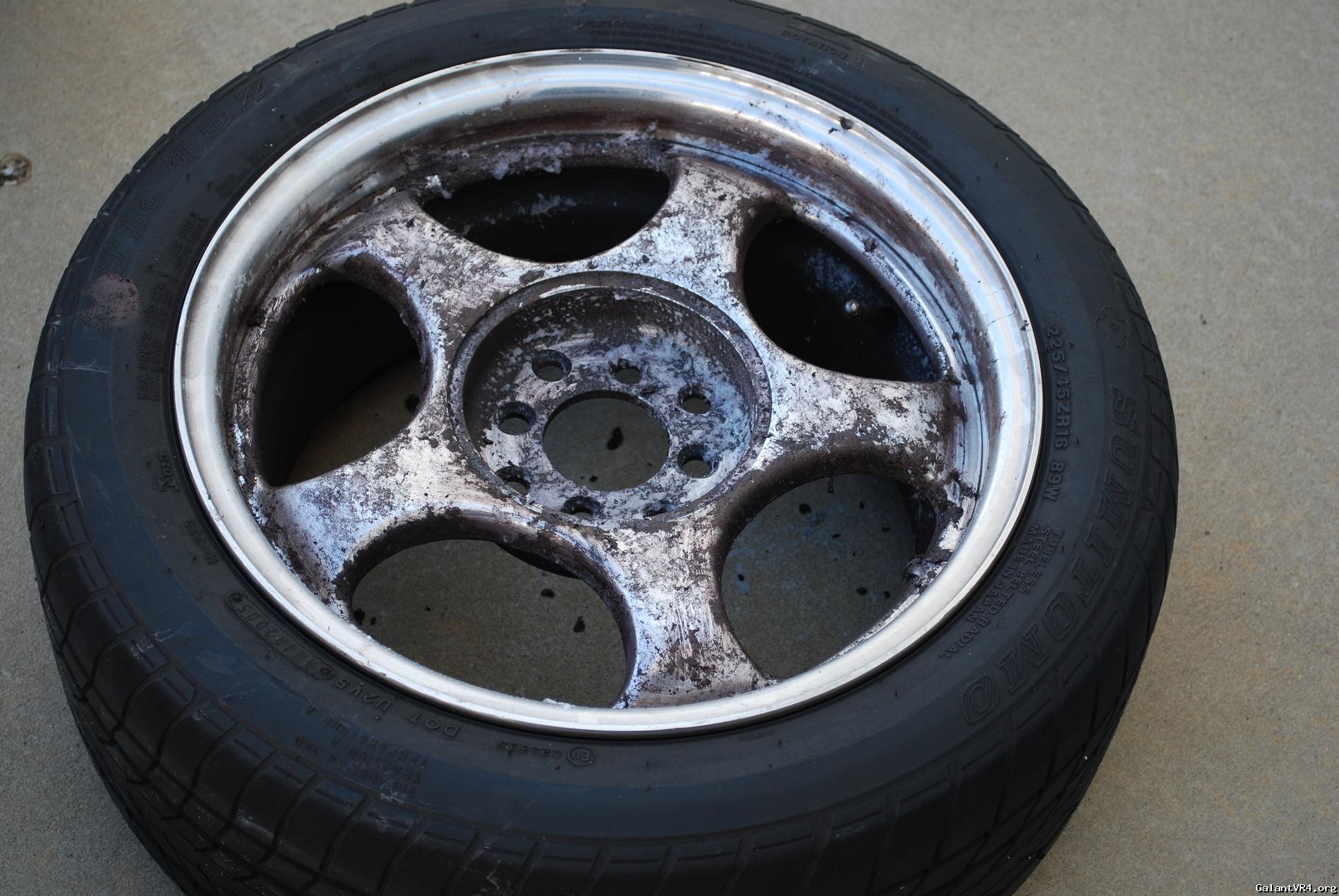

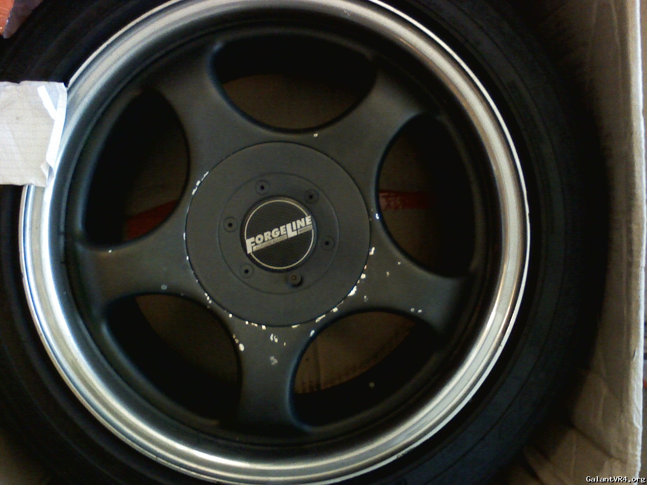

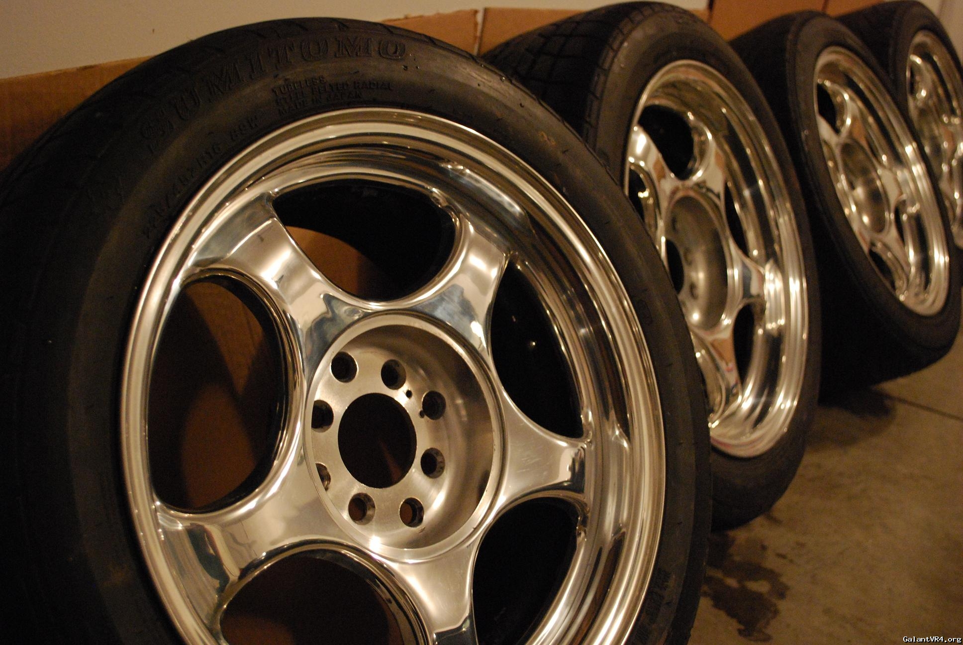

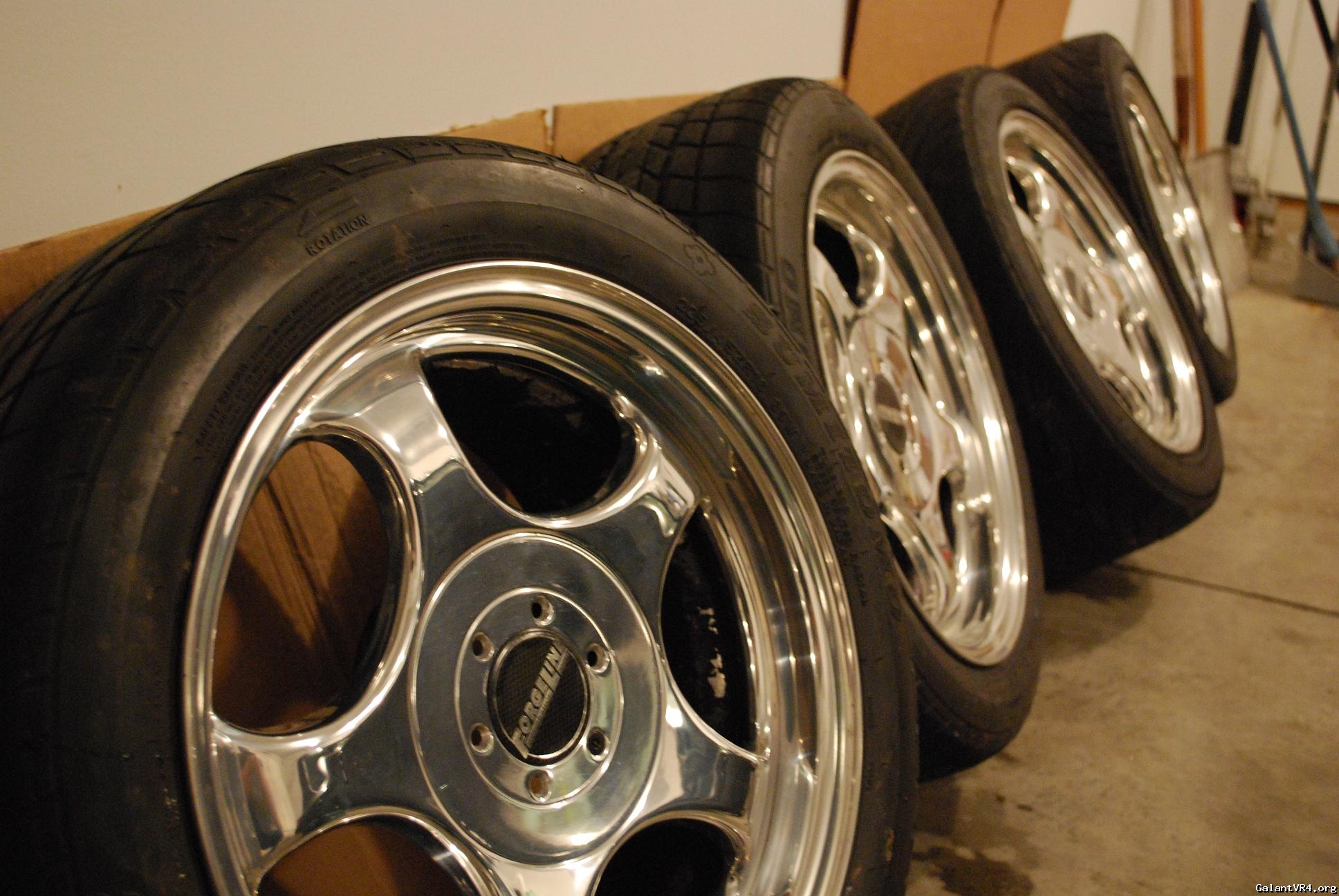

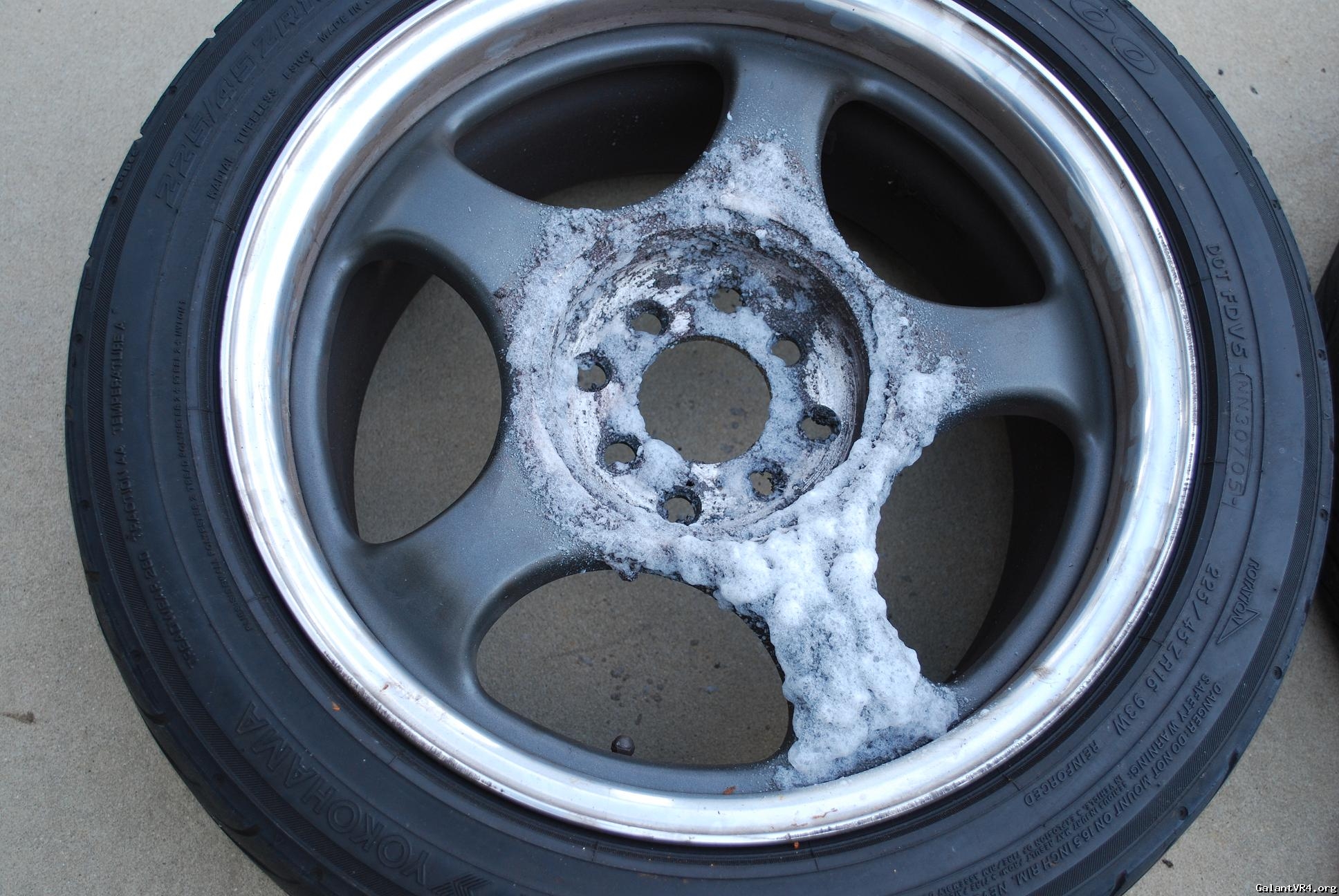

I recently picked up some wheels locally from rez earlier this week and decided to restore them to their original condition. I used aircraft paint stripper, a ton of elbow grease, and finished it up with Mothers polish and power ball. I still have more work to do to finish cleaning the back of the wheel. After that I'll send the wheels to the painter to get them clear coated. Here are some before and after pics:

Did you use spray stripper?
The pour liquid in the can works wwwwway better FYI..
Anyways, the wheels look awesome. What did you use to polish them?

Yeah I used the spray can version. I will use the liquid version next time around. These wheels had 2 color coats to remove. Surprisingly the bare metal underneath was still in very good shape. All I used to bring the shine back was use some Mothers mag/alum wheel polish and their power ball.

I just picked up a jug of the canned aircraft stripper. I plan on doing my 2g rims sometime this week. Any tips on how to go about it? Did you just let the stripper do all the work or did you do any scrubbing as well? Also from what I heard this stuff is tough to the touch so did you just apply it while in the driveway and wash it away?

Scuff the paint really well with a red scotch brite so the stripper can really bite...Use duct tape anywhere you dont want it to eat
Pour it on like crazy..the thicker the better. Do not smear it around, try to get it in the place you want it with one swipe of your paint brush..
Just let it sit..We'v left wheels sit for a whole work day and its fine in the end.
if you need to, reapply it.
We strip hoods that are full of rock chips all the time..
water reverses it if you get it on yourself..scrape the paint/stripper into a bag, then rinse it with water

Pachood basically covered all of it. I let the stripper do most of the work. I let the solution sit on the wheel for at least 10 mins. and then I wiped it off with a towel. I found working in small sections kept the job easier. I focused on one spoke at a time.
The solution is pretty rough on the hands. I wore surgical gloves thru the whole process and I had to take a break a couple of times to wash my hands. The solution made my hands kinda red. I'd use thicker dishwasher gloves next time around.
