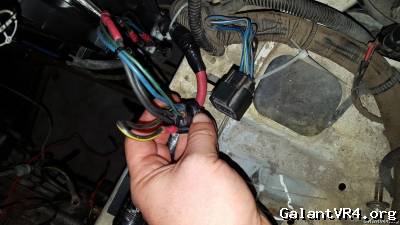

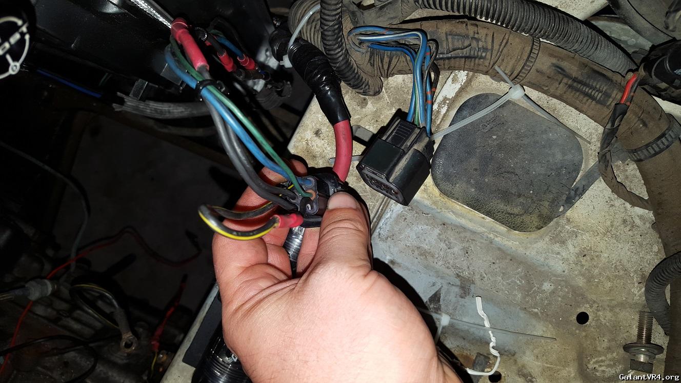

I have an issue with 570/1000. The PS fan is coming on whenever the battery is connected (key on or off, doesn't matter, or the storage disconnect active or inactive). The low speed circuit is utilized for the PS fan. I did not have an issue with it until I removed the fusible link box off the positive battery terminal. I moved the power seatbelts to an empty sub-fusible link spot that was unused, and the other was just a single 8 ga (ish) wire on a ring terminal going to the storage connector. The relays still function on/off as they should being triggered by the fan switch and A/C coolant temp switch. I removed EVERYTHING from the fuse box (relays, fuses and fusible links), disconnected the 2 grounds in the engine bay (2 and 4 as per the FSM), disconnected the A/C switch and temperature gauge sensor (thinking I may have mixed them up), and even tried hooking up the stock fan. The stock fan won't work on low-speed, works on high-speed, but also does not come on when only plugged in (possibly un-related?) It acts like a short, but I wanted to see if I could get some feedback on if I moved my wiring correctly, or if I'm causing a loop. The fan does not change speed when the low speed relay is energized. I checked the DS plug as well, and the same situation is occurring there as well.

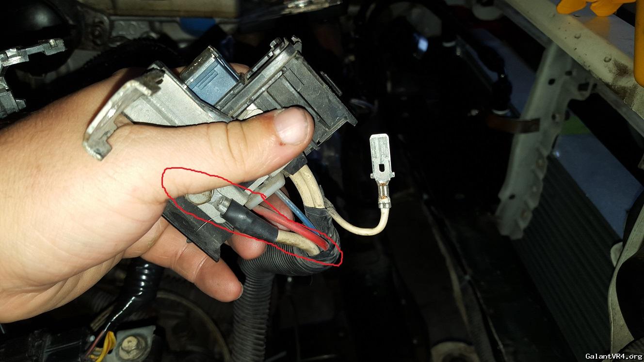

The wire circled in red is of suspicion (came from the 80(?) amp fusible link slot for ABS pump

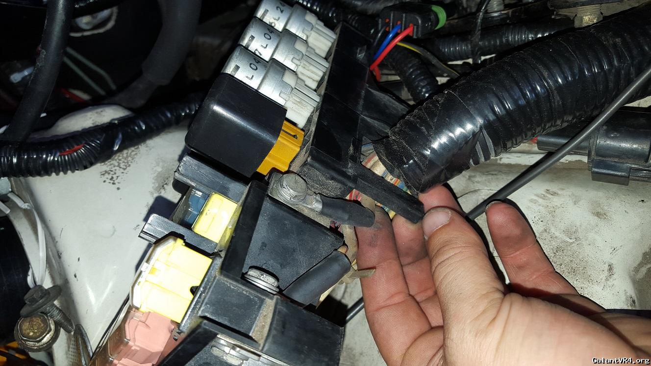

This is where I put it (I think). Now thinking back to it, I don't see why I would need it, but I also don't see it causing this issue with the fans. I've spent around 4 hours trying to diagnose this myself and now I'm reaching out for help. I have access to FSM's, but struggle to really understand the wiring diagrams (obviously).

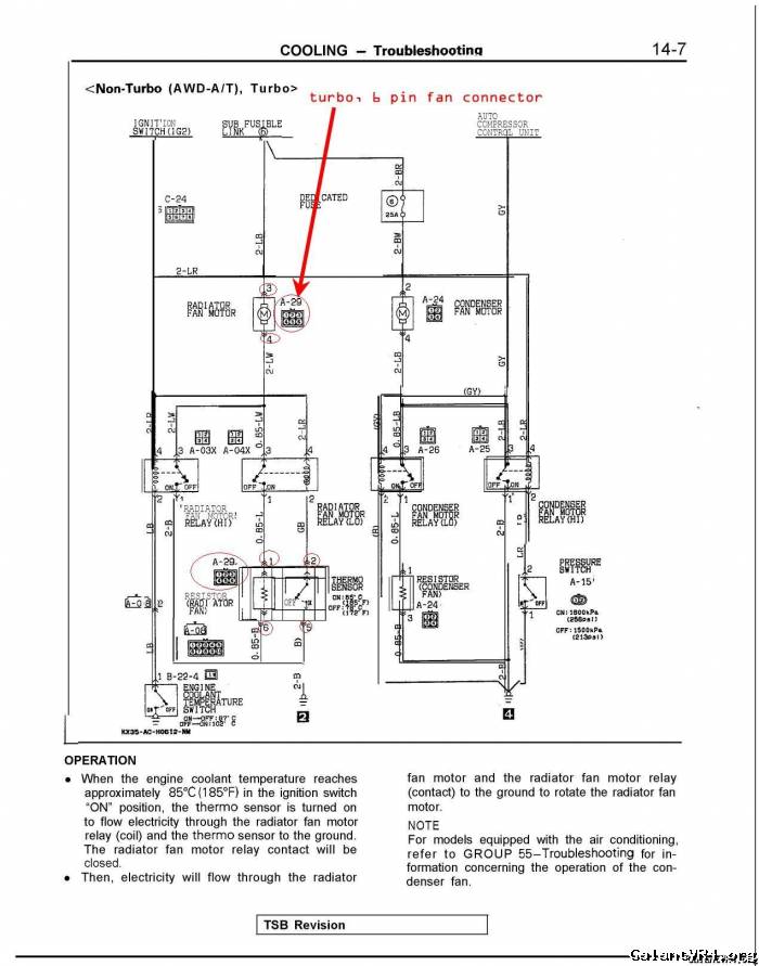

Both fans are always supplied with 12v. To control them, the car uses a series of relays to control the path to ground for each fan. For the main cooling fan, at 185*, the thermo sensor allows a path to ground, activating the low speed relay, which then allows the fan motor a path to ground through a resistor. This gives you low fan speed. At 206*, the fan switch allows the high speed relay a path to ground, which in turn gives the fan motor a direct path to ground. This gives you high fan speed. See the diagram below, which you can pair up with the word picture above:
Your fan motor should only be able to go to ground through either the high or low speed relay. These relays should only be able to provide that path to ground if their coils are 1) supplied with voltage from the ignition switch and 2) supplied with a ground when all the conditions for activation are met (see the first paragraph). If your fan is coming on with the car off and battery connected, that means the fan motor has a short to ground. Trace the ground side of the fan motor circuit, and see where it is going to ground. If that doesn't work, connect the battery and let the fan motor run. Start disconnecting the grounds you moved/messed with until one of them turns the fan off.

I'm still at a loss with this. Fan is wired up to pins #3 (+) and #6 (-) as per the FSM pinout. Wiring for the fusible link box has been put back to stock, as well as the alternator wire.

The main factory fan comes wired to pins 3 (+) and 4 (-) as traced from connector A-29. If you're currently trying to mimic the stock configuration, swap your fan wires to these pins. If your fan ground wire is currently wired to pin 6, it will have a direct path to ground all the time just like you're describing. Swap the ground wire and you'll probably fix your issue.

Issue resolved. I wired it up as per the other thread that was linked, and it worked as soon as I remembered to hook the grounds back up!
I feel like I should have noticed that pin 6 was grounded as much as I stared at the diagram.
