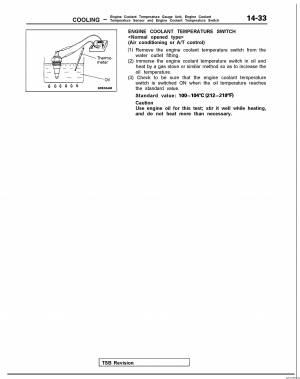

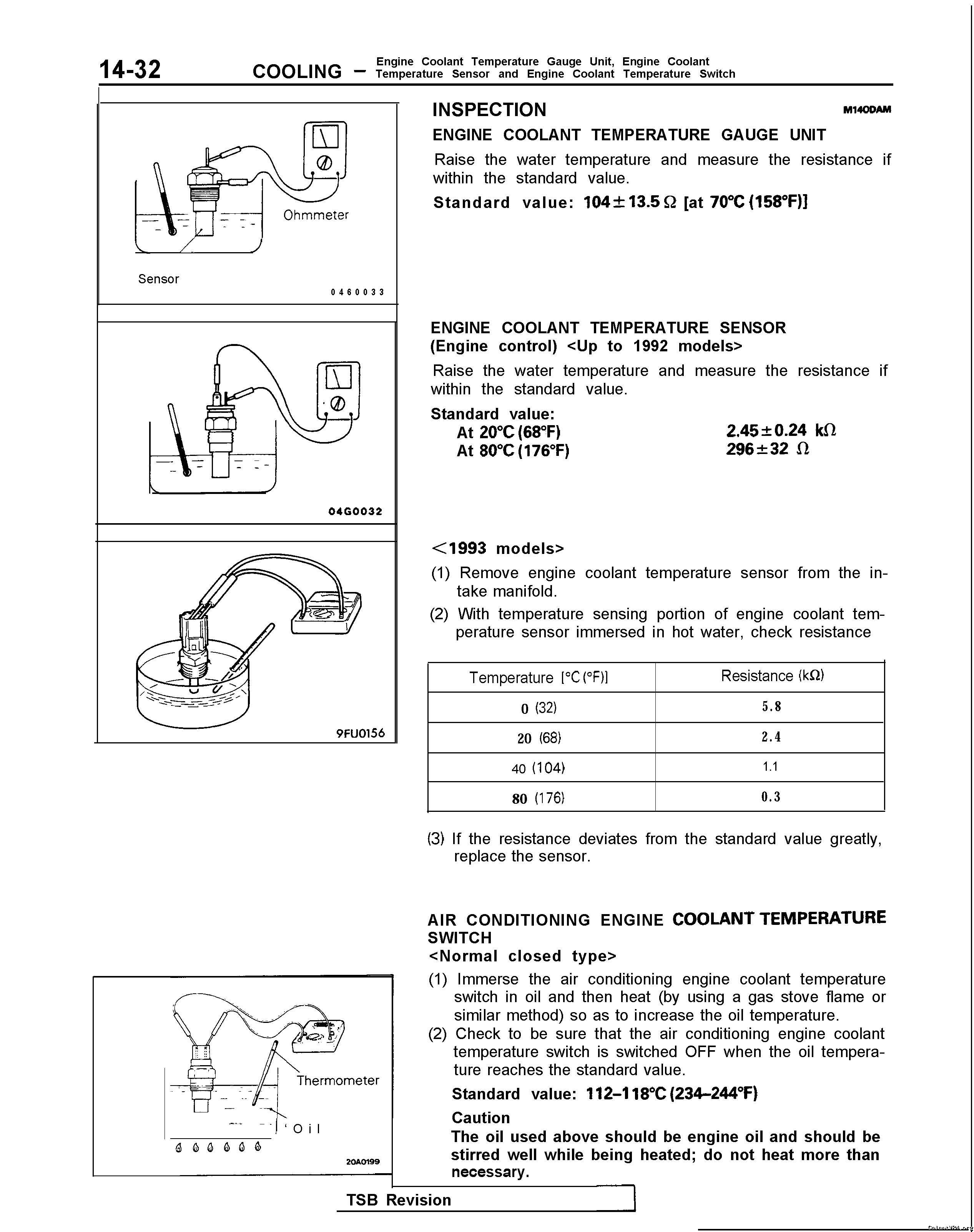

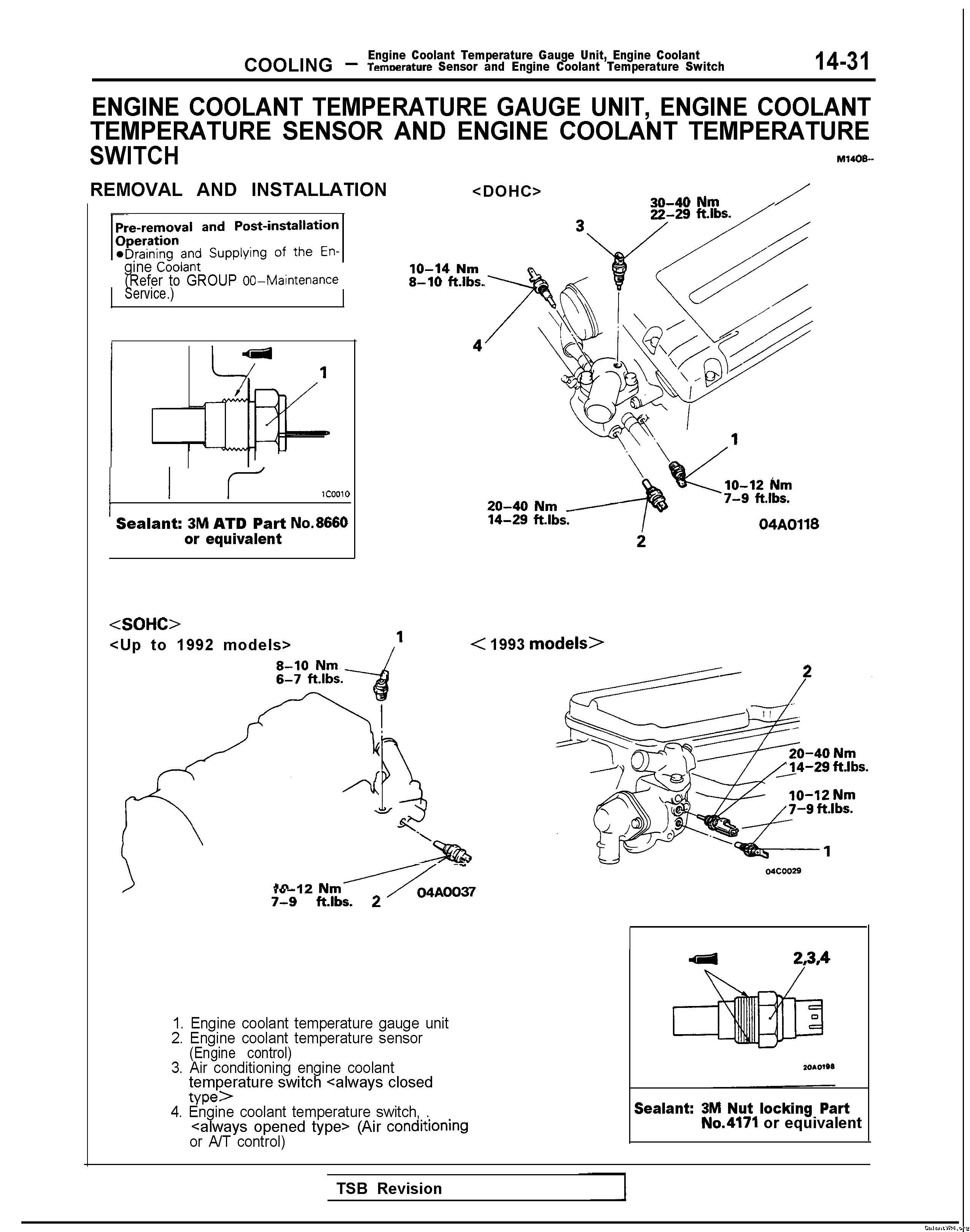

One sensor controls the normal cooling fan, while the other controls the A/C condenser fan. The single bladed one towards the front is for the temp gauge in the gauge panel.
Do you have a copy of the factory service manual? If not, here's the link to both volumes:
--> Body & Electrical
--> Chassis & Mechanical
You'll find the answer you're looking for in the cooling section of this volume
But, here it is, also /ubbthreads/images/graemlins/wink.gif
Hope this helps /ubbthreads/images/graemlins/smile.gif
