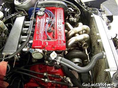

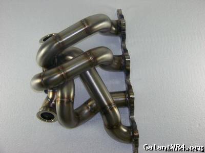

Has anybody used this manifold on thier vr4? I'm curious as to whether it will fit with an hx35 with the outlet facing up, or if I'll have to modify my ETS FMIC setup to accommodate it facing down like the DSMs.

When JMF did my VR4 exhaust manifold they had to move one of the wastegates and change up the configuration to make it fit compared to normal dsm setup. Hope this helps

Yeah I seen the manifold JMF has for the GVR4, I just would rather not mess with my exhaust too much. I just read through your build thread and I was really impressed, then wanted to cry. I think I'm going to go with the punishment racing manifold, but I don't think it will all fit with my 1g radiator in the stock location. I'm planning on removing my A/C this Christmas break(I never use it), relocating my alternator(200amp Saturn) to the back, and trying to slide the 1g radiator in where the condenser was located. Hopefully then the manifold will fit easily, and I will be able to run the hotside intercooler pipes below the manifold with the turbo facing down.

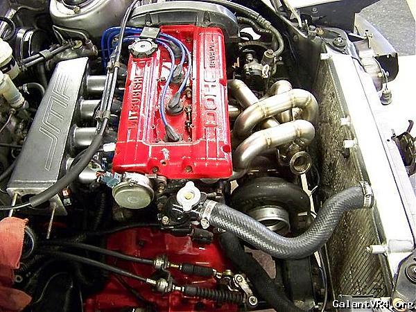

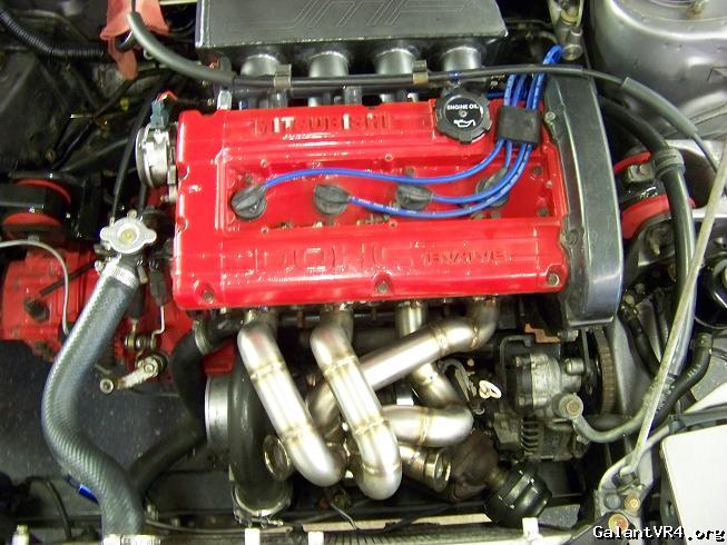

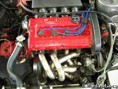

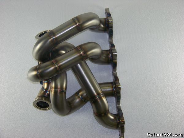

Well I initially saw a thread on here where someone slid a 1g radiator in where the condenser is, that's not going to happen, at least with my 1g Fluidyne. I went ahead and ordered the JMF T3 divided manifold from extremepsi with the egt port and tial f38mm wastegates since I have a egt setup and already have a tial 2 bolt flange 38mm wastegate. I'll pretty confident I'm going to need to move my radiator and since I suffer cooling issues with a full size radiator now, I'm going to opt out of the half radiator and just go with the scirocco radiator from summit racing. I'm not excited to build the o2 housing though lol.
i have my trubo going down and running a 1st gen est front mount with short route piping and a civic half size radiator. its tight. i had to wire the slim fan to push the air instead of pulling. i will eventually do a tread on my build sense ive done it from a shell pretty much and had to custom make just about everything. including the 4in alloy exhaust /ubbthreads/images/graemlins/laugh.gif
