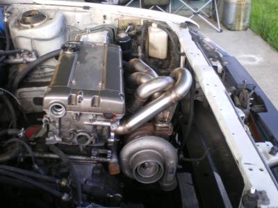

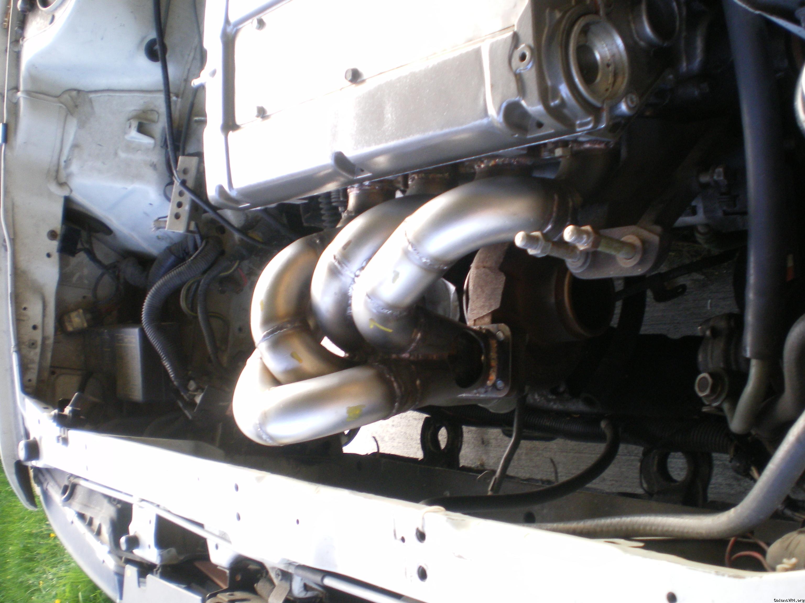

85tr
Oct 21, 2006
208
washington
Im gonna run a hx35, divided manifold with twin wastegates, the wastegate runners are still not done but i can tell you with a fully divided mani if you want to run a singe wastegate there is just not unuff room for you to make and place the collector you would need to keep the manifold fully divided .Here are some pics of my setup.
