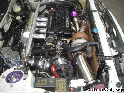

Hi guys,
I'll be running a billet Holset HX40 with the .70ar vband BEP housing. I was wonder if anyone have ran this turbo with a T3 manifold in the galant vr4. If so, what manifold was it? How much clearance did you have?
I understand it will require some grinding of the front motor mount.
Anyone in PA area want to let Redjack racing test fit their manifold on a galant VR4? They're having a group buy and the manifold seems to be pretty legit. click see post #61

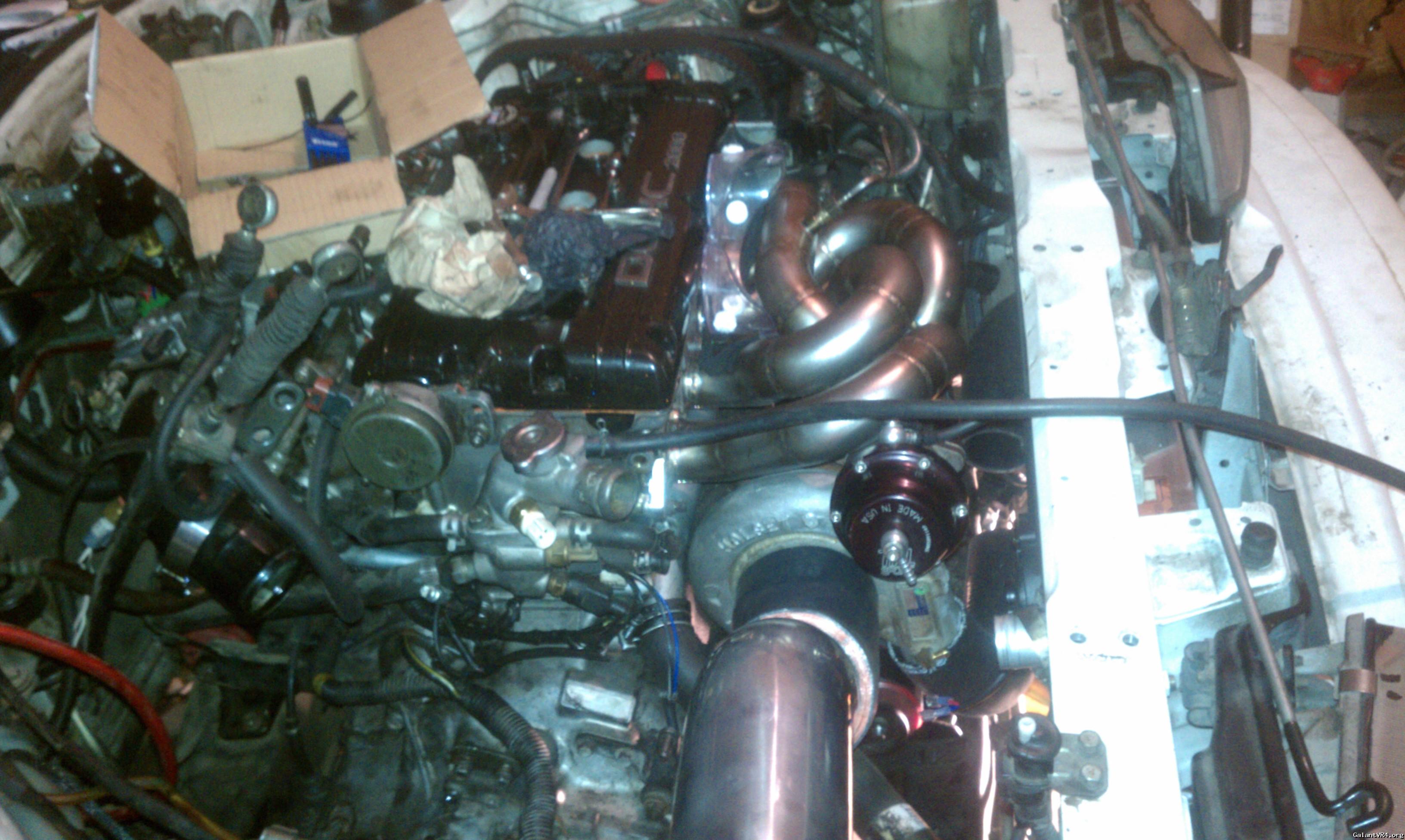

I can show you clearance for the JMF bottom mount t3 TS manifold if you would like. But I am not running my radiator in the stock location.

WaRrIoRs16
Mar 23, 2008
373
Ferndale, WA

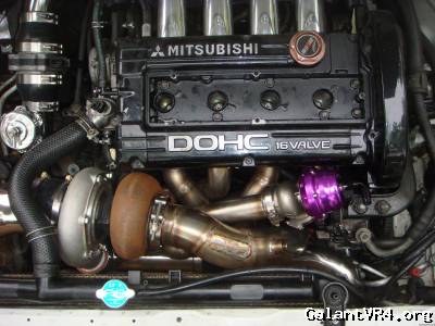

Sorry I forgot to get a picture. Here is one that I had taken just as a progress picture. I will try to get a better one to show how much room is there. With this manifold you can't keep the full radiator in its stock location. You have to point the turbo downwards and there would be no room for intercooler piping+stock radiator.

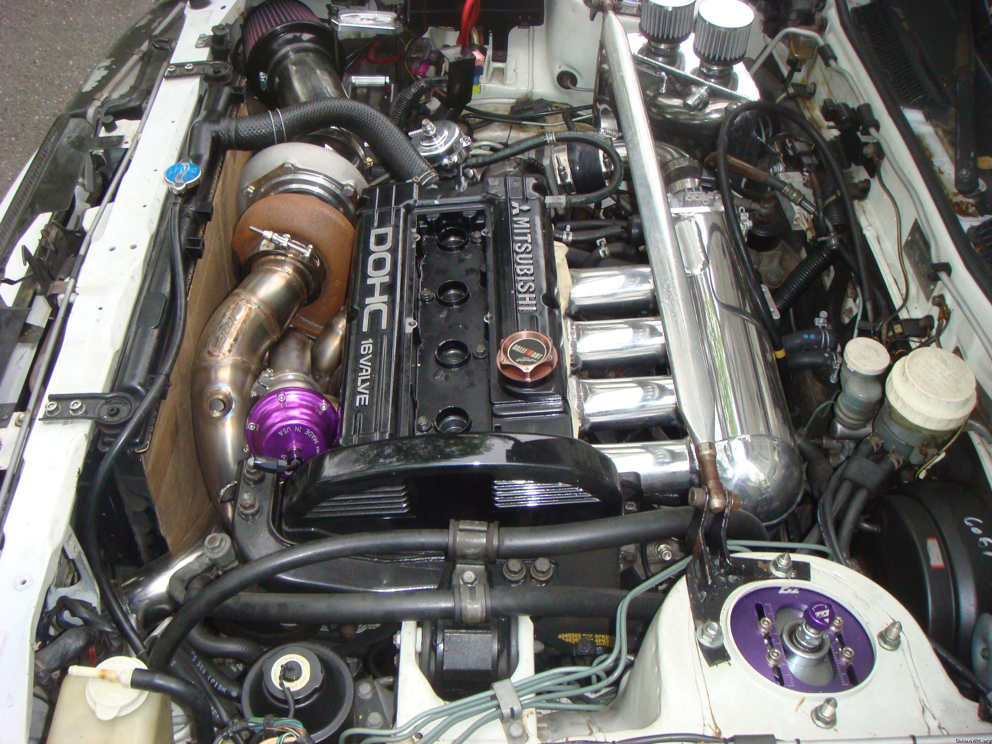

onesickcrx
Jun 3, 2007
1,076
NY
If you run solid front and rear mounts you can run this header with out moving the radiator its just very tight and fan need to go in front of radiator. I agree tho that moving the rad makes this a nicer setup

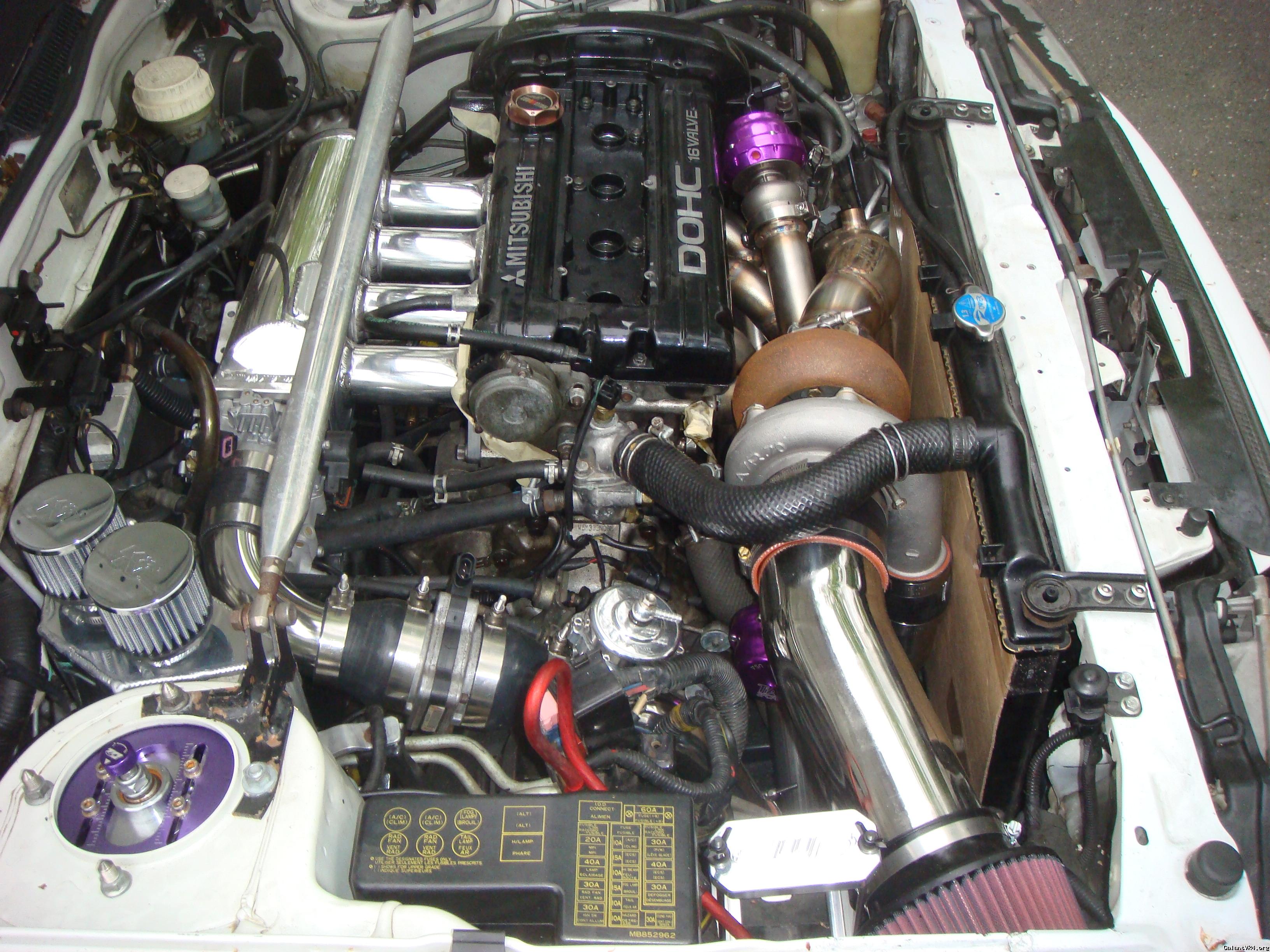

Ill post a pic up of my 35r with the JMF t4 top mount and stock rad in place to give you a idea of how close it is when I get home
