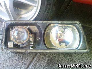

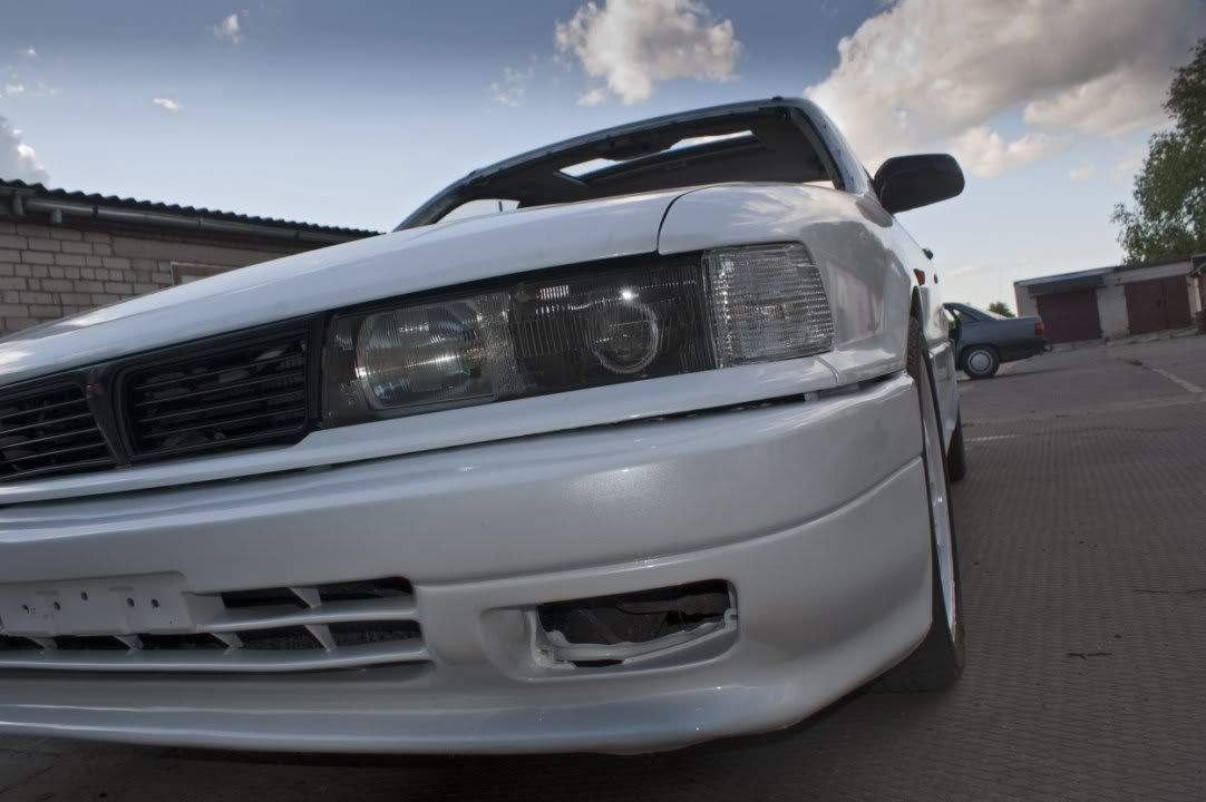

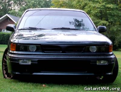

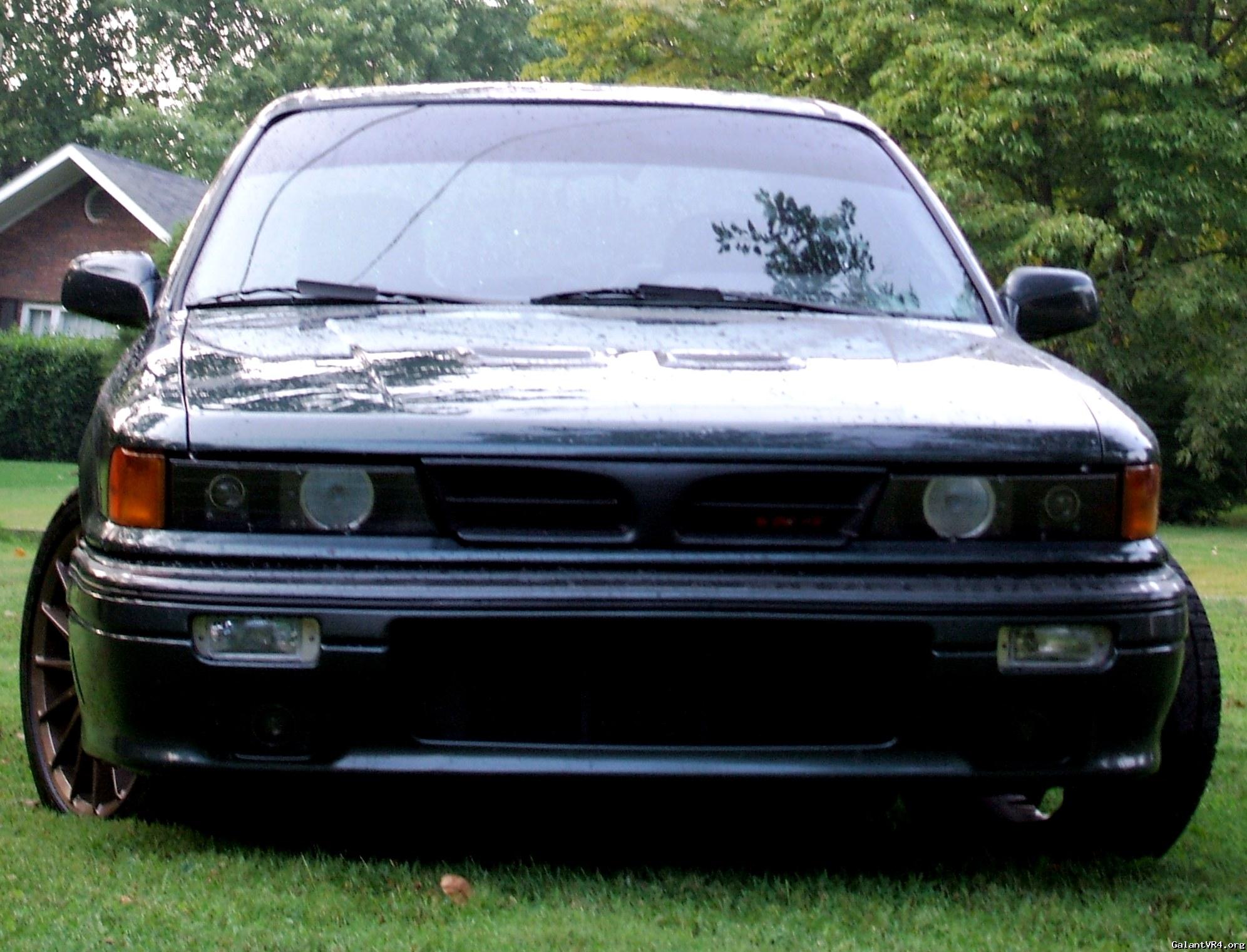

I've built 5 sets have one I need to do and ship that I've sat on forever, again sorry but will be doing them soon and have restored probably 10 sets of 93's. Got a few sets of those in the way in the shop i need to do as well. Its not hard but just hella time consuming. Takes about a week because of drying time, design time, focal points, mounting projectors etc. Its best to use 93 lens with 92 backplates because of the defraction gradients on the backplates of the 93's. As for projectors you can use factory stuff from junkyards, ebay or online suppliers that sell projectors for rally cars. That way there not really cheap. Junkyards are your best bet and get a bonus of Hid's if your lucky. As I've said not hard but just time consuming others have also did theres and a few others started and never finished.
Paul's lights
Hill's lights while white , they had to be redone because of the idiots at the Danville Post office. They ended up going black

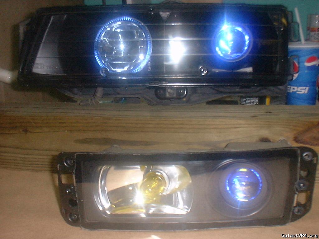

Mine that I sold to Jason, regret selling them sometimes but have a mint set of 93's and also mint JDM's to build from for mine. Also something alot of people never notice is the sealed beam units in my signal light holes. I have the brackets i cut on the mill just need to get around to copying them and selling them.

I've shared the procedure more than once but you have to be aware just black paint and some lens inside isn't all that's required you have to mount the pieces inside so the focal points are correct or there just for looks during the daytime. Symmetry, spacing in 3D have to be just right or it stands out like a sore thumb after there done and completed. Mine were diamante highs with projectors from VR4 fogs with carbon fiber pieces from a buell fairing. /ubbthreads/images/graemlins/grin.gif The diamante highs have glass lens and have to be cut and re polished to fit in the holes. If you want to do it yourself go for it but its just alot of time. don't expect this to be a saturday project. It usually takes me about a week to do it after I have all the parts in front of me and there clean ready to build. Part of this is cure time but still just alot of effort involved.
I'll also add the backplates are a thermoset resin and everything has to fit flush if you go mounting something on them and try to tighten it and it put any strain on the backplates they will fracture really easily, Then your inter fresh paint is cracked and water and moisture will get in.
I've sent a few emails already this week. So I'll just do it once here.
I charge 300 labor to include paint full restoration etc. Buyer pays shipping for everything to include getting parts to me and finished lights back to them. To build a set you need 93's for the glass, 92's for the backplates and whatever goes inside, could be cheap or high dependent on whats used inside. Then there's hid's but there getting cheap now at 75 or so a set on ebay. Sometimes you can find projectors there with hids included and or find audi, bimmer etc headlights with projectors you can rip out. But not all will fit due to lengths.
