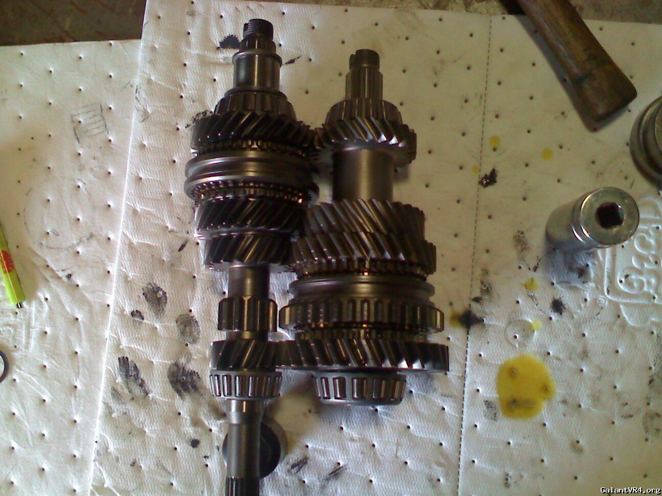

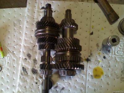

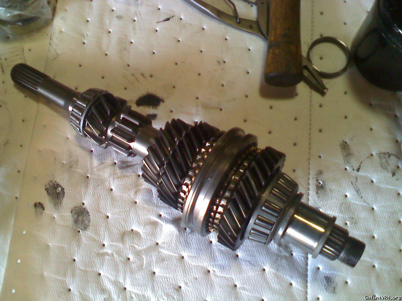

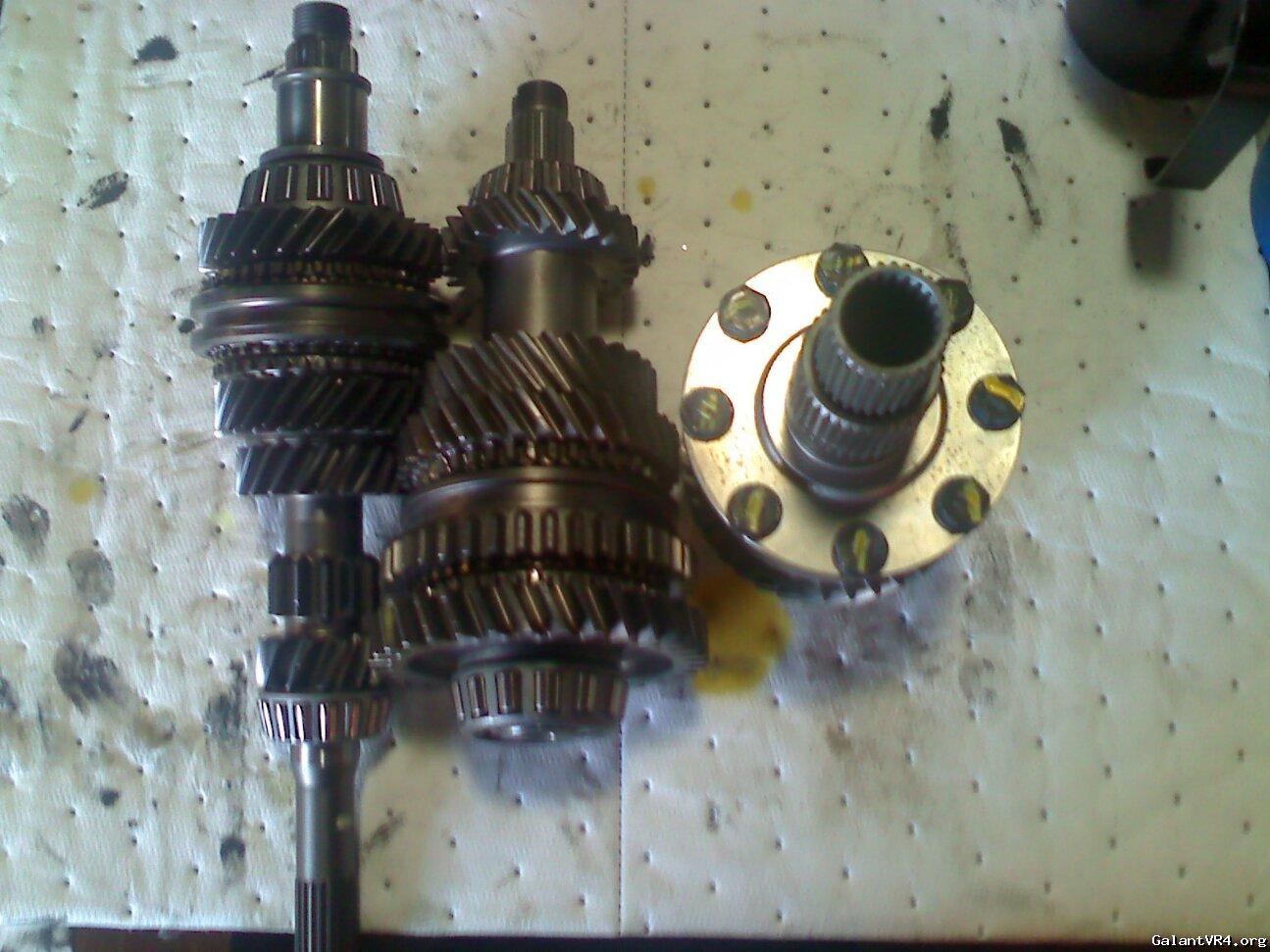

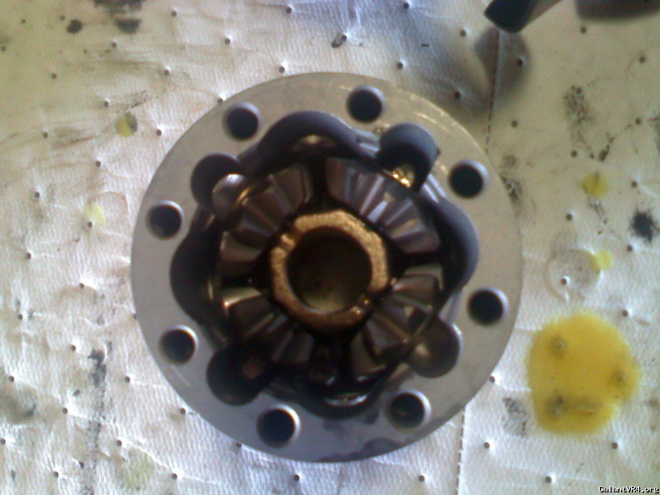

Only using a 4-spider, can't bring myself to buy an LSD for the front. And I opted to keep the standard 5th gear. But all the other bells and whistles. Evo III 1st, 2nd, 3rd, and 4th gears. Full double snycros, latest revision shift forks, all new hub/sliders, keys, springs, input shaft, and filter (yes, I said filter).
Had my ACT chromemoly flywheel turned and stepped proper for the new Clutchnet sprung 6 puck with 3X pressure plate. Don't forget the new EOM throwout bearing and magnetic drain plug. And to top it all off, Diaqueen fluid ready to make these gears happy.
She is coming along nicely /ubbthreads/images/graemlins/grin.gif
