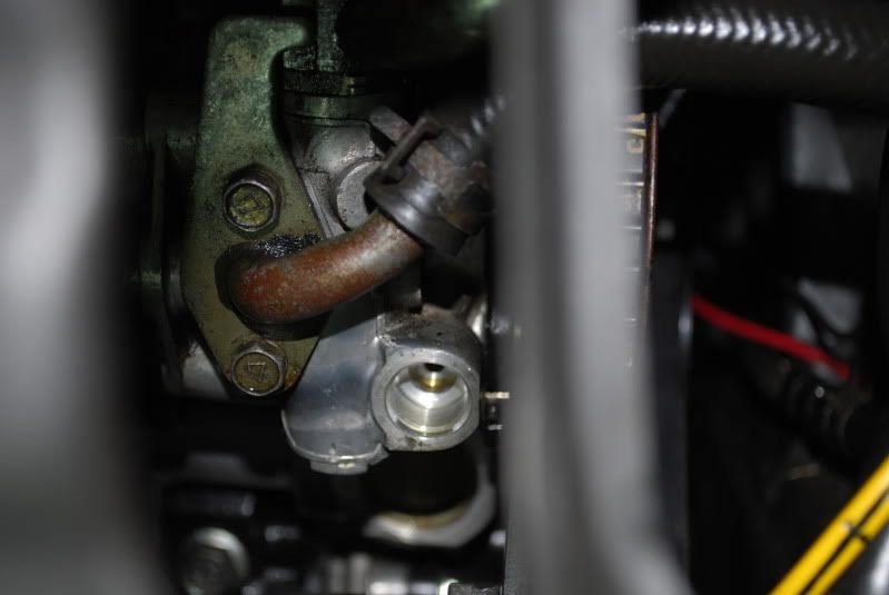

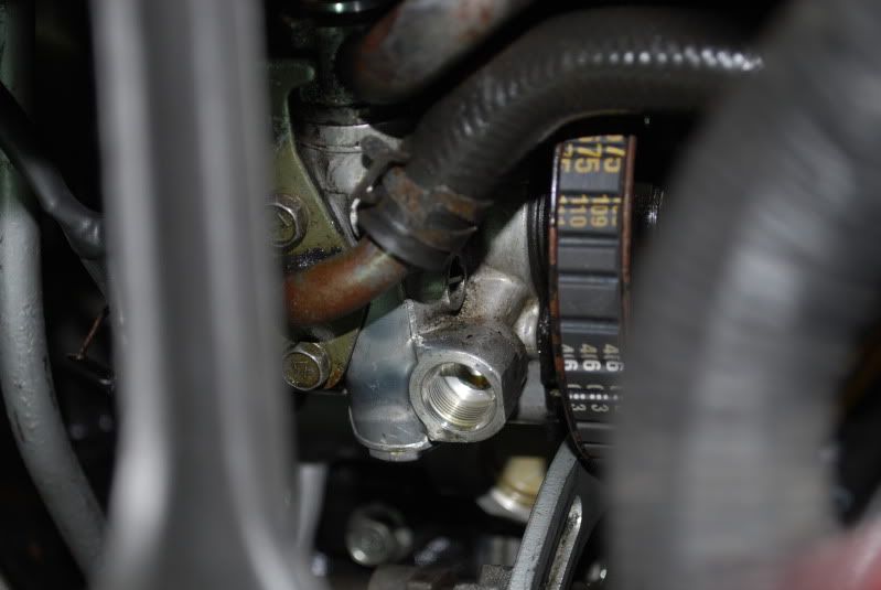

I'm getting everything ready and i have no clue what goes here. I don't remember taking anything out, but i have a bad memory too. lol. I would appericate any help. Thanks,

I think that's where the power steering pressure switch goes. /ubbthreads/images/graemlins/dunno.gif

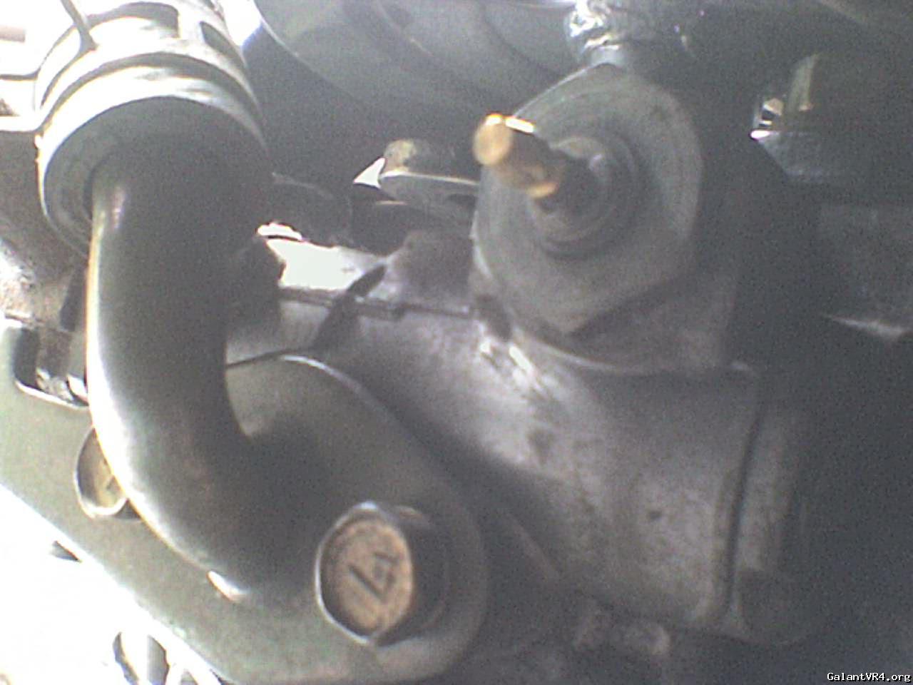

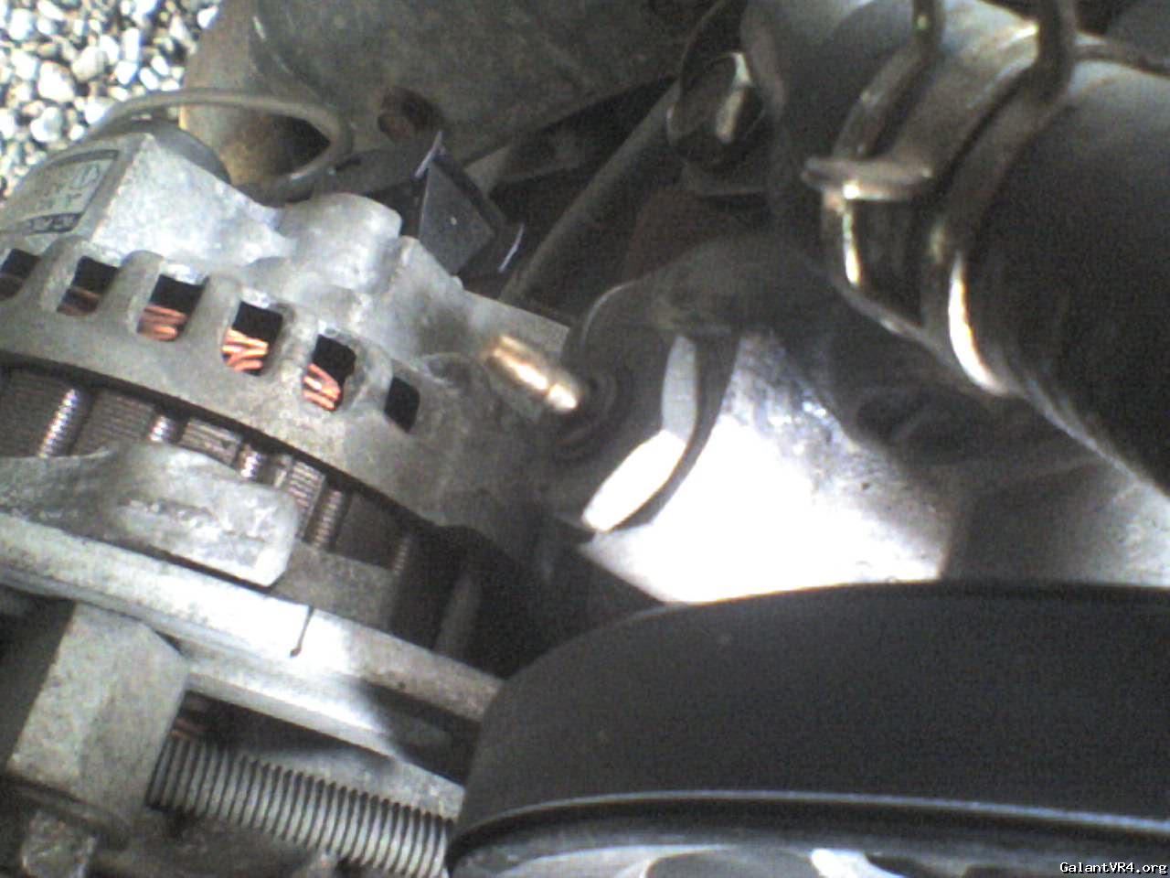

this little doodad here. /ubbthreads/images/graemlins/wink.gif
im pretty shure there was of kind of mineature hose thing that went too it also, but it didnt seem important...
dont realy have any good idea what its for, but its there none the less.

^^^ Thanks for the pic. /ubbthreads/images/graemlins/smile.gif
That's the power steering pressure switch.
The wire that comes off the round pin terminal on the end sends a signal to the ecu when the pump is under load.
The ecu then knows to throw a few more counts of iac at the idle stepper motor to keep the idle rpm from sagging.
