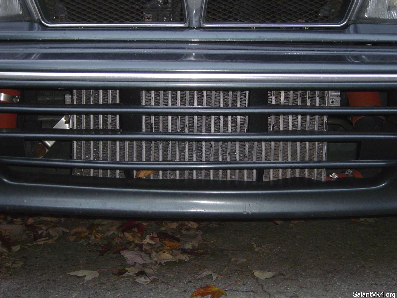

Spearco 10x28 double thick, 2 1/4" lower, 2 1/2" upper hard pipes.

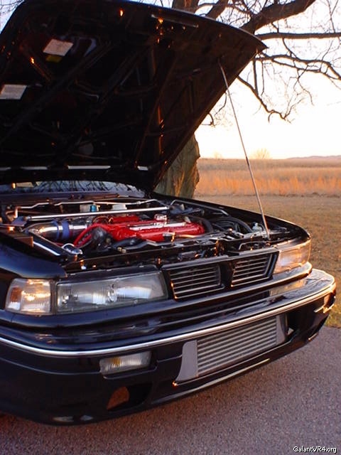

South Florida Performance FMIC 12"Hx33L"x3.5"W tanks inc with 2 1/2" piping (I don't have a good pic of the piping but I did very minimal cutting for fitment of the pipes but did remove the bumper support)

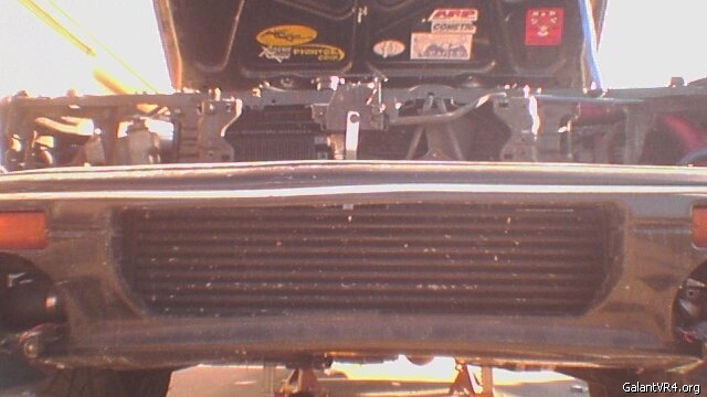

this is a split core that I sourced from a Semi truck. It is a garret core that is 32 inches across and 13 inchs tall. I had to split the core in half and had 2 IC cores for the price of one. I have done temp readings on it after a run and taken the temps from the end tanks and the temp drop is a 193F to ambient ..not to bad for a 75 dollar FMIC.

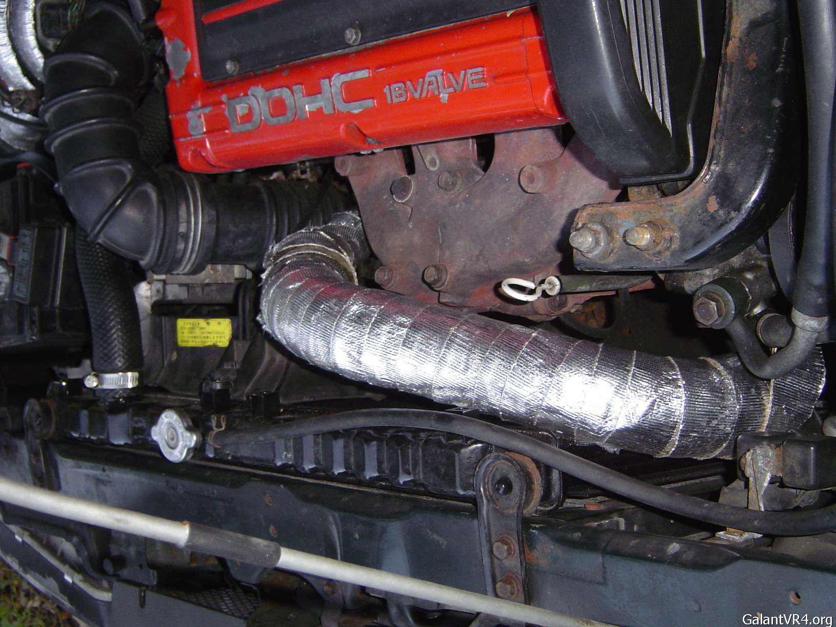

Here are a couple of pics of my setup. It is not the nicest, but it is very effective and was very light on the wallet.
It is a supra intercooler. It works really well. No matter how hard I drive the car, the oulet side is always ambient temperature, never warm at all.
I really like it and there is no more lag than with the stock setup.

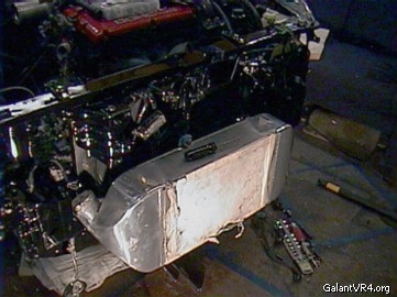

Spearco 2-221 with top to bottom flow end tanks. Piping made custom by me, all routed towards passenger side of car, due to same side inlet/outlet.
