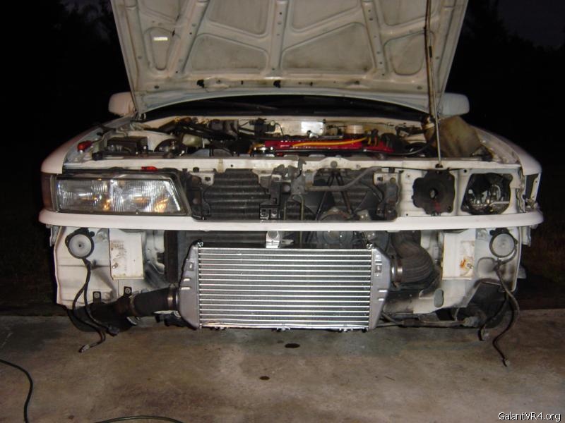

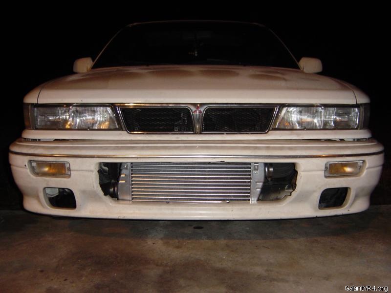

quote:Originally posted by Invader:
JDM GVR4 FMIC and piping with a 2G elbow...
Hey invader, did you have to remove the fog lights to fit the jap spec fmic and plumbing or was it just personal preference?
