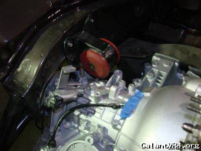

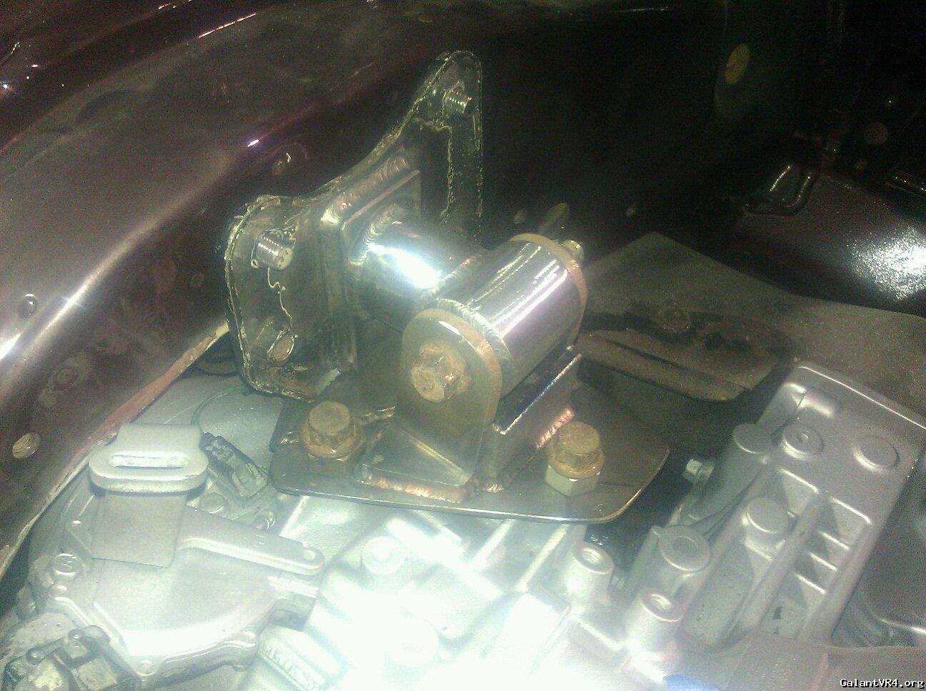

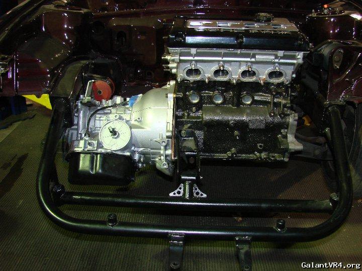

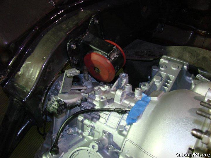

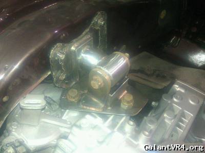

I am looking for a picture of a 2g auto in a 1g. I really want to see the tranny mount.
Terrance362 Well-known member Joined Aug 14, 2006 Messages 388 Location Winston-Salem, NC Jan 16, 2013 #1 I am looking for a picture of a 2g auto in a 1g. I really want to see the tranny mount.
EMX5636 Well-known member Joined Jun 28, 2008 Messages 1,631 Location Bucks County, PA Jan 17, 2013 #2 I'll swagger-jack a pic from my buddies FB, but it requires notching the frame and a custom mount.
EMX5636 Well-known member Joined Jun 28, 2008 Messages 1,631 Location Bucks County, PA Jan 17, 2013 #3 Courtesy of JMFabrications and their lead welder.
Terrance362 Well-known member Joined Aug 14, 2006 Messages 388 Location Winston-Salem, NC Jan 17, 2013 #4 Shut the front door. Damn I thought no one had any pics. I like the cut off front end it makes life so much easier. Thanks man that helps me out

EMX5636 Well-known member Joined Jun 28, 2008 Messages 1,631 Location Bucks County, PA Jan 17, 2013 #6 That car will be amazing and hopefully finished this year. If you go on the JMFab website I think they have pics of the build up.
