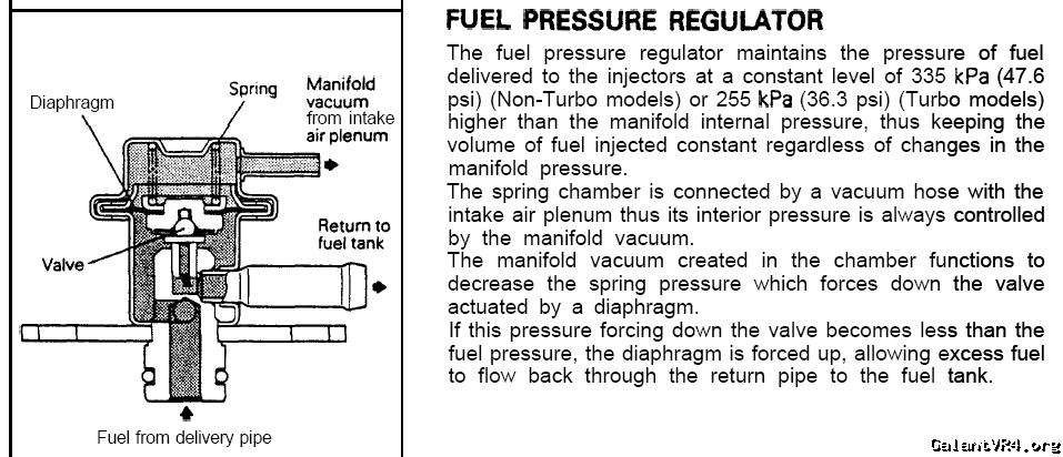

36.3?
The range specified in the manual is generally 36-38psi, BUT...according to the DSM Technical Manual, which I consider to be more accurate:

For something like fuel pressure, the factory probably set the FPR a little to the rich side so that the allowable range varies anywhere from the design (36.3) to the rich side. That way, with a stock computer, you're guaranteed that you'll be rich (safe) and never lean (kaboom!).
Also, because it's a restriction FPR, buildup of crud in the fuel system over time will always cause more restriction (higher rail pressure) and never less. I wouldn't be surprised if a shiny new FPR was pretty accurate around 255 kPa, and that a 100k+ mile unit would run a bit richer.
