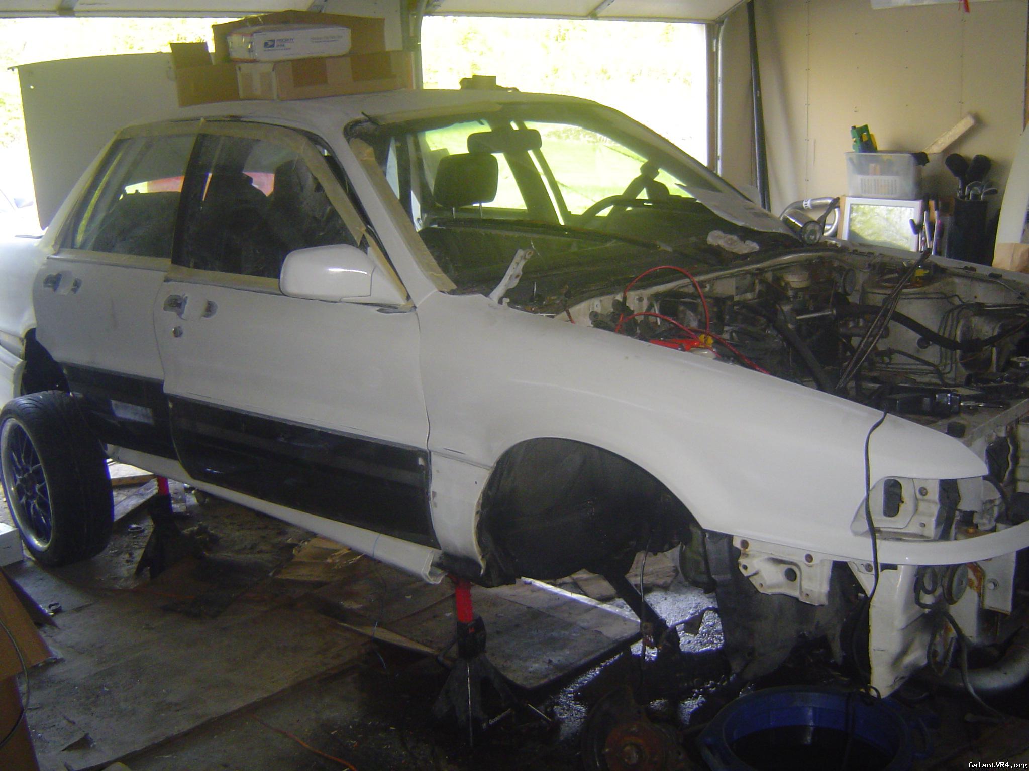

Hello everyone. I picked up this car from a member and great guy a couple months ago and have been working on it since. I bought it with a blown head gasket and could have just replaced that, but the paint peeling on the doors and it had some rust on the under carriage so I kept getting deeper and deeper into it. I'm hoping to get it nice enough to get into the member showcase so I figured I had better get my post count going /ubbthreads/images/graemlins/smile.gif. Like many, I am a dsm veteran and know a little about what I'm doing.
Anyway here's what I've done so far:

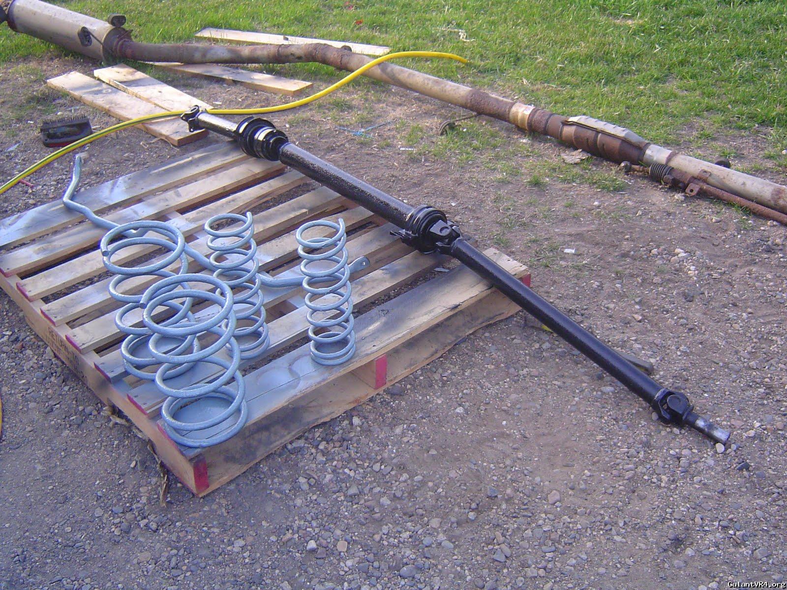

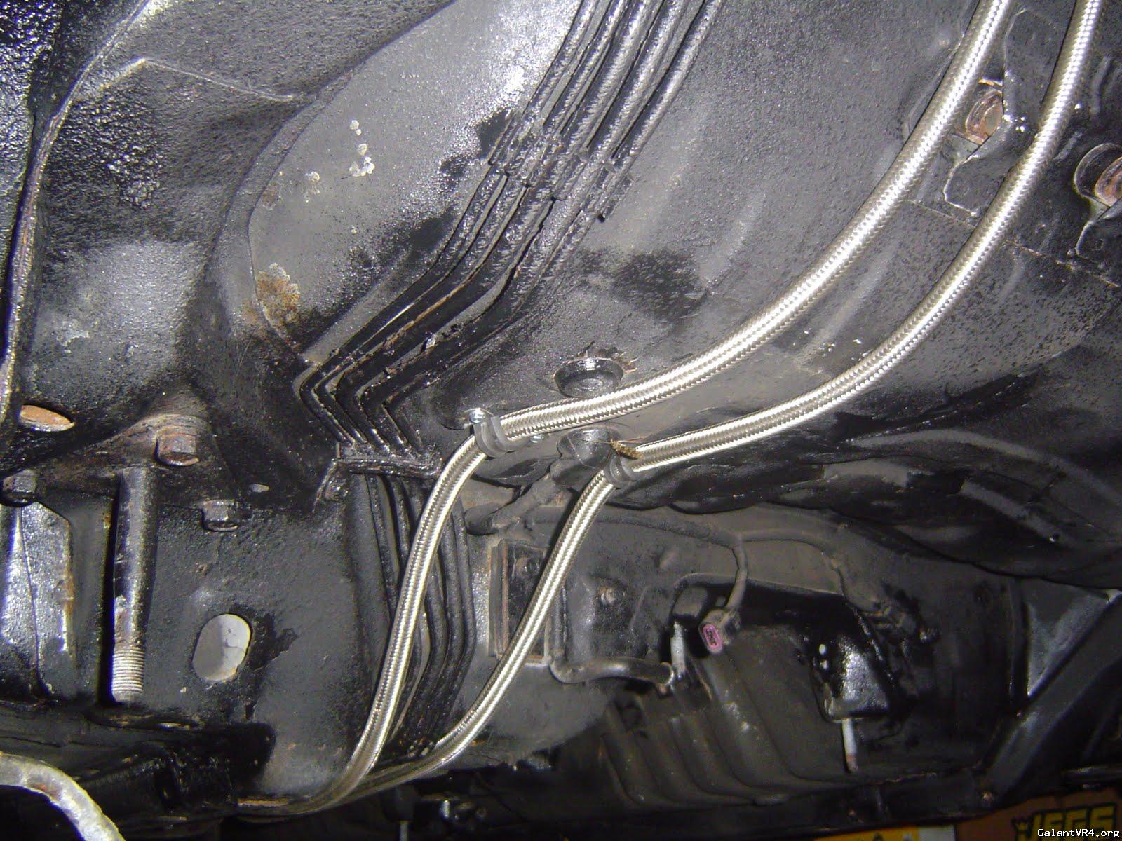

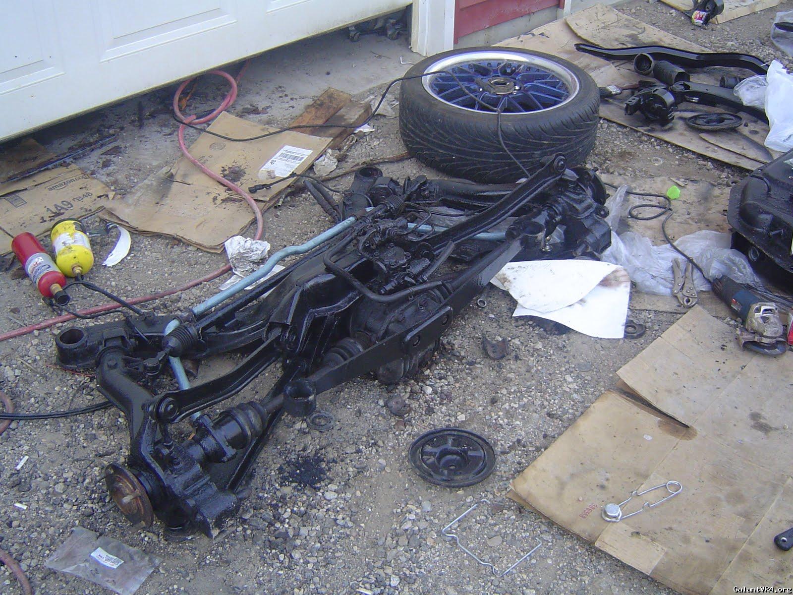

-Removed both subframes and sprayed por15 on the entire underbelly, gas tank, and any exposed part of the car
-Polyurethane mounts on both subframes
-Stainless steel -6 an fuel lines both ways
-New GR2 shocks and refurbished the rusted whiteline springs
-New yoke joints and carrier bearings on the driveshaft
-AWS delete - I wanted to save it but it was just too rusted

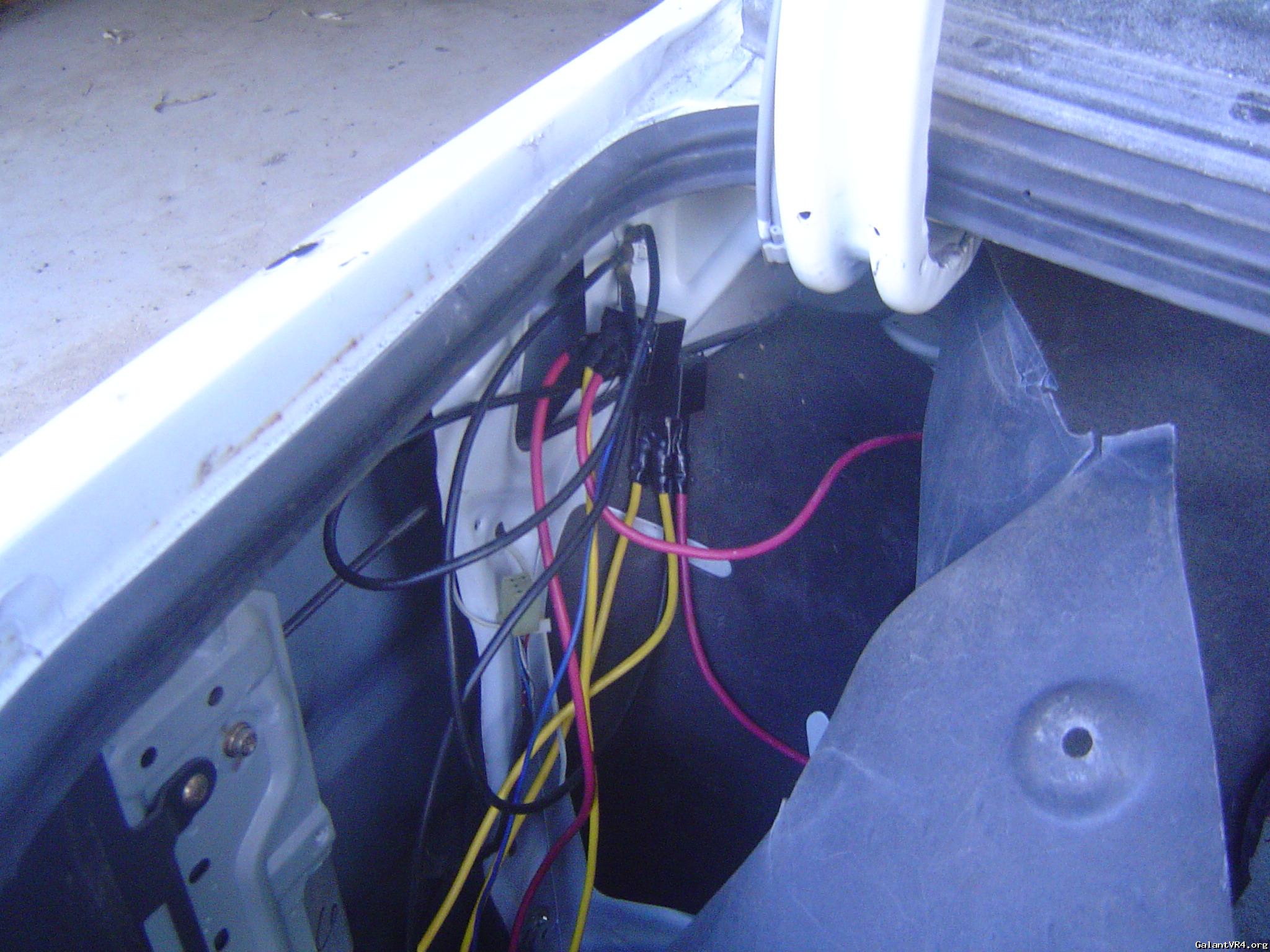

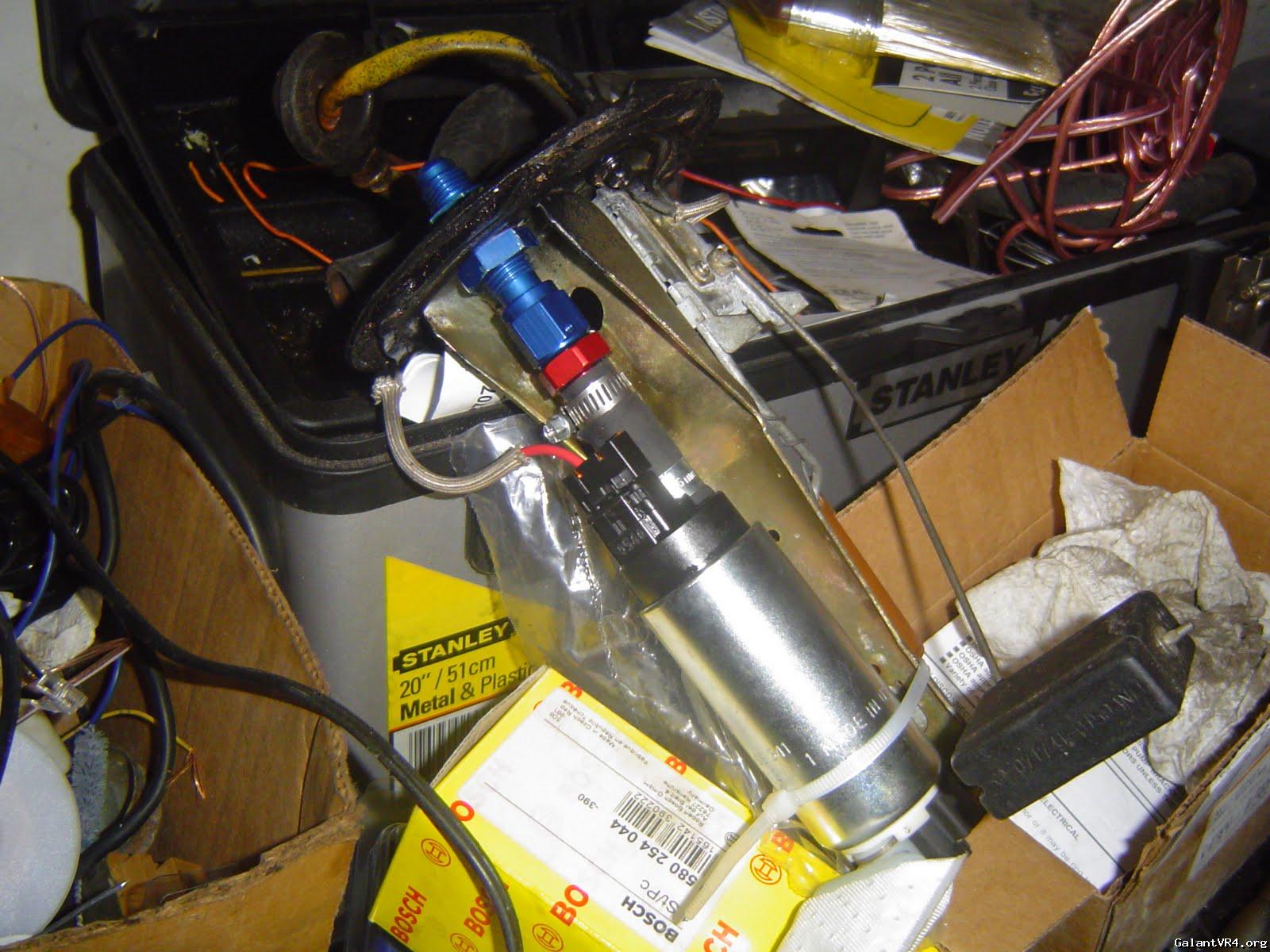

-Redone fuel pump since the line rusted off - walbro 255 with inline bosch 044
I'm in the process of sanding it down for paint. I'm also rewiring the fuel pump. I've got some '93 headlights for it and a 89 grill.

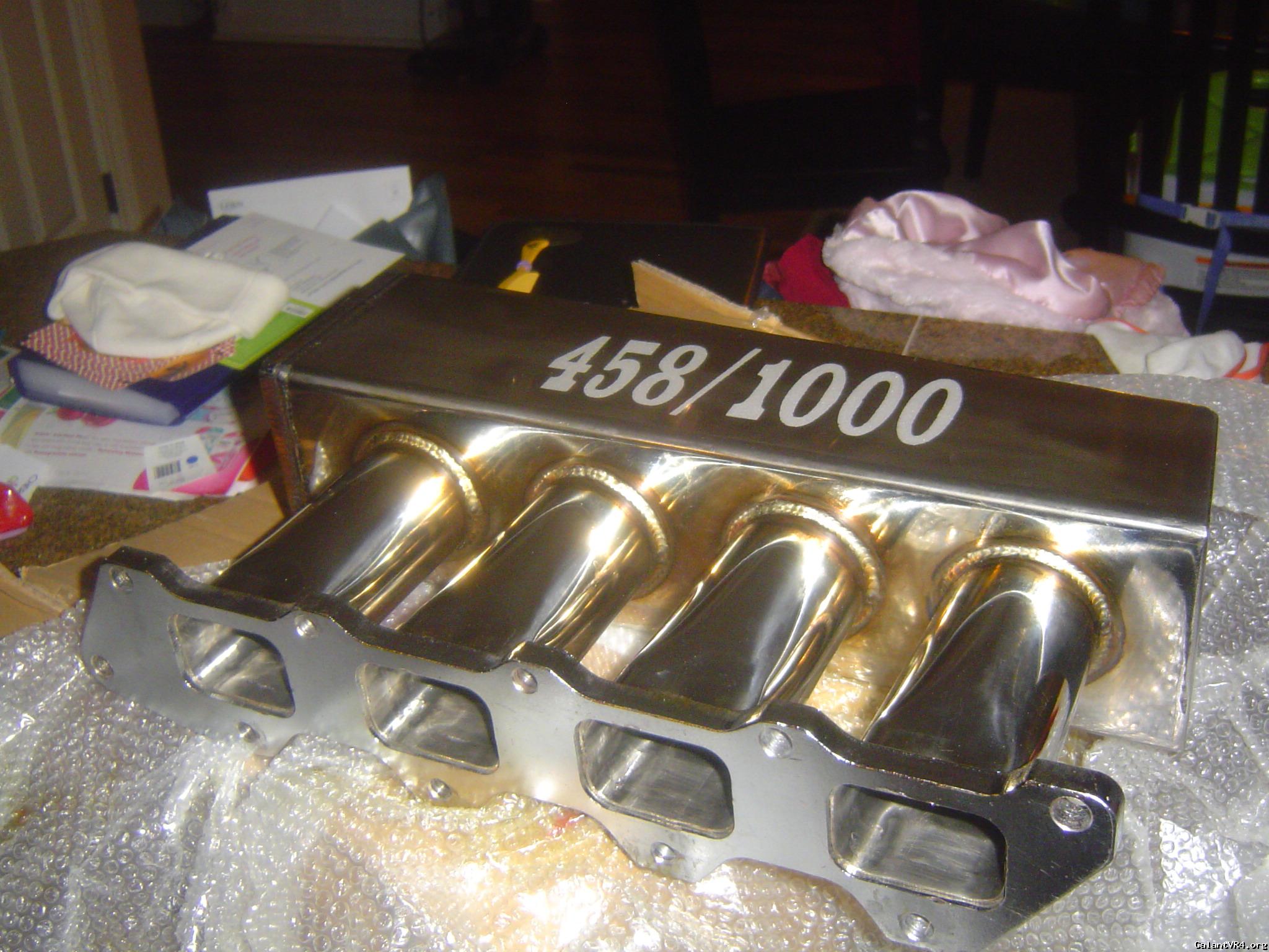

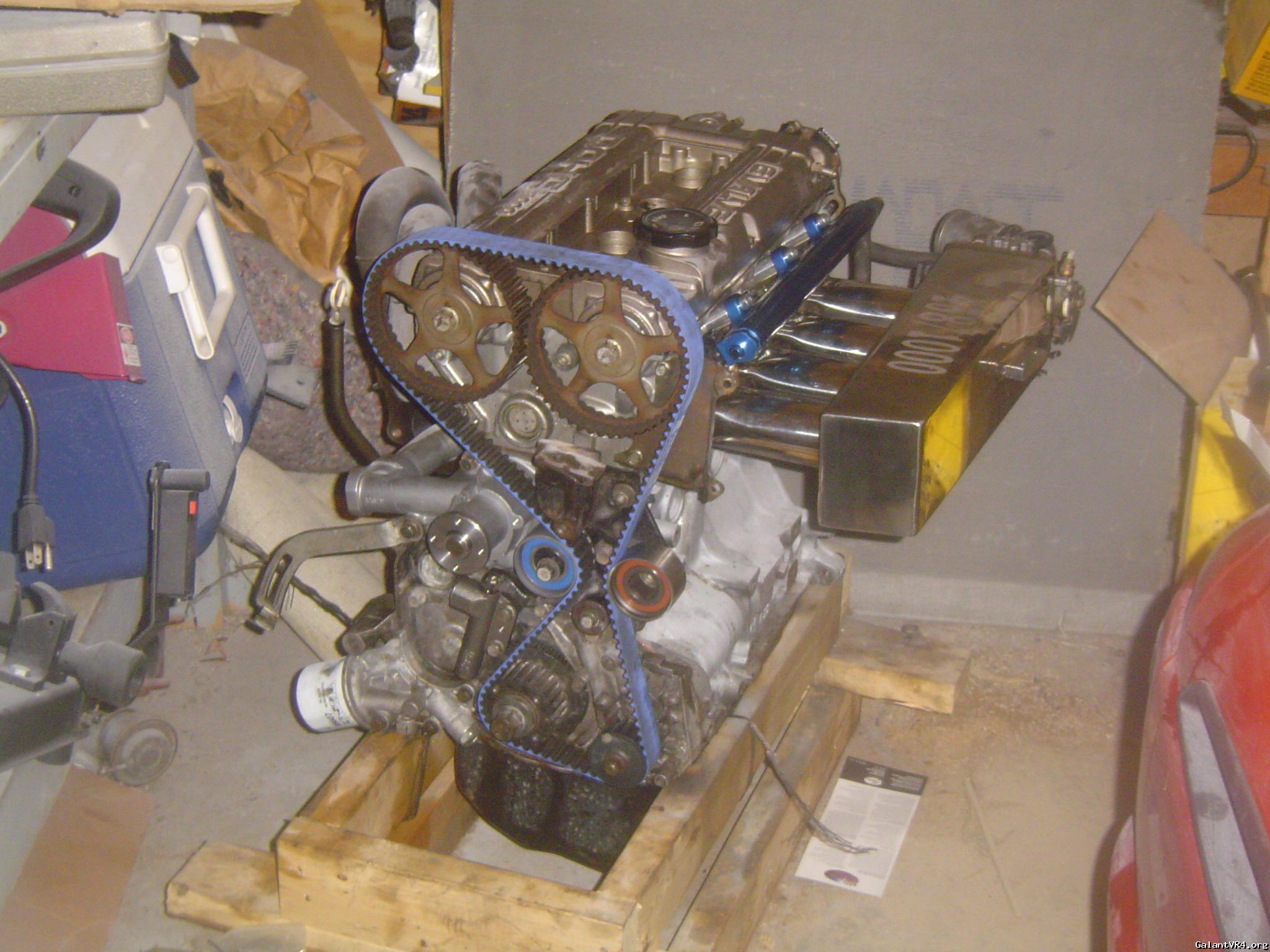

The new engine was purchased from darkside on this site with 8 miles on it. I've purchased a stainless race intake, 68hta, evo exhaust manifold, competition clutch, and a larger fmic. I'm going to make my own 3 inch exhaust for the first time so we'll see how that goes. My goal is to reach 400 to 450 whp on e85 for this dd daycare taker / grocery getter.
Here are some photos of the work so far.
I'm hoping to fire it up within a month but we'll see if I make that. It's already taken way longer than I hoped but I guess that's how these things go - having a 2 year old a 6 month old around doesn't help much either. I'll be posting on my progress as I go along and probably asking for some help from time to time!

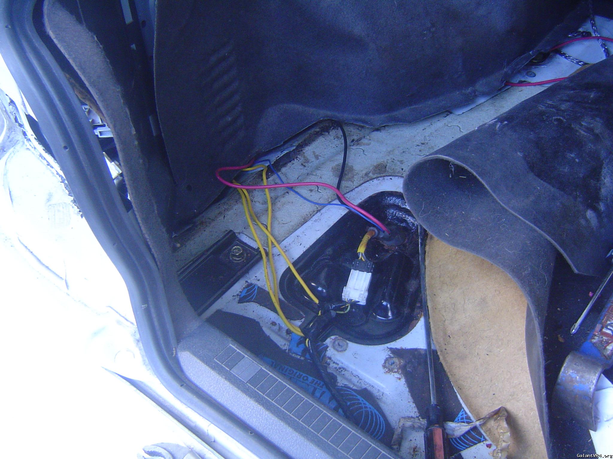

I finally got the fuel pump rewire done today. I also ran a lines and cables for an amplifier if I want to add some sound later, which I'm sure I will. I've been sanding for a while now. I don't think I'll be painting anytime soon since the highs have been 50 or less lately. But knowing MN weather, it could change real quickly.
The car looks kind of sad now, but I can see the outcome everytime I stare at it with a drink in my hand - which is often /ubbthreads/images/graemlins/hsugh.gif

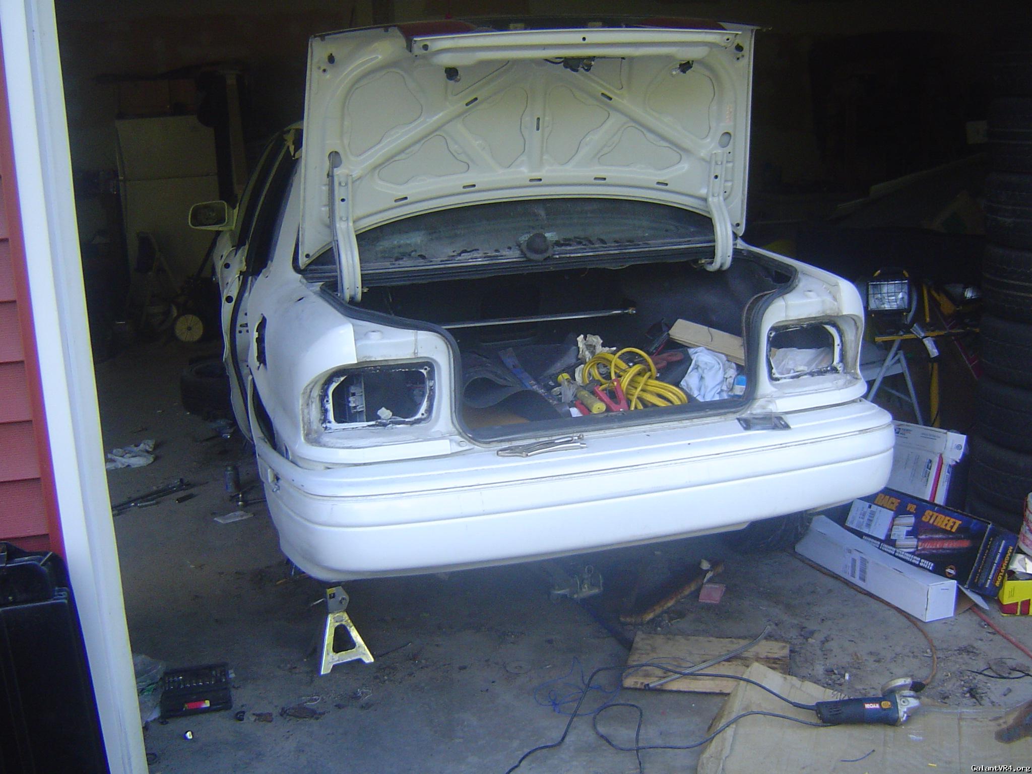

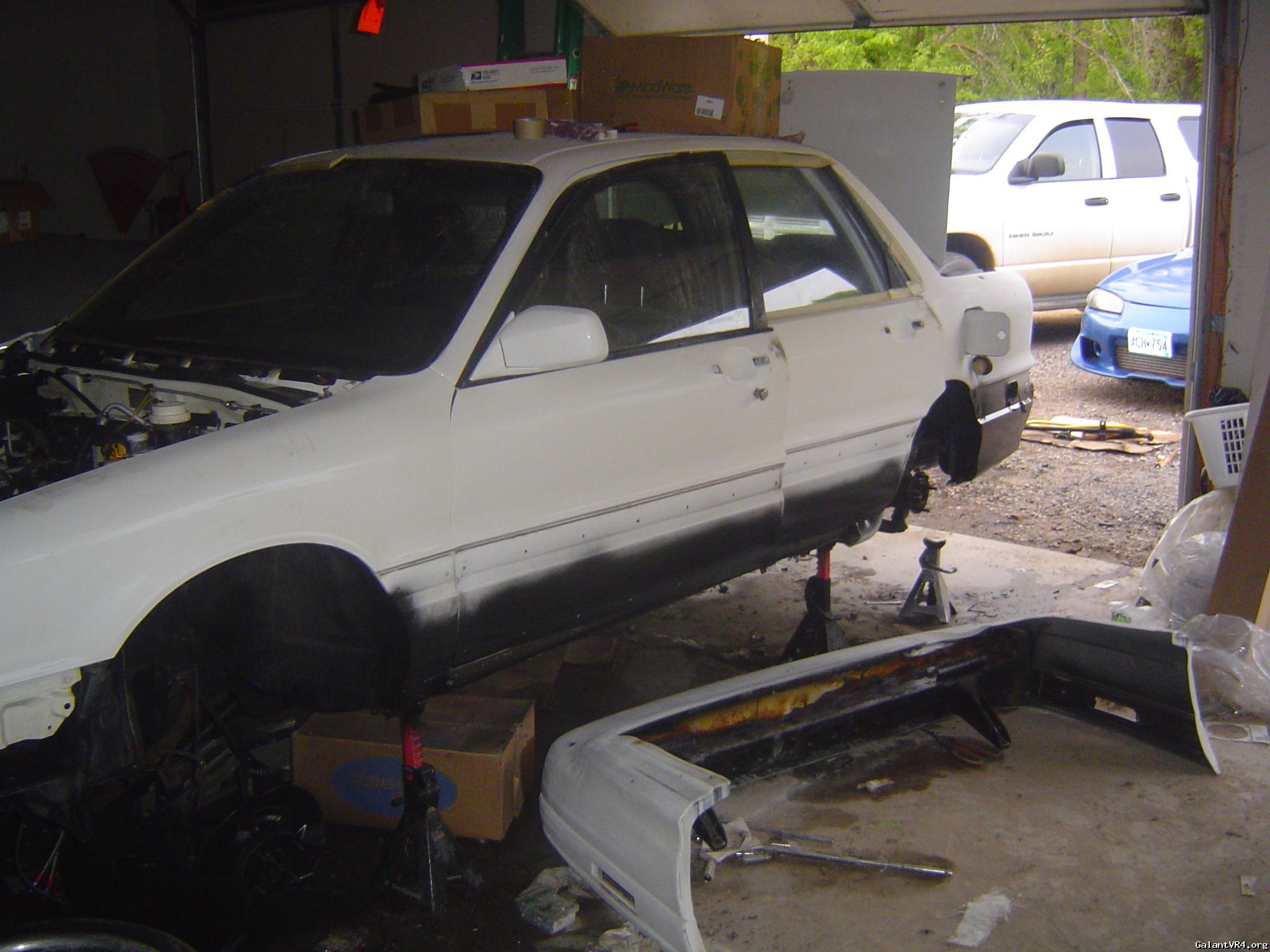

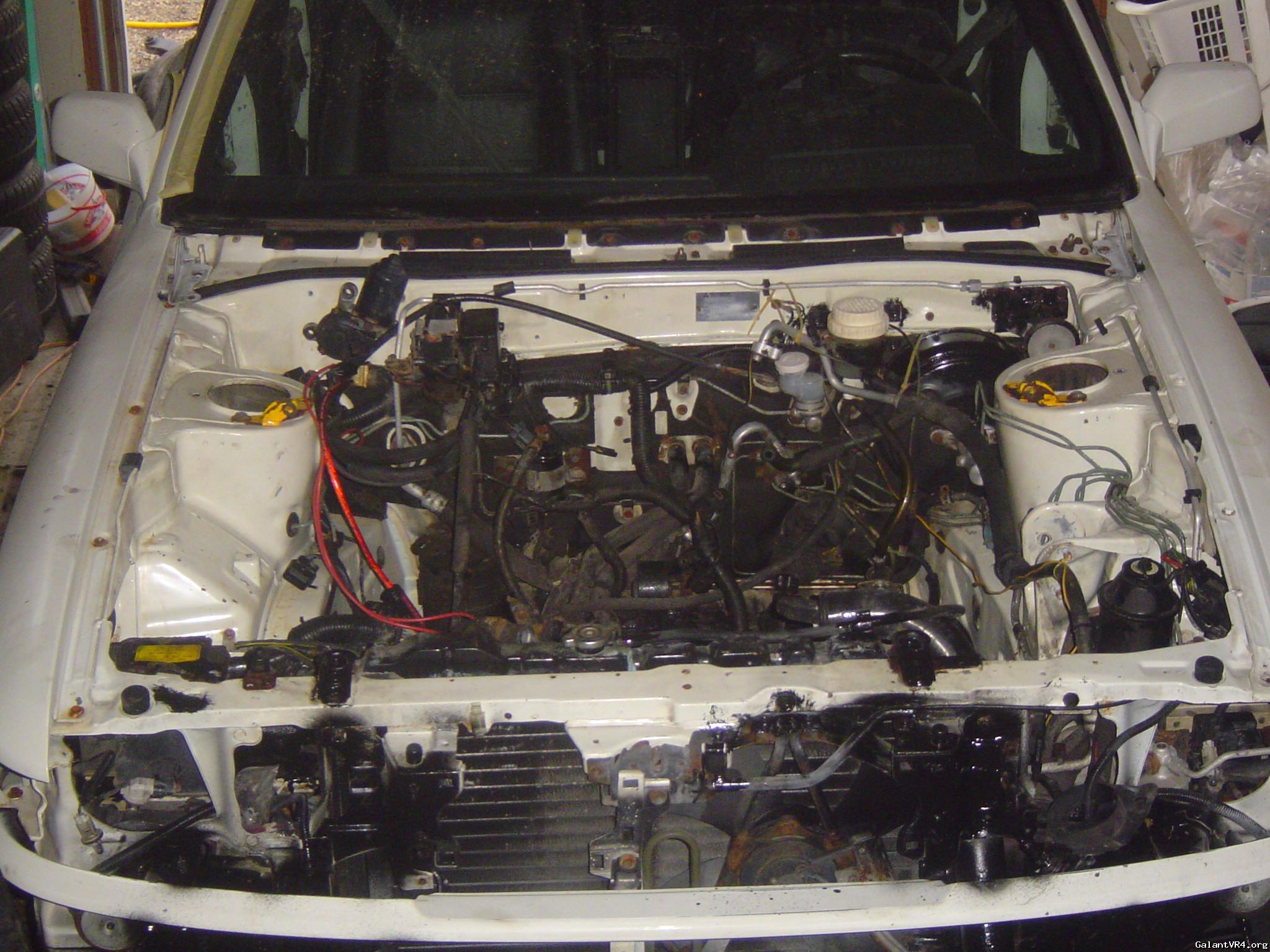

Just an update - I'm hoping to get it painted this Wednesday. They are saying almost 80 degrees so I'm going to take the day off and go for it. I soaked the engine bay with simple green and power washed it and it cleaned up nice. I'm leaving the cruise control box, brake reservior, etc on there because the bolts are so rusted the I know they'll just break off. It's going to make painting more interesting, but I'm tired of snapping bolts.
When I started pulling of the plastic molding I found more rust and a couple of holes on the sheet metal underneath. So I bought more por 15 and kinda went crazy. The frame still looked okay, so I sprayed a bunch of it in there and then closed them up with a fiberglass patch and resin. I hope that stops it. While at it, I also got the doors where some less serious rust was starting too. I know it's way overkill but I really hate rust!

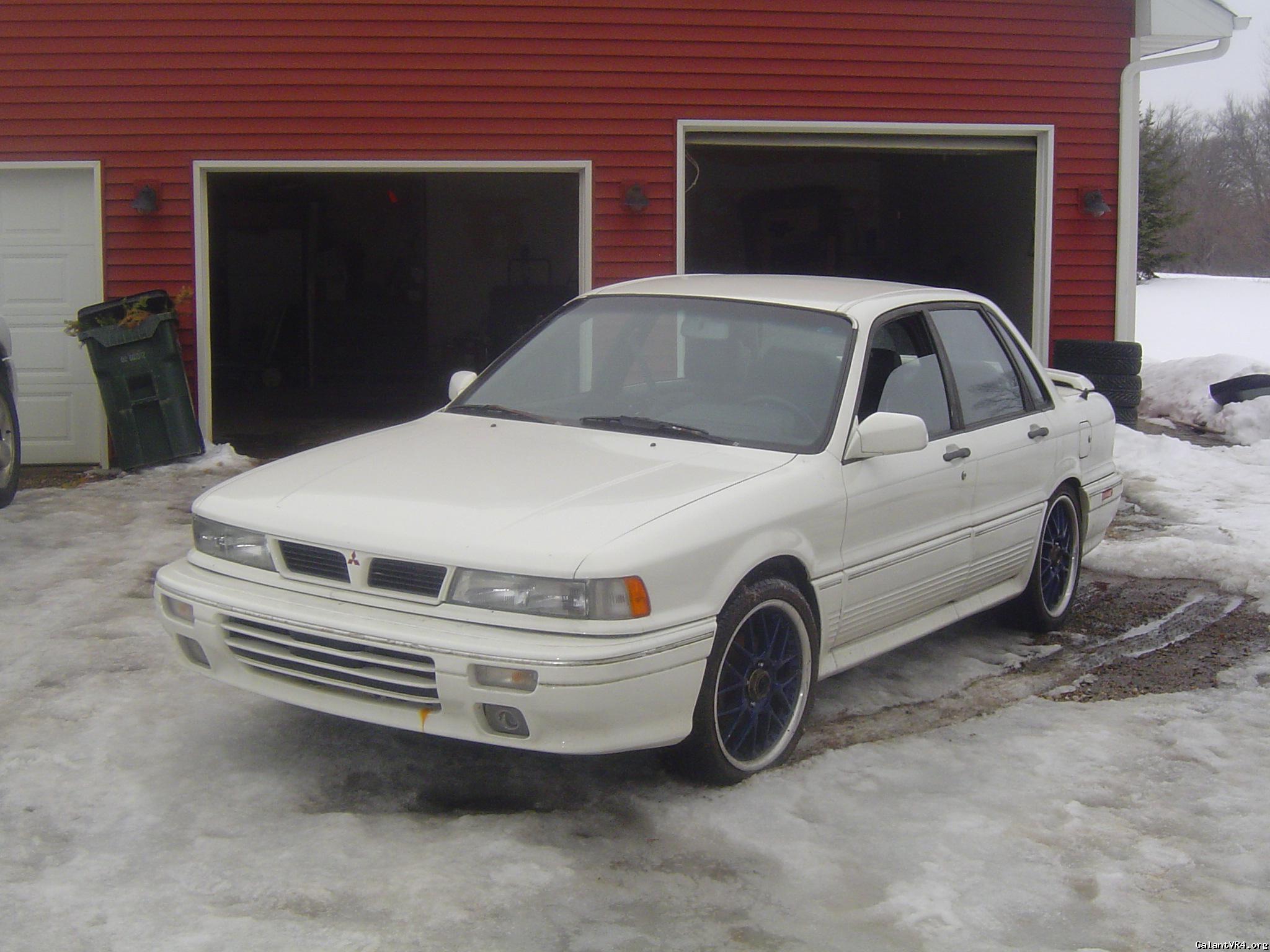

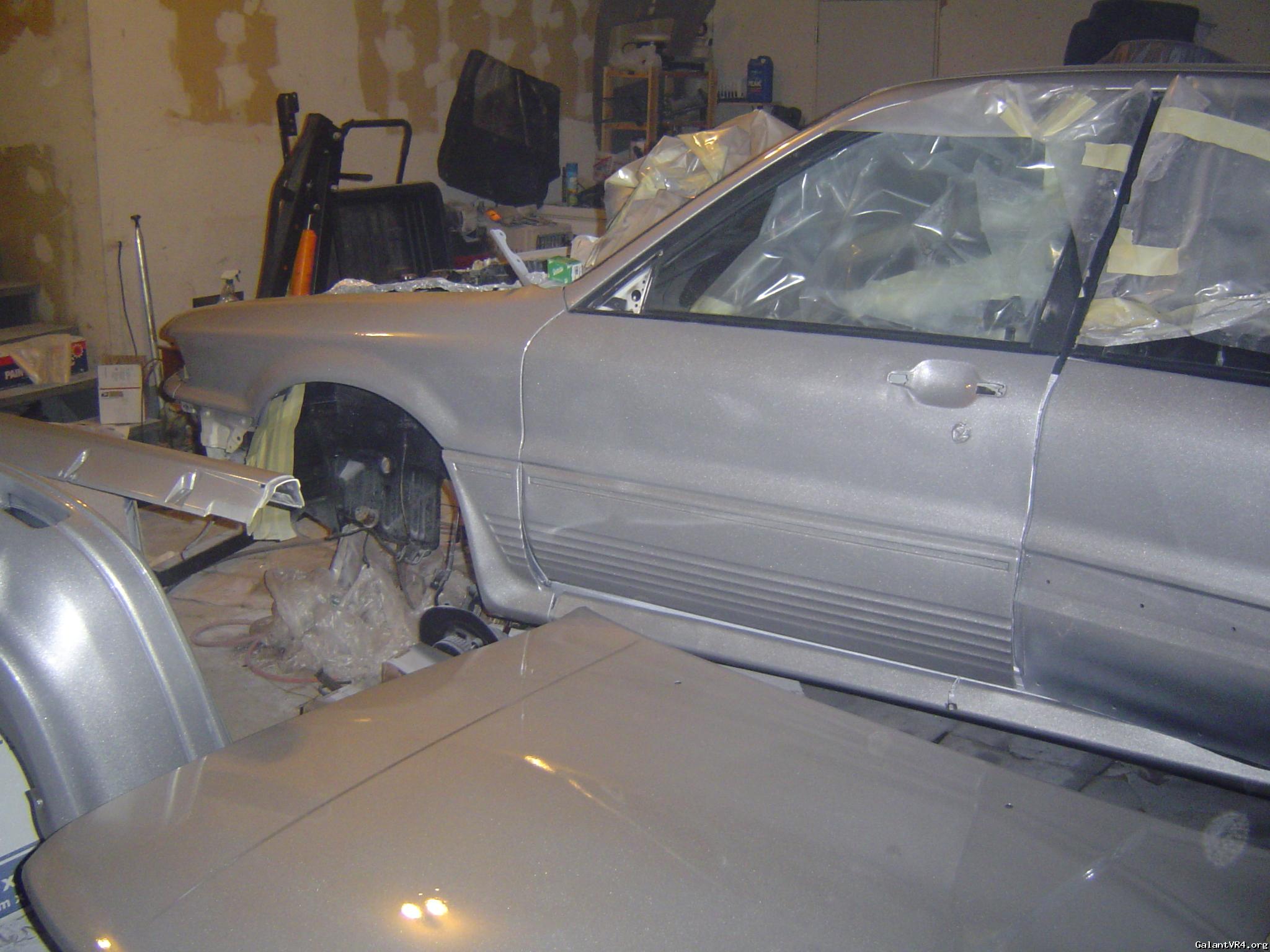

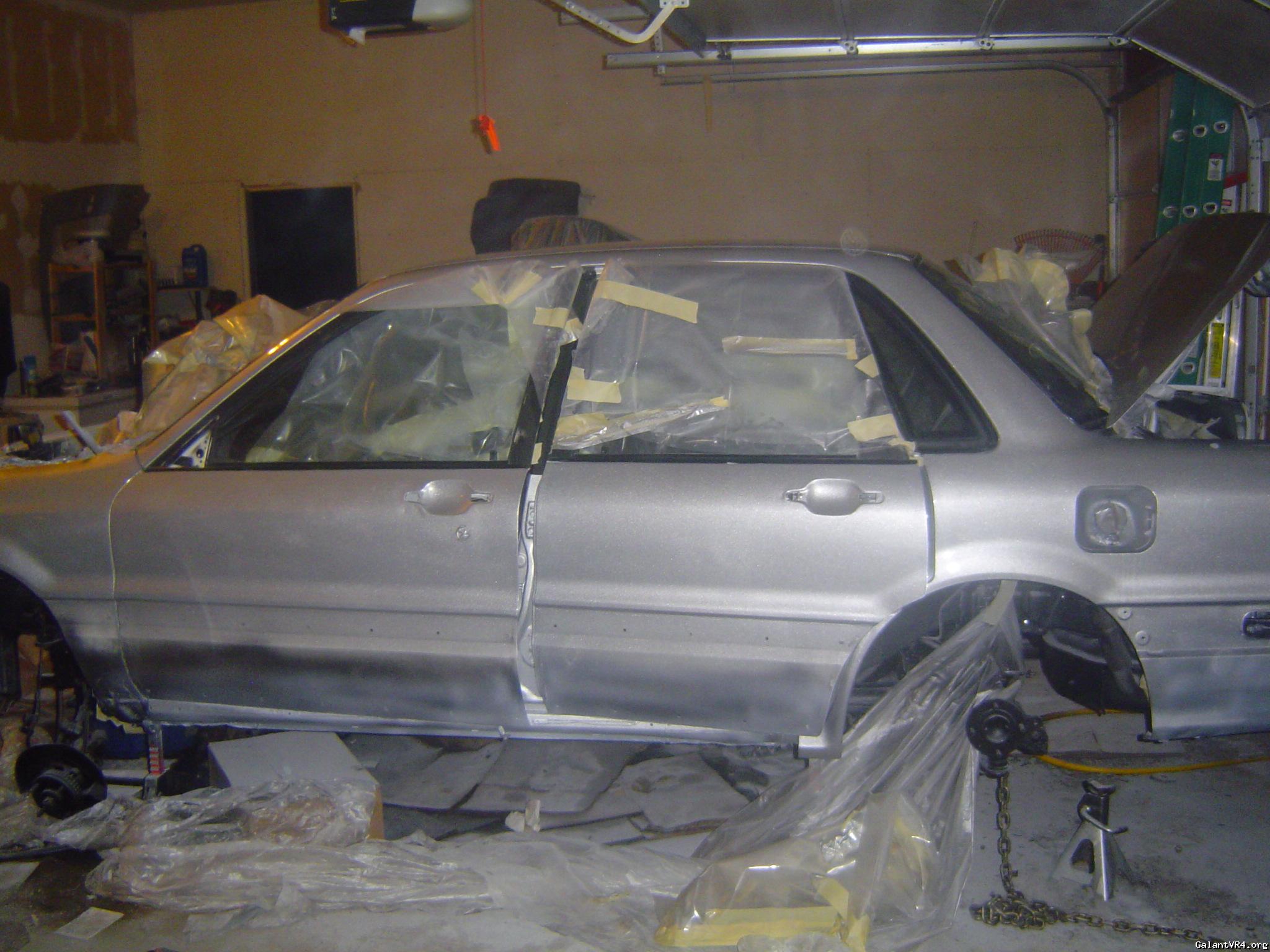

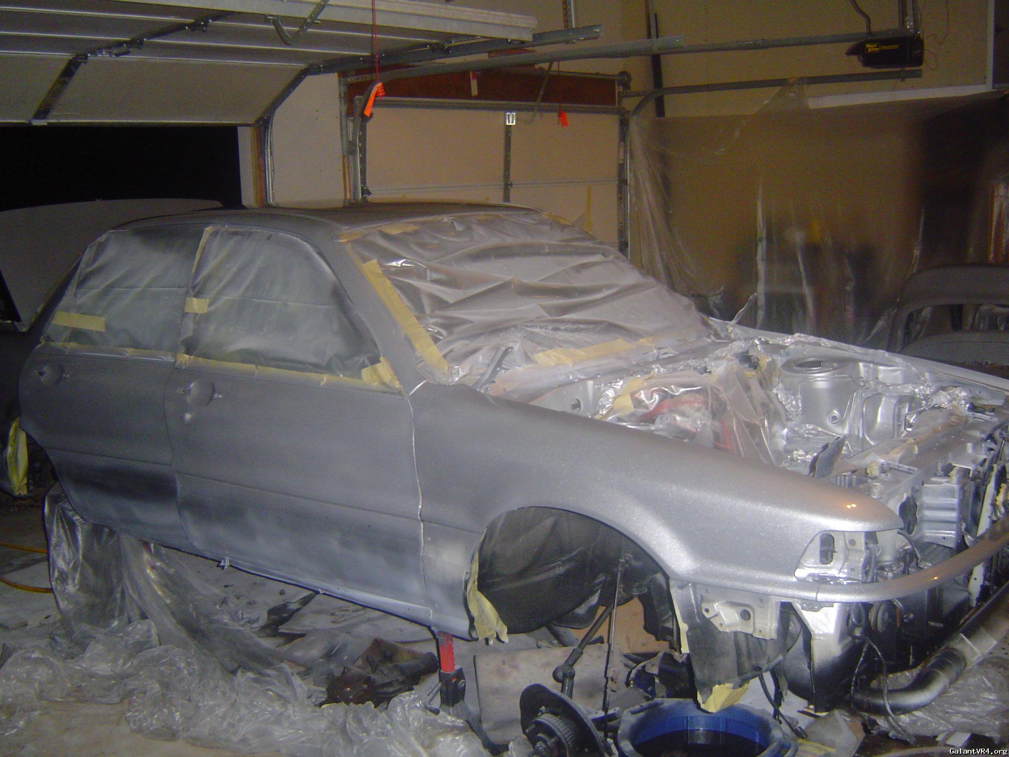

I took Thursday off as it was 80 degrees and low humidity to paint the car. Twelve straight hours with my hvlp gun was pretty tiring. This is the second car I've painted and this time I got the clear to lay down pretty smooth. I do have some runs though that I'll be fixing. I also forgot to paint the mirrors so I've got a little more painting to do.
I thought it was too sparkly at first but once I pulled the tape I'm pretty happy with it. These photos don't do it justice so I'll probably take some tomorrow in the daylight. I hope I don't get in too much trouble on here for the non-stock color!

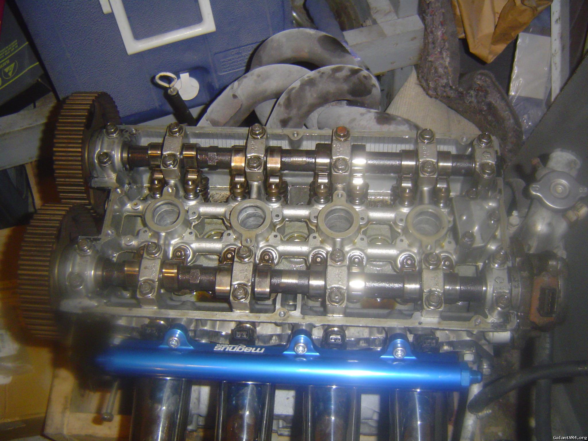

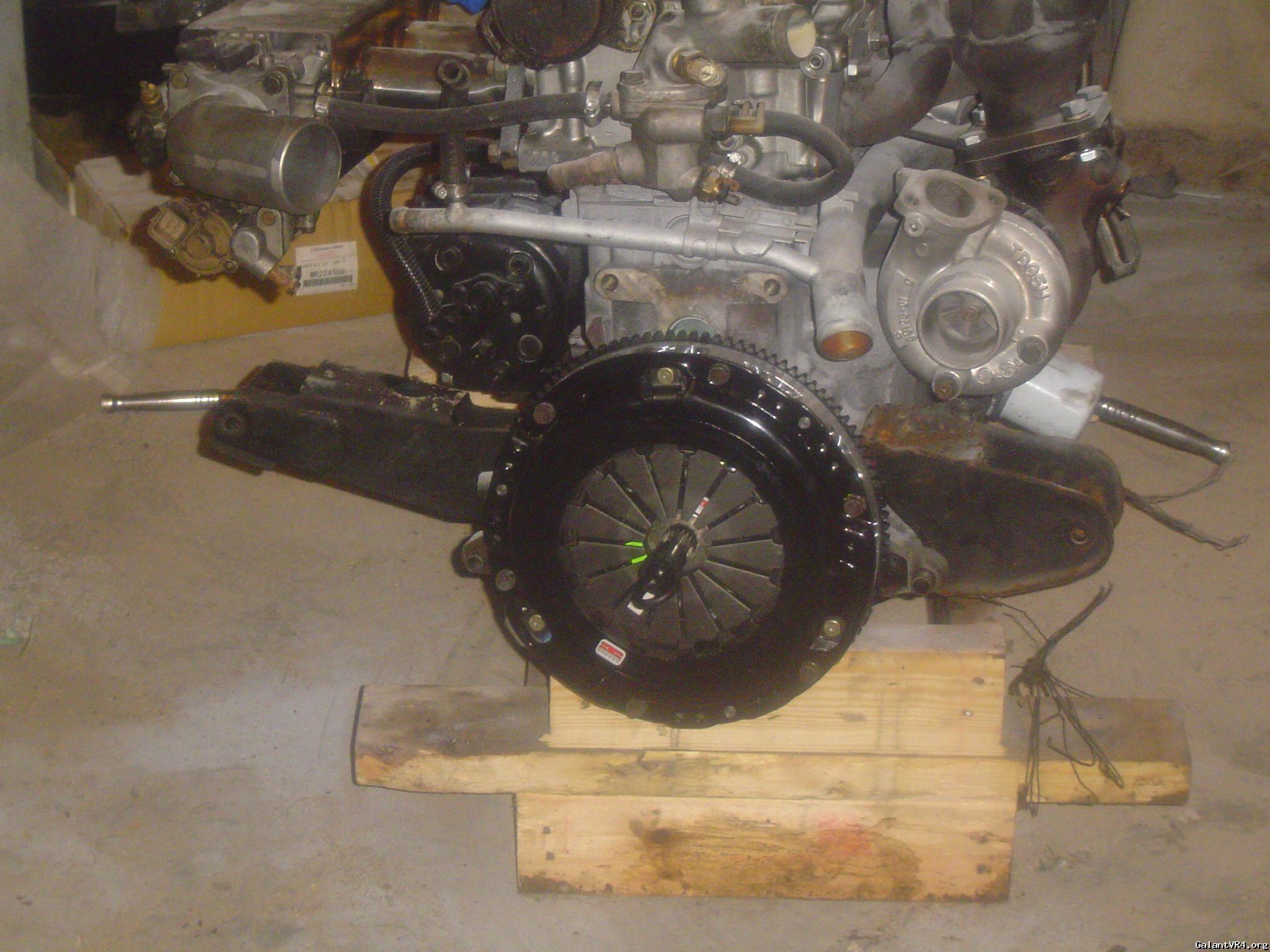

I've managed to get transfer the 264 cams from the old engine to the new one. I also installed some L19 headstuds just to be on the safe side. Hopefully this weekend the engine will be back where it belongs.

Yeah, it's metallic silver that I think looks pretty good so far. I saw one on here somewhere that color that I liked a lot so I went for it.

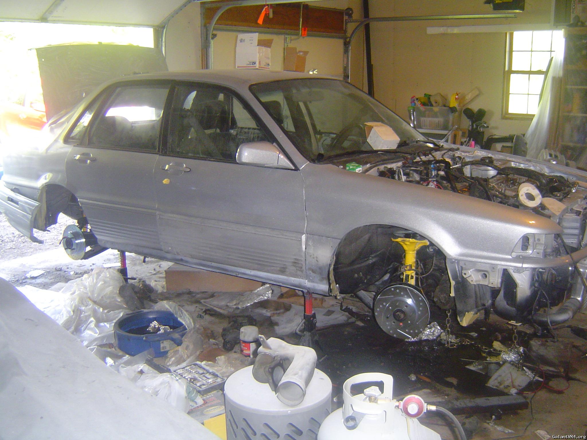

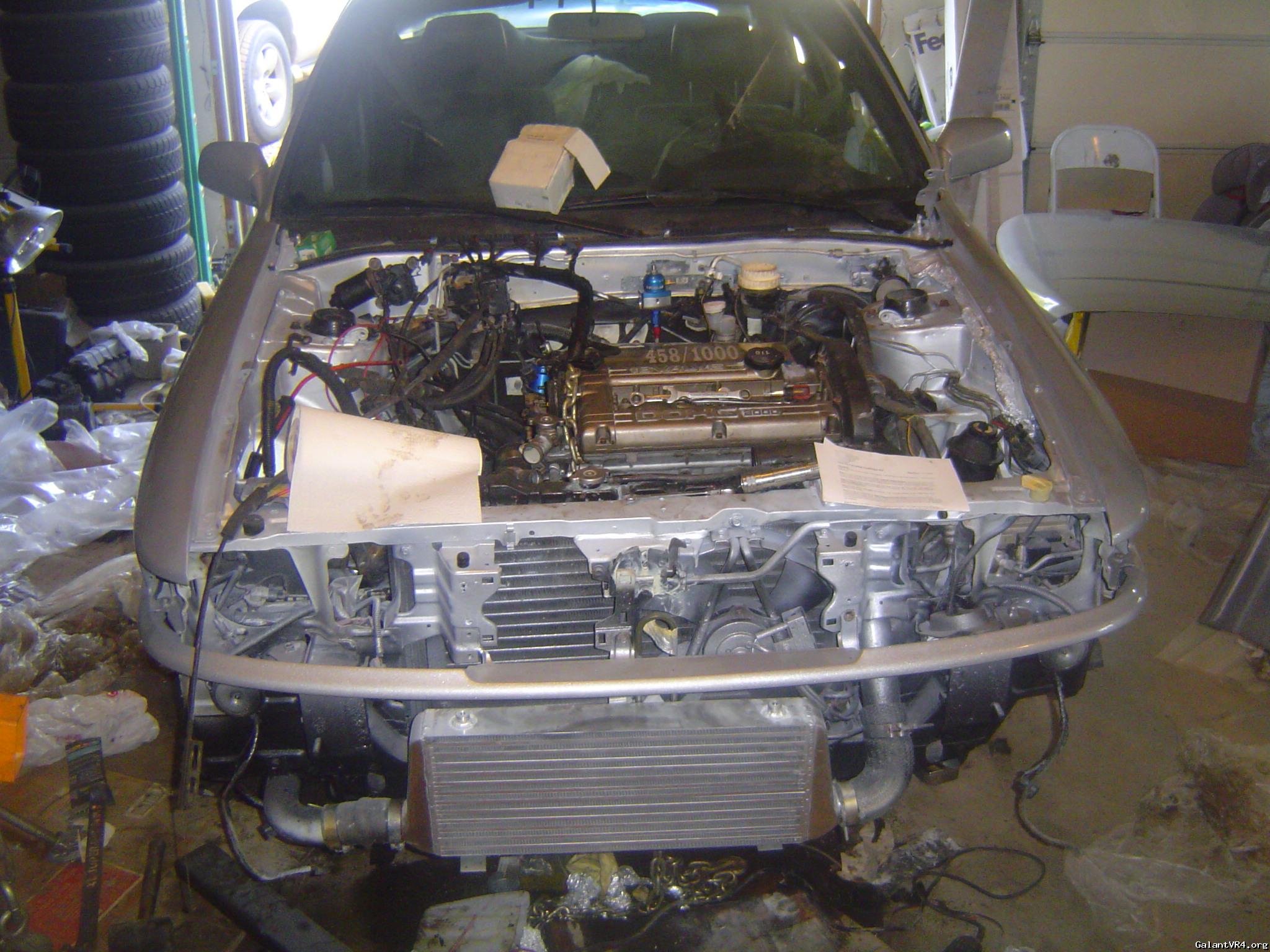

I finally got the engine back in Friday night. Installed the Fidanza flywheel and Competition stage 4 clutch. Bigger front mount is on as well. I was up until 3 am but got it done - couldn't start until my sick daughter went to sleep at nine. Still had to have a beer after I was finished. All shock assemblies are in, once I get the calipers painted I should be able to put wheels on it and drop it.
