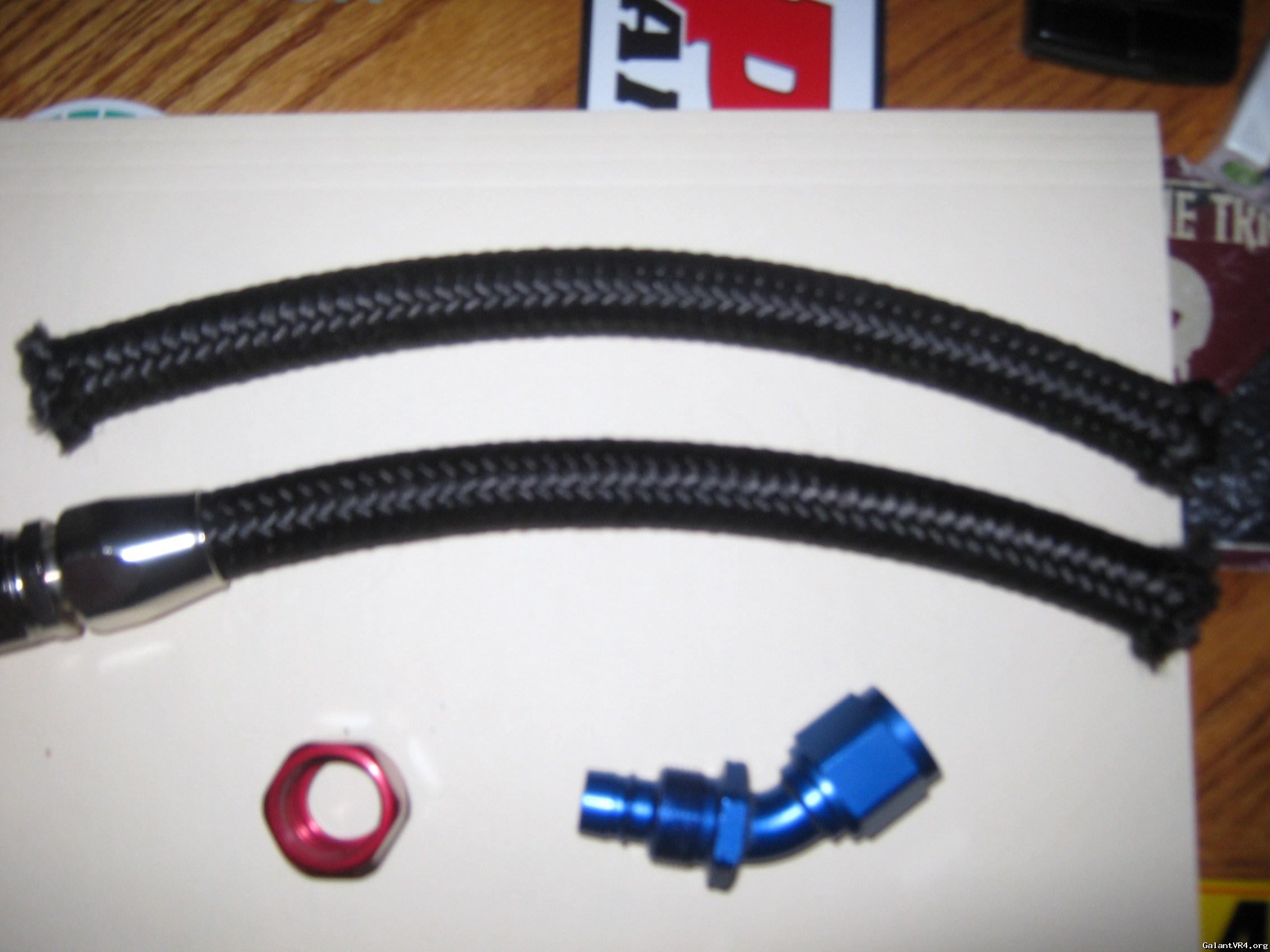

Before this thread started I had already got the wild hair to do this mod. Tonite I scored some fittings and some Kevlar reinforced tubing. Its supposed to be great for oil drains and very flexible as well. Anyone else have experience with this?
You are right. I forgot to make that edit. Its Nylon braided not Kevlar. Besides that, its rated to 350psi and 300 degrees. It should work out all right.

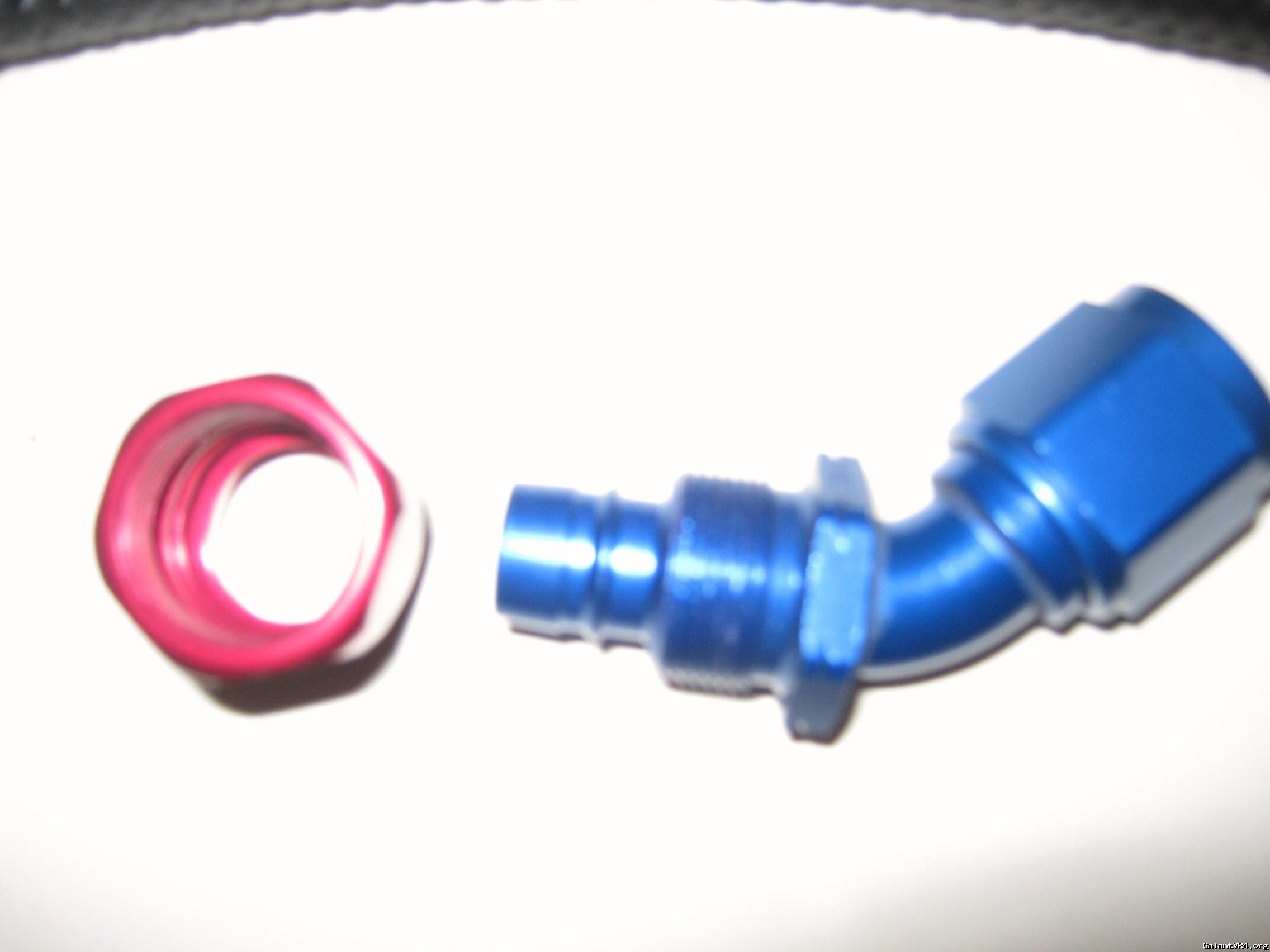

Ya, there's no collets, (I think thats the word). The collar part of the fitting right-hand threads onto the tube and the other one slides in and clamp it down. Thats it.
I dont know what retail price of the tubing is. I got the bro deal. But the fittings are kinda spendy.
