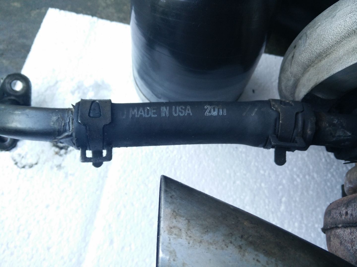

People get all horny for the braided replacements but I'mnot a fan of the price.And the fact that the factory one lasted 20 years and 200k miles makes me just want to run one. All I did with mine though is cut out the flex section and replace it with Aeroquip pushlock hose. Has worked great and leak free for 8 years now.

I've also had luck just reusing the ends that mount to the pan/turbo and finding a quality rubber hose with the same bend. I even went as far as welding a bead on each end with my Mig welder. Then I purchased some smooth clamps, the ones that don't dig into the rubber. Some may scoff at this but it was quick and easy and I never had an issue.

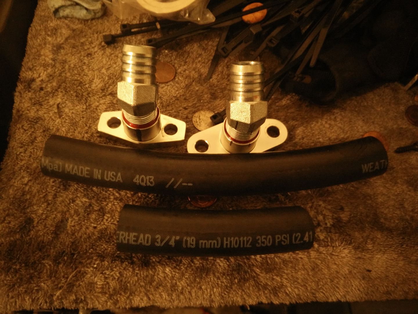

when i put the 2.4 in my car i noticed the flex leaking. so i used some oil/fuel grade hose i got from Napa. also used the same stuff on my CRX when i put the 14b on it. both cars worked very well with it. so i bought some more for the new turbo kit.
just dont use water/heater hose, its temporary at best.

This. Fastest, cheapest, easiest way to repair this issue. Works great.

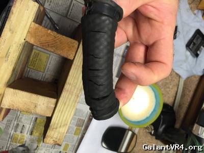

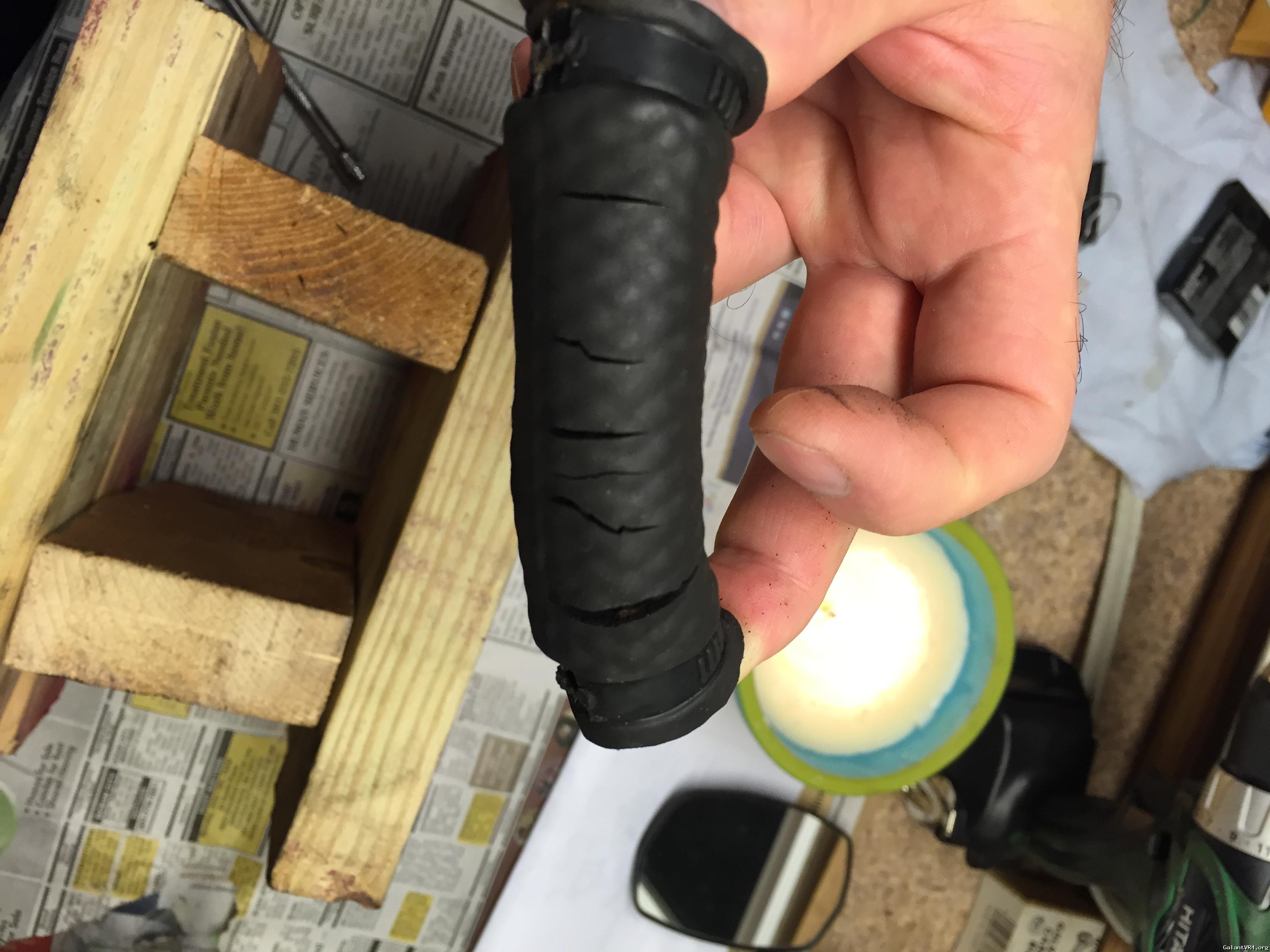

^^Just replaced my "heater hose" oil drain after 3-4 years because it started to leak a little bit where the worm-gear clamps began to cut into the rubber. Yeah, I know I should replace it every 1-2 years. But the point is, even with the exposure to heat from the non-stock manifold and DP, it is daily driven and lasted a long time.

It's definitely not optimum, but it worked for a couple years. I think it lasts because it does not move and is not under pressure. But as evidenced when flexing, after that long near the heat it did take some damage...

Plus heater hose isn't rated for petroleum, so the oil was eating at it. Get some hydraulic hose rated for oil and your good.

i used spring clamps on the FP Red oil drain. worked just fine. but i think i put a light coating of Hondabond on the pipes before sliding them in also.
the FP Red drain. been on the car for 2.5 years i think. thats with DD here and there, not JSB time.
pretty sure this is the same stuff but this is 3/4 for the T67. think the stock pipe was 5/8. but that part number should help you or your parts guy track it down?
