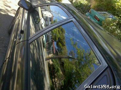

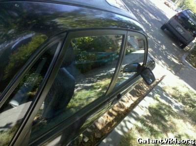

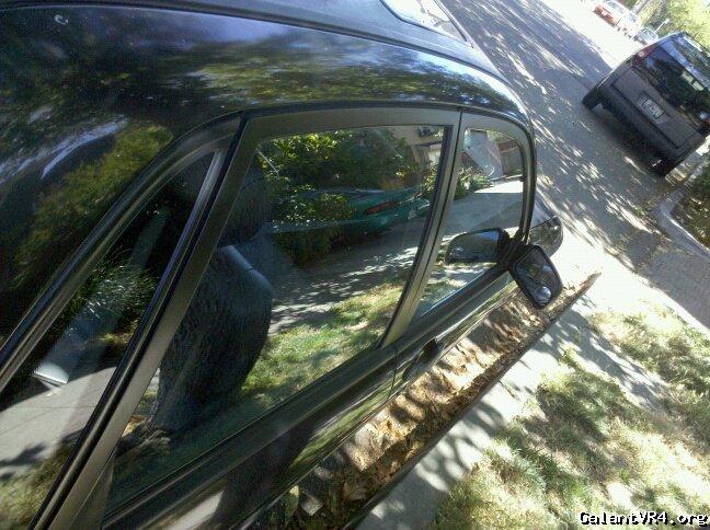

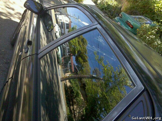

i sanded and flat black primered. then used a rattle can i got at OSH litterally called Trim Paint. and it looks awesome. could use touch ups here and there but its nice
before
after
