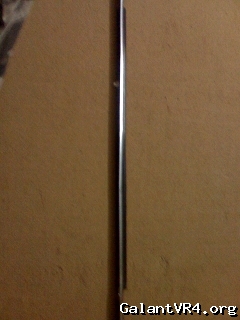

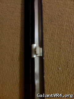

I didnt take off the door handles myself so cant say anything about them. As for the trim pieces, there are these clips under it which attach it to the door, u would have to pull the trim very gently with a flat screw driver or a knife.

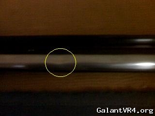

If you pull it too hard you will end up with small dings like this on the trim

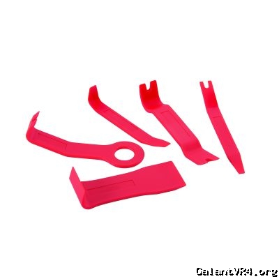

3.) utilizing mini trim tools (use plastic) Matco tools offers it part # MST4489A $26.10 or Harbor Freight $5.00
4.) Gently pry on the middle trim portion (whether its top/bottom/left/right is irrelevant) utilizing the widest/biggest trim tool in the set. The trim is fastened via plastic clips that cling to the lip on the starboard side of the trim. So as you pry, pry "outward."
5.) When you reach the clips x 4, you can slide them out of place, in either a 1mm or 2mm in either direction simultaneously lifting outward as the clip x 4's lip rests on the plastic clip. This works so long as you remove a portion of the trim and or lifted the trim out of the plastic clip
