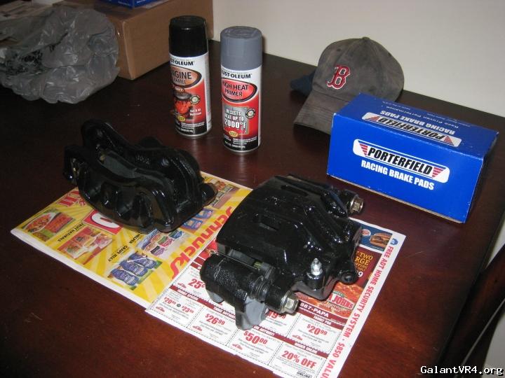

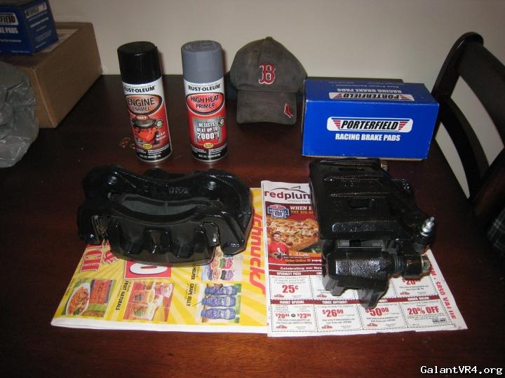

I applied three coats of primer, and three to 5 coats of paint. Here's the results: (Note, I didn't bother to paint the back side of the brackets. No one will see that anyway)
I think they came out pretty good, and hopefully they'll stay looking pretty nice, with the blank paint.
