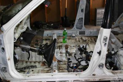

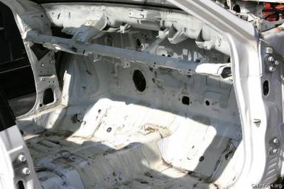

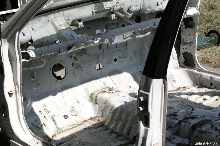

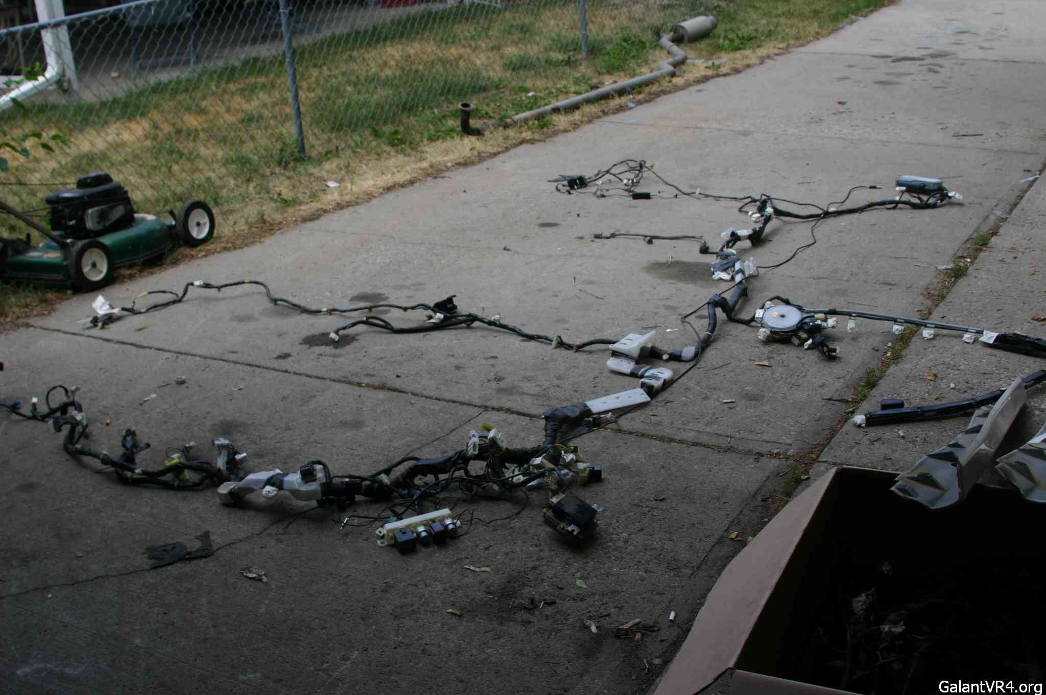

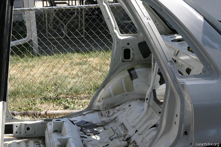

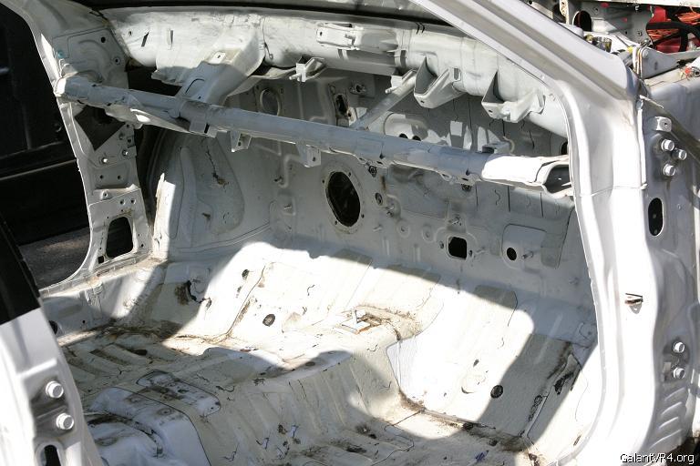

Jeremy - the car pretty much needs to be stripped to the bone for media-blast. NO wiring harness, dash, etc. That blast will kill stuff quick...make sure its a naked carcass before it goes out to him.
Also, does this place have a rotissiere?
Take pics, BTW!
Yeah yeah KC I know /ubbthreads/images/graemlins/grin.gif

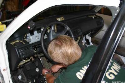

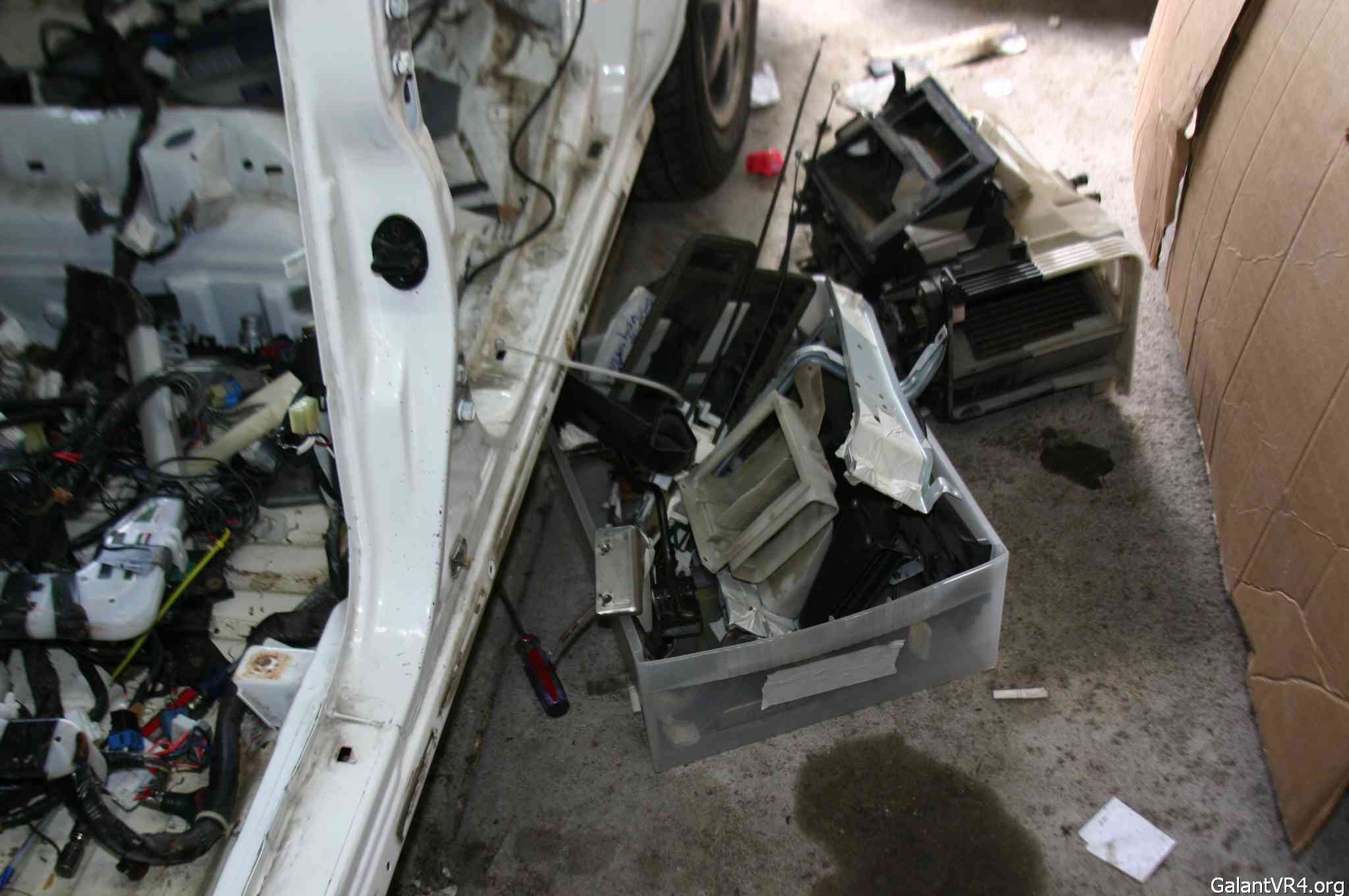

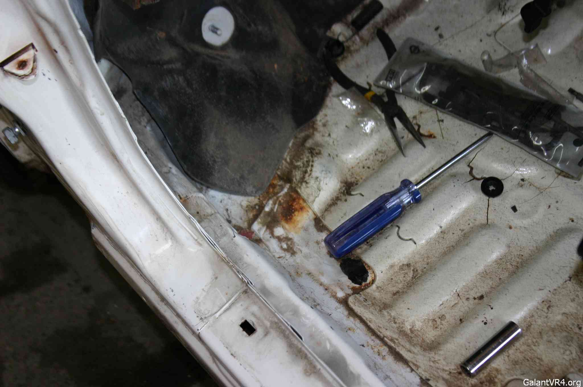

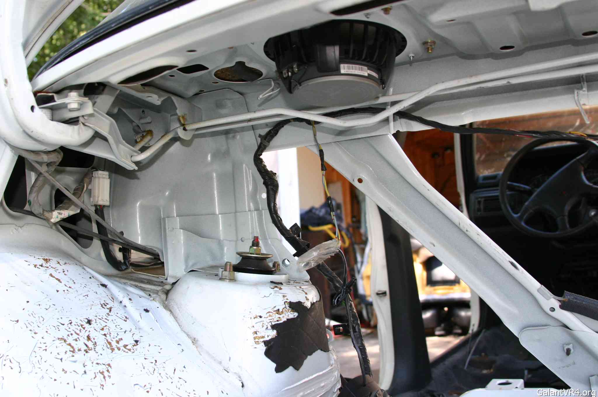

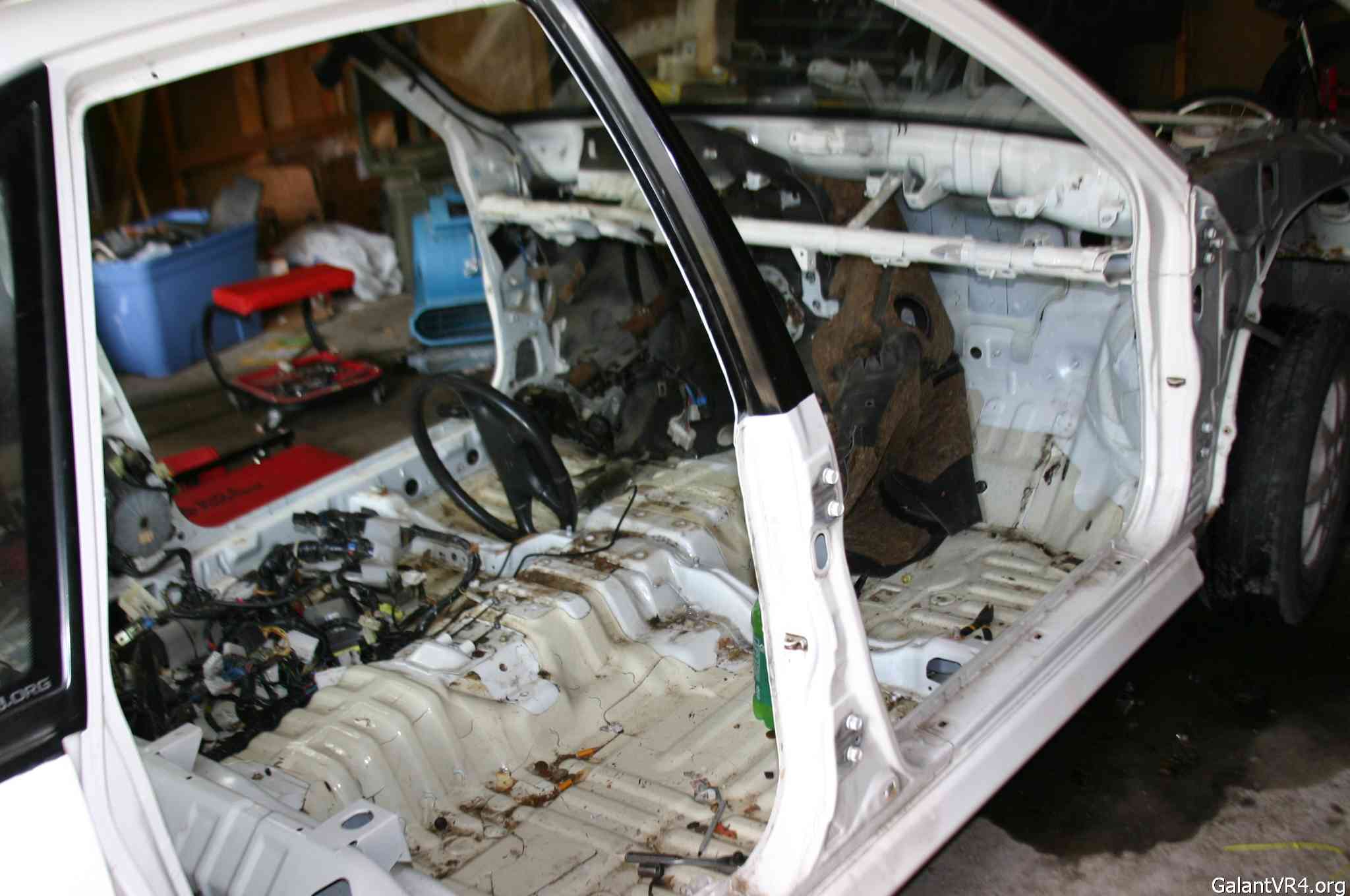

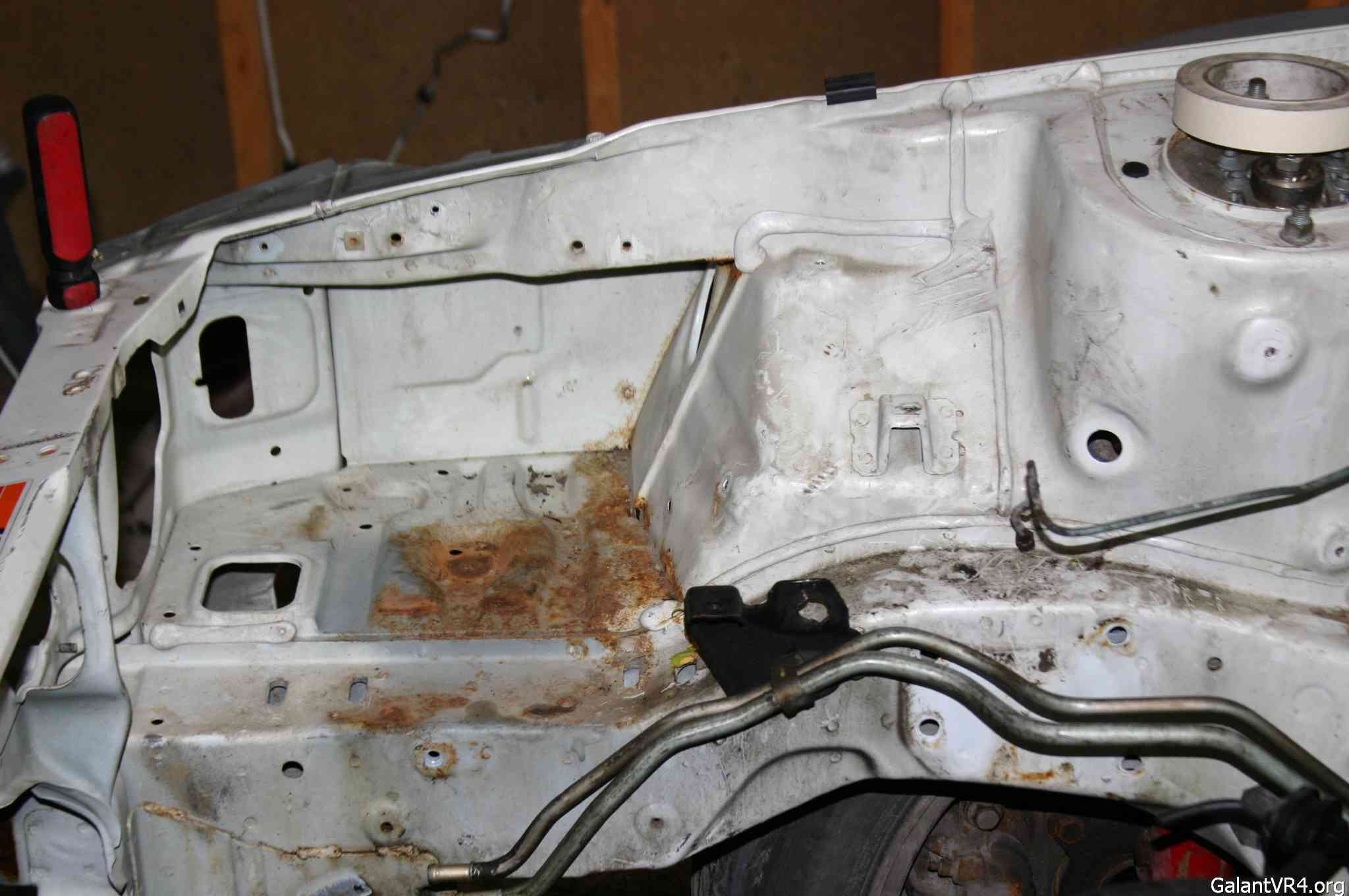

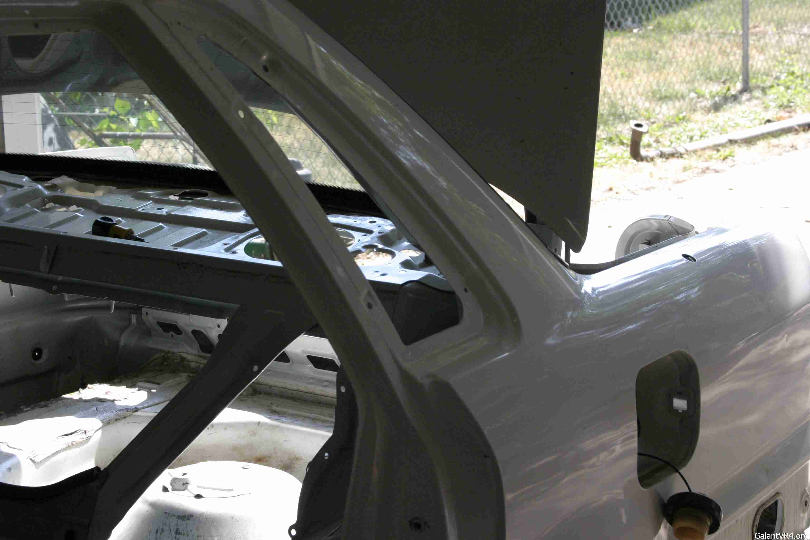

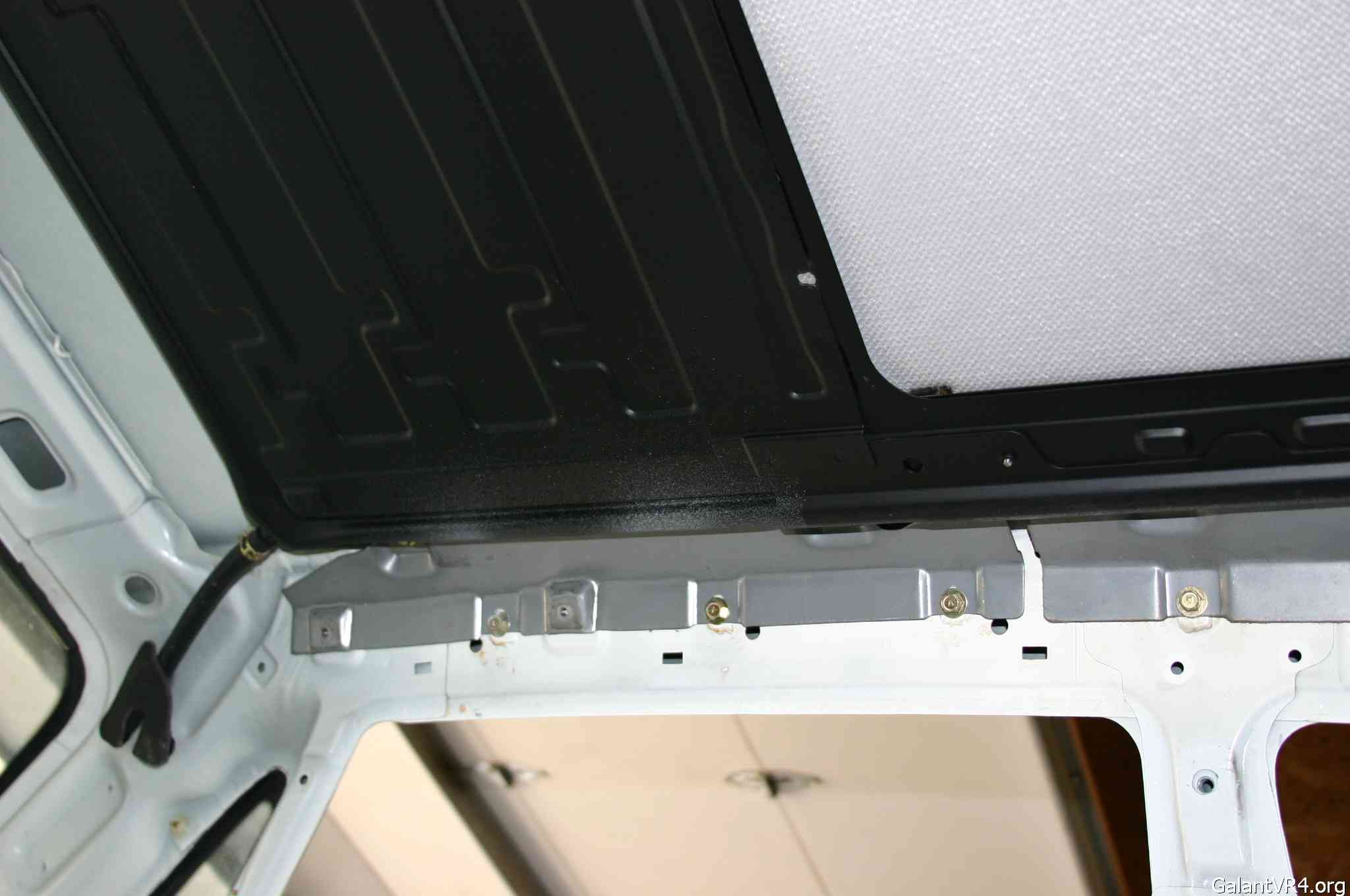

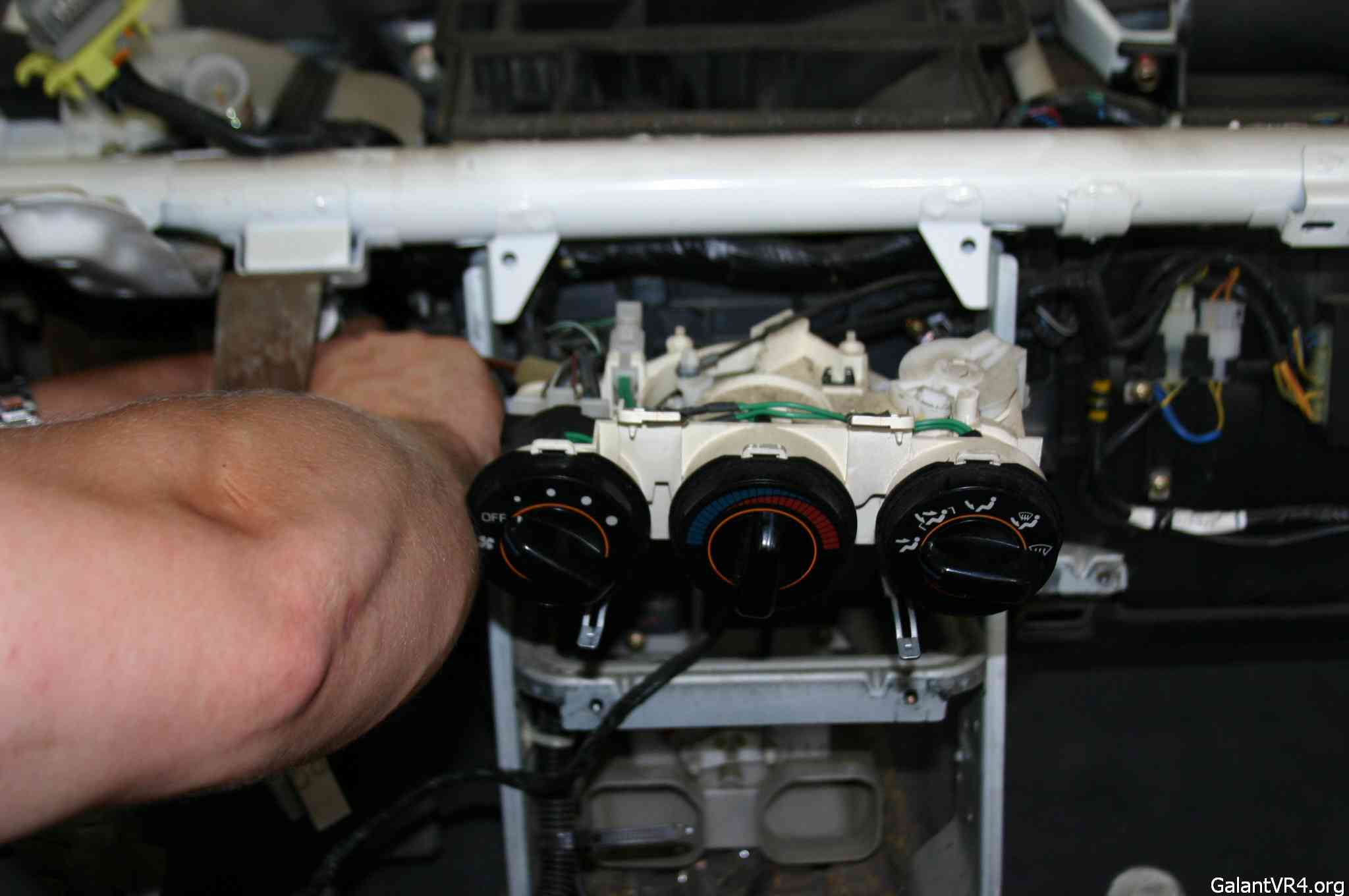

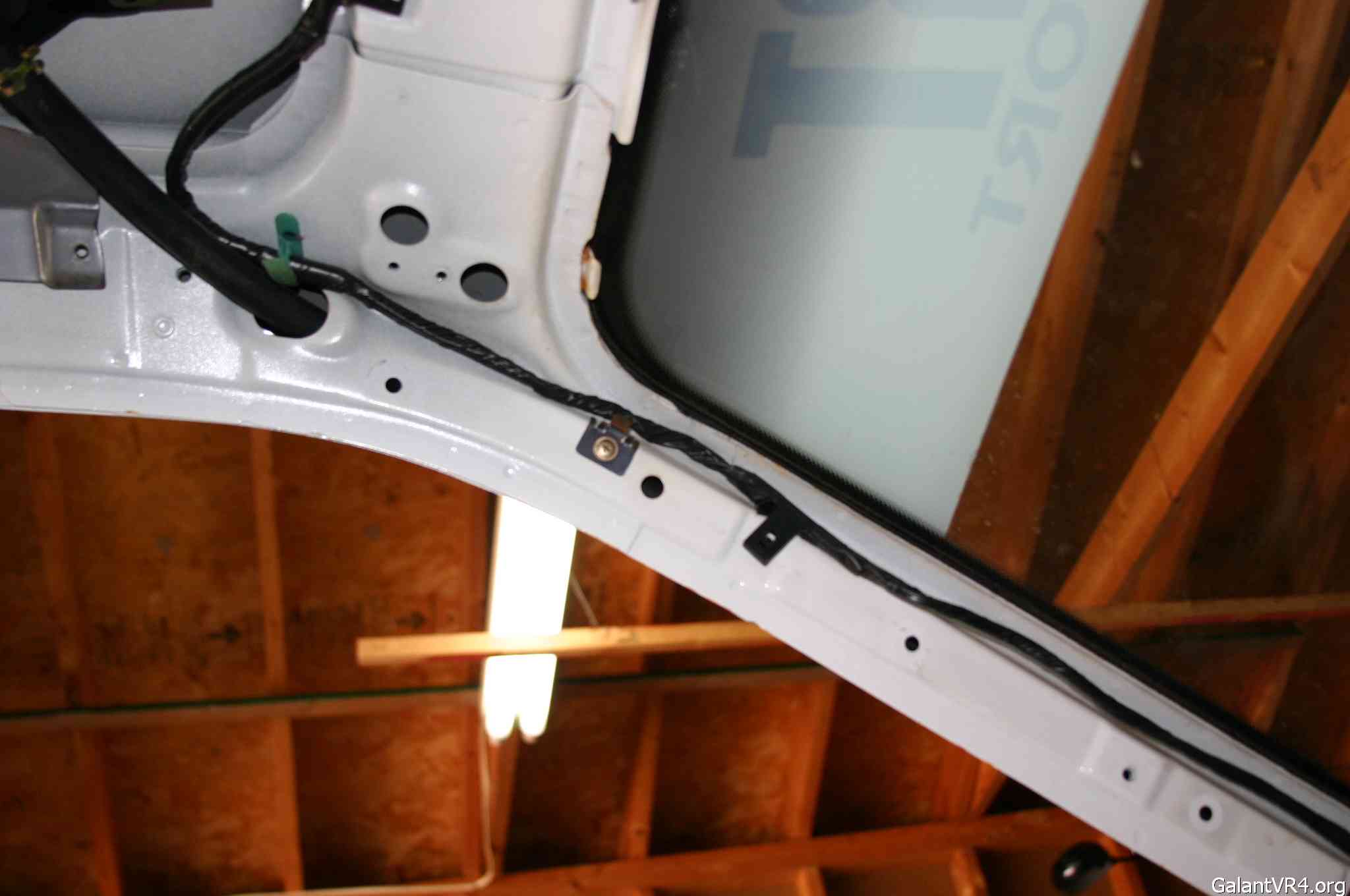

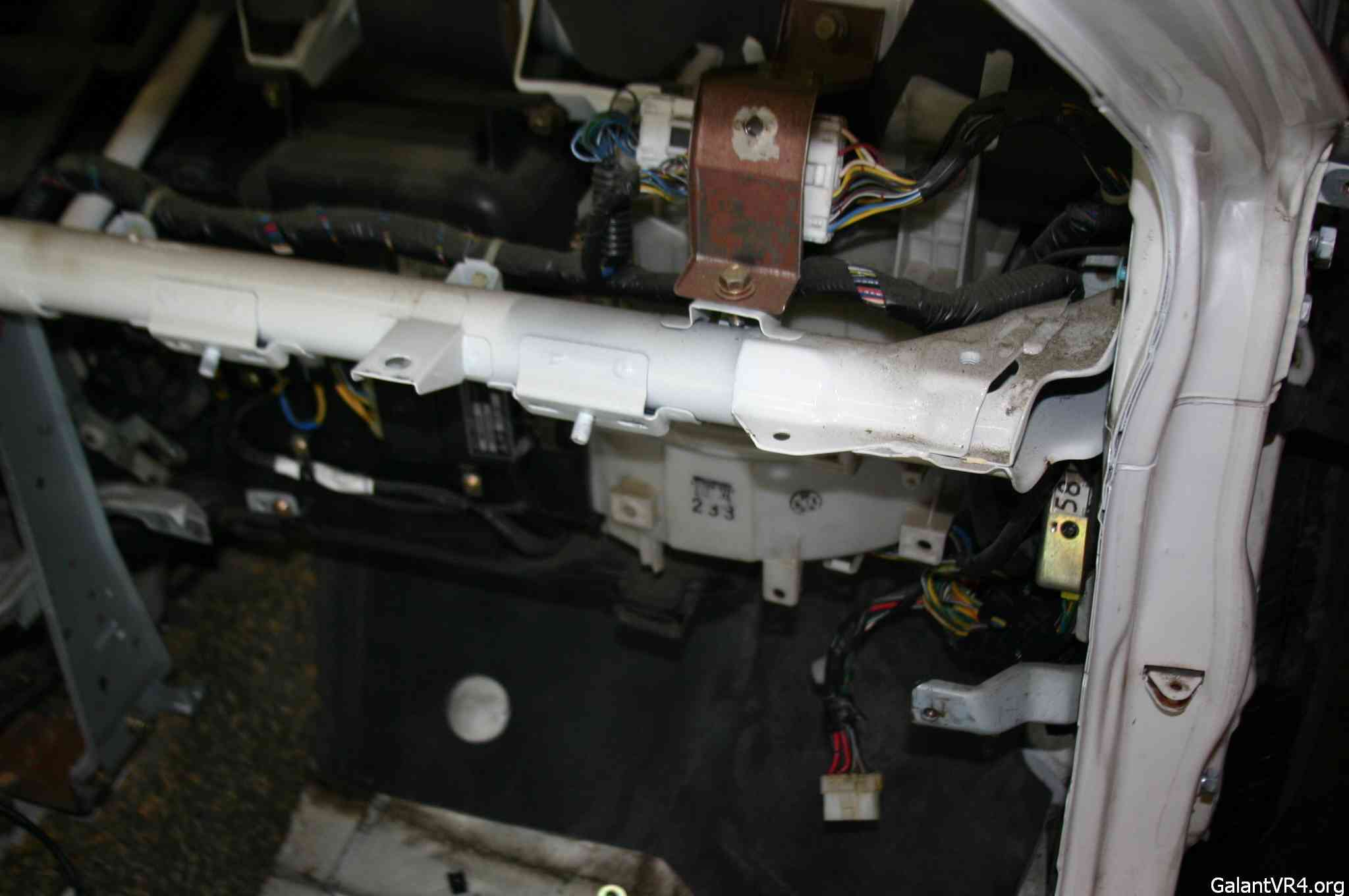

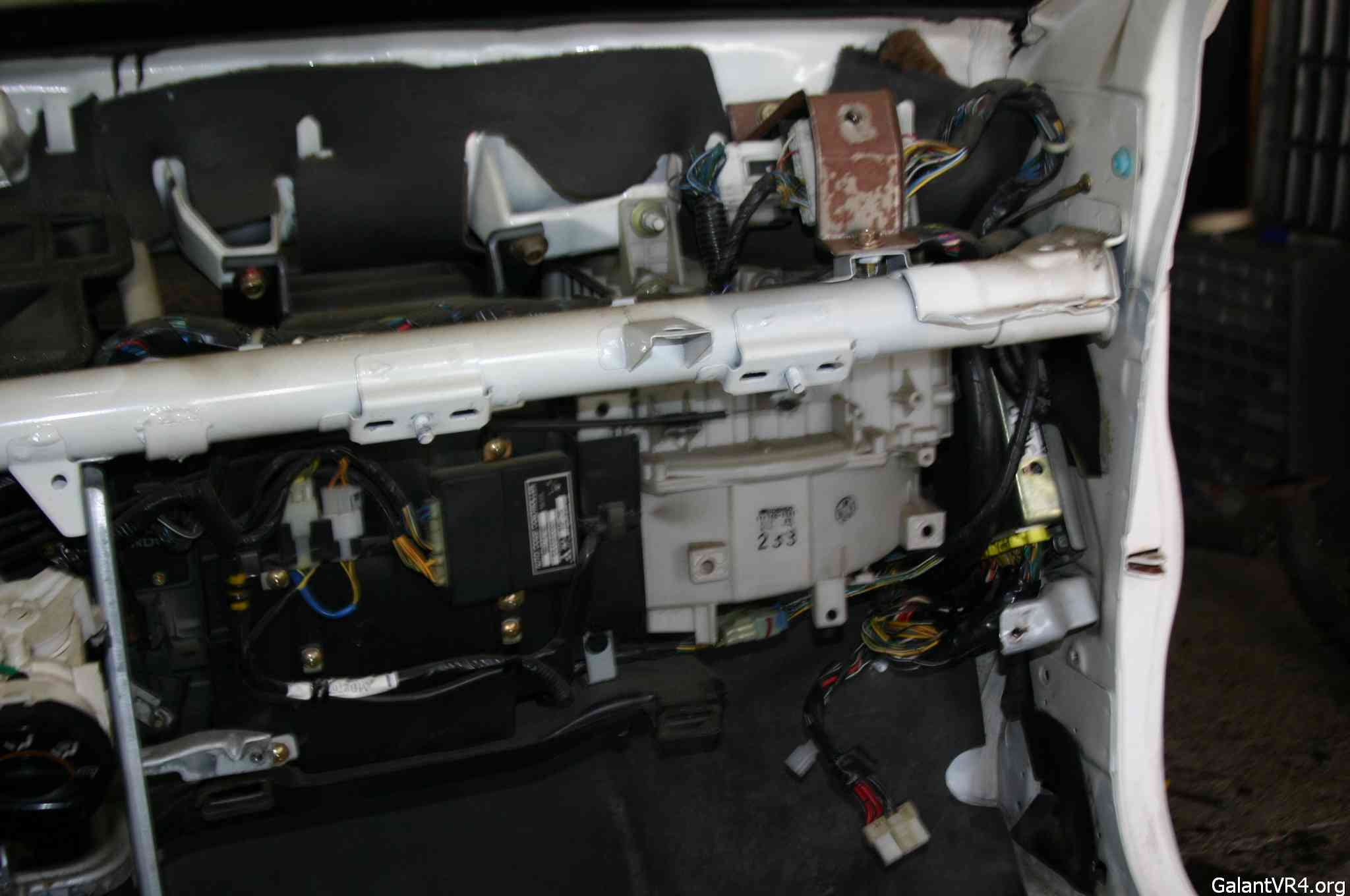

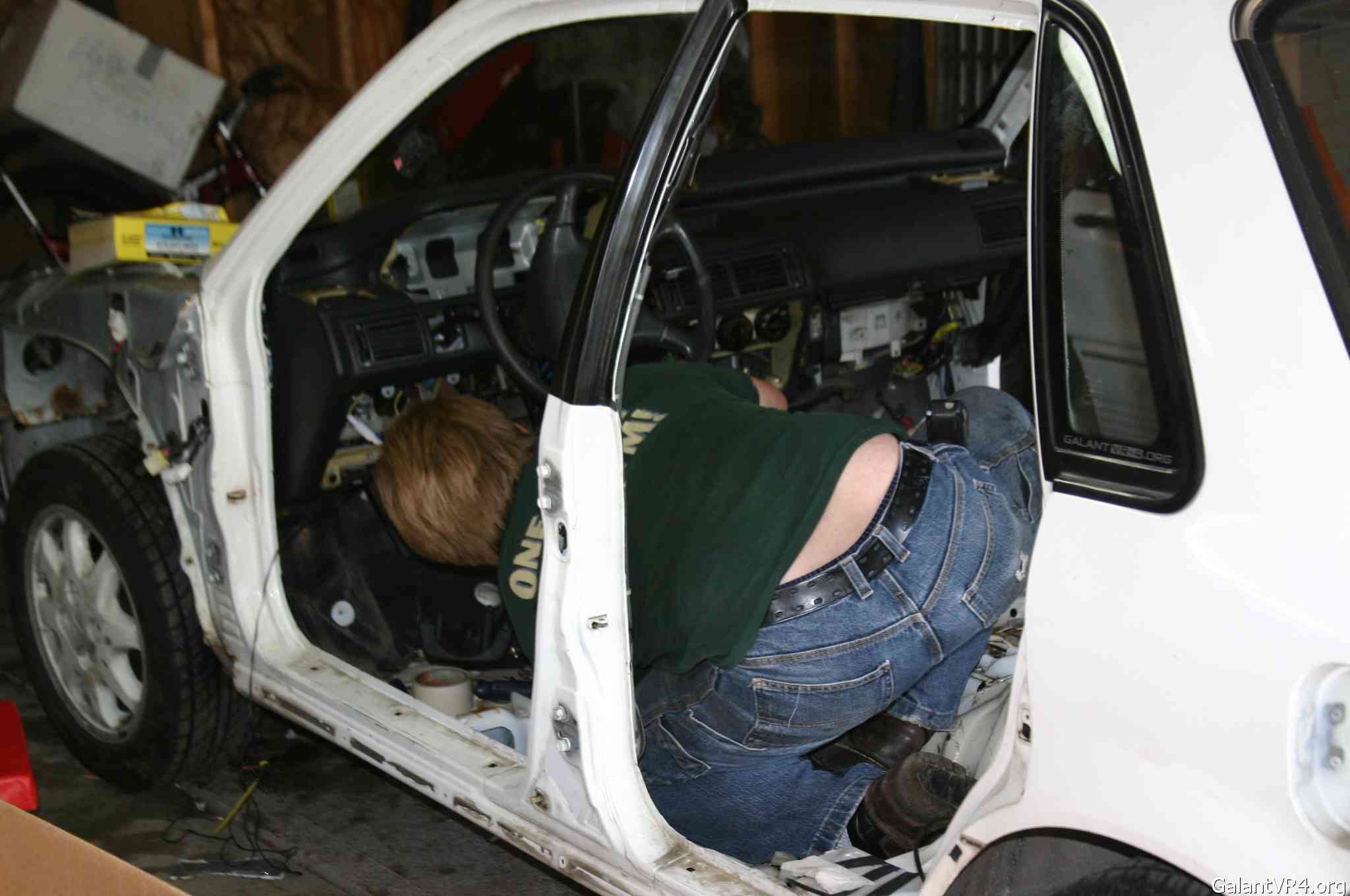

I Am taking every thing out of the car. It will be just a shell when it goes off to Mediablast. I dont know if they have a rotissiere KC I might have found one though.

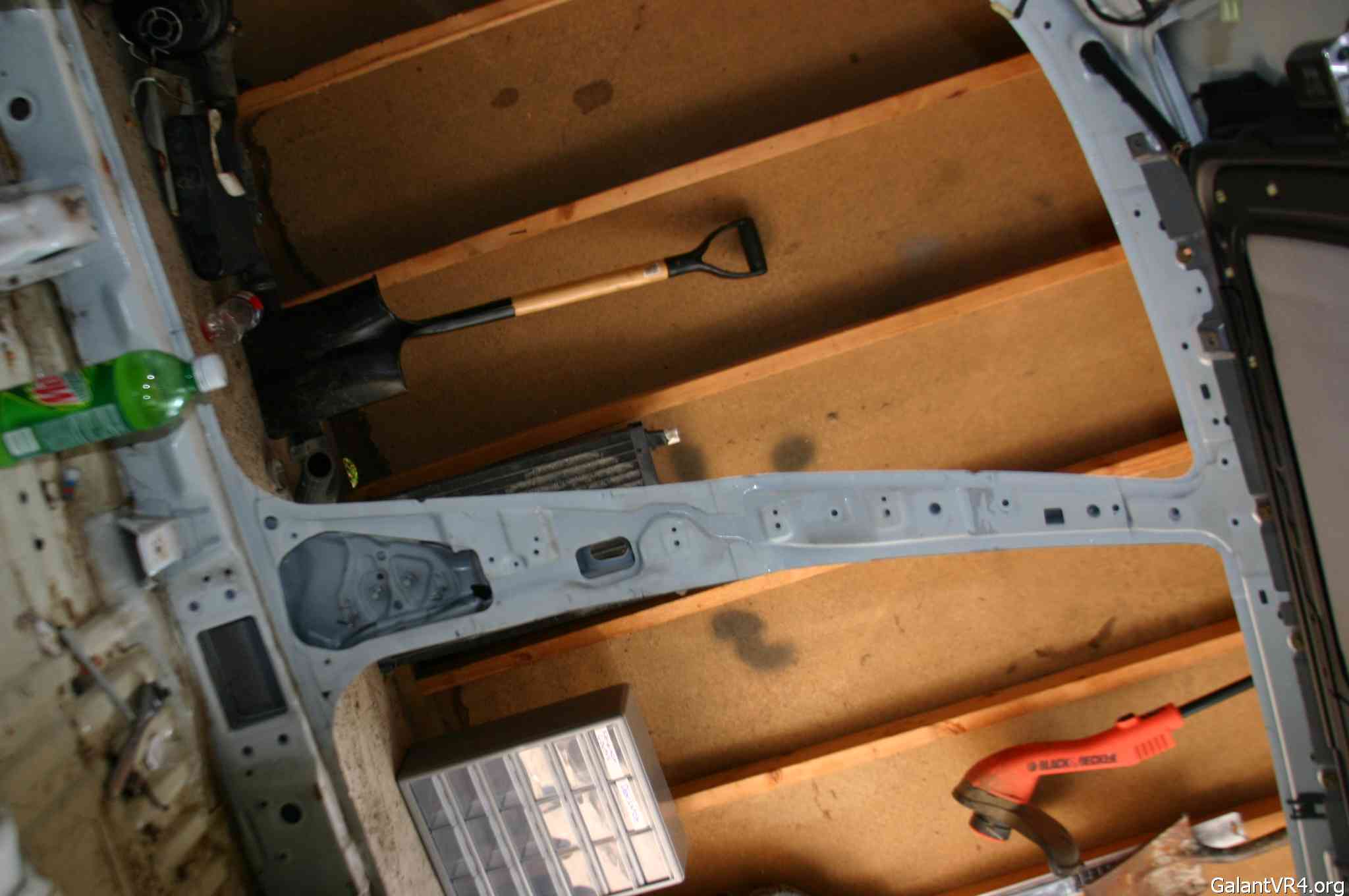

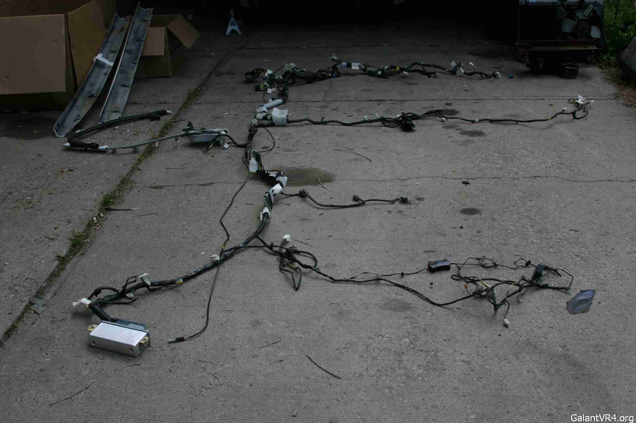

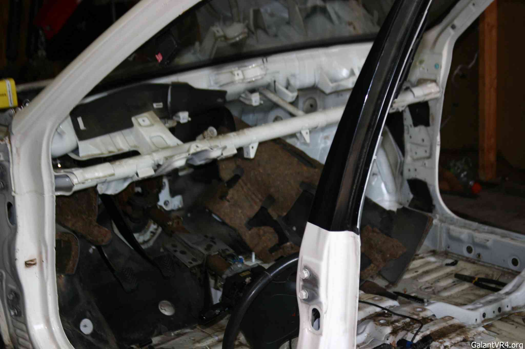

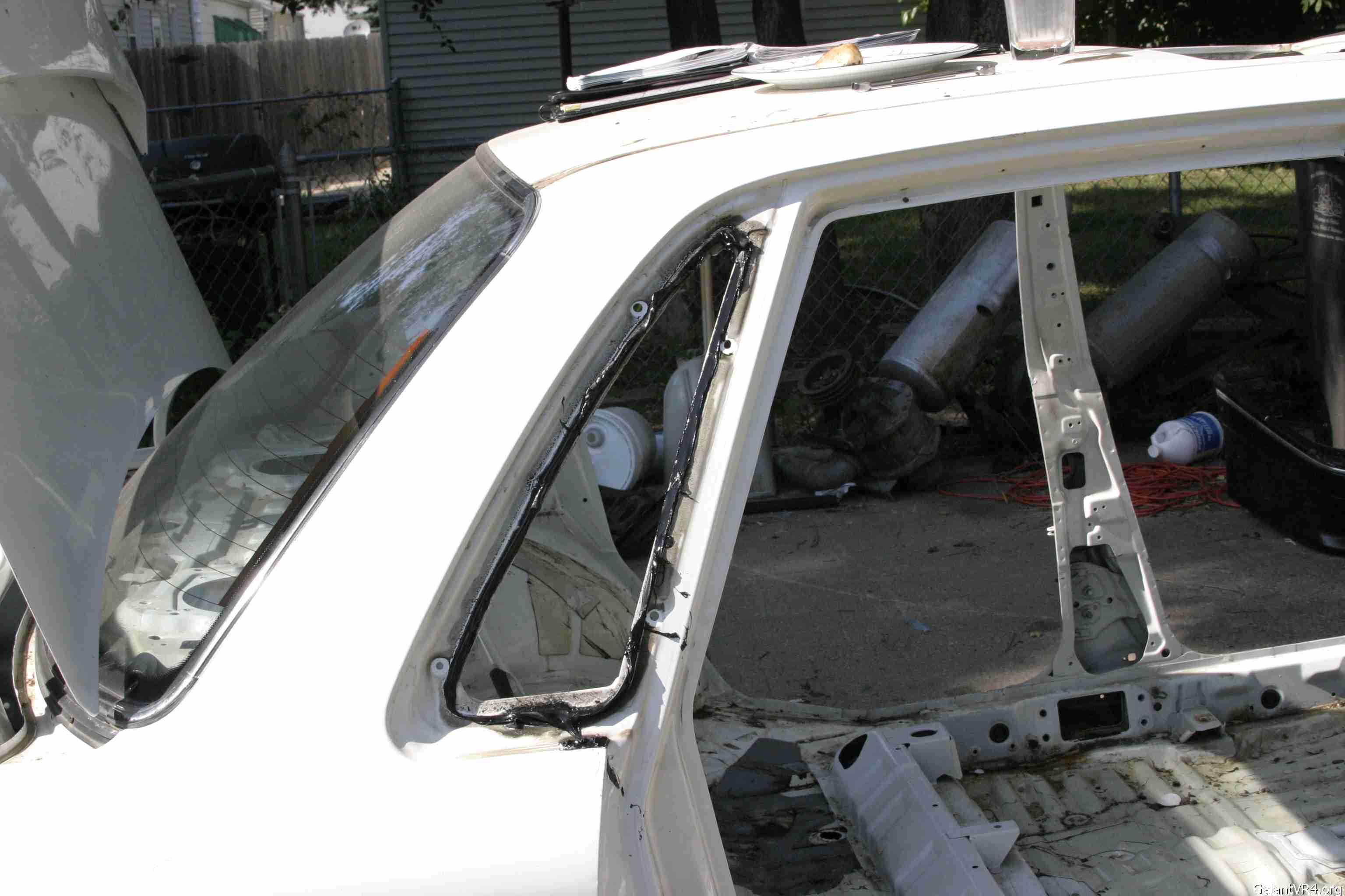

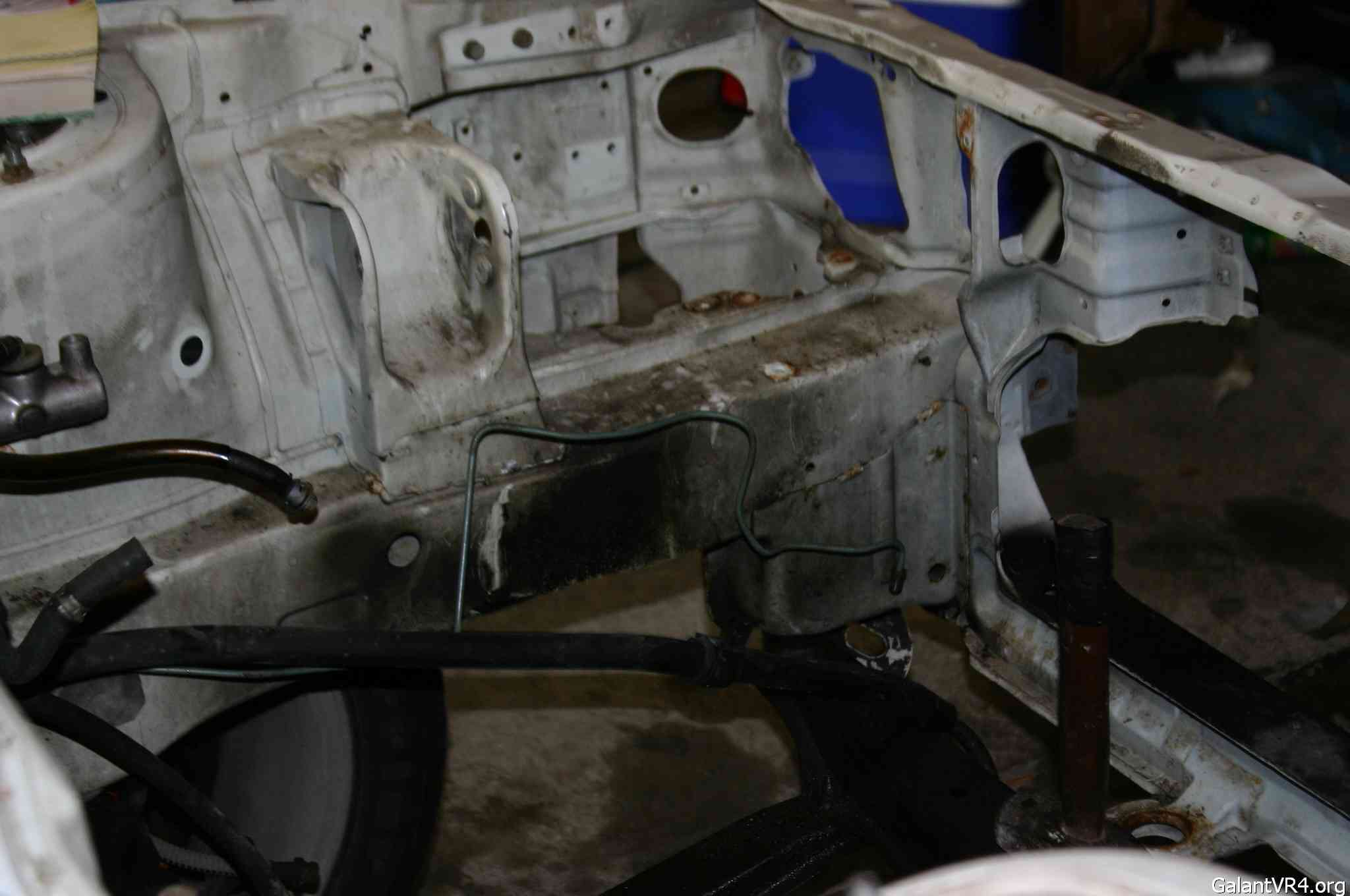

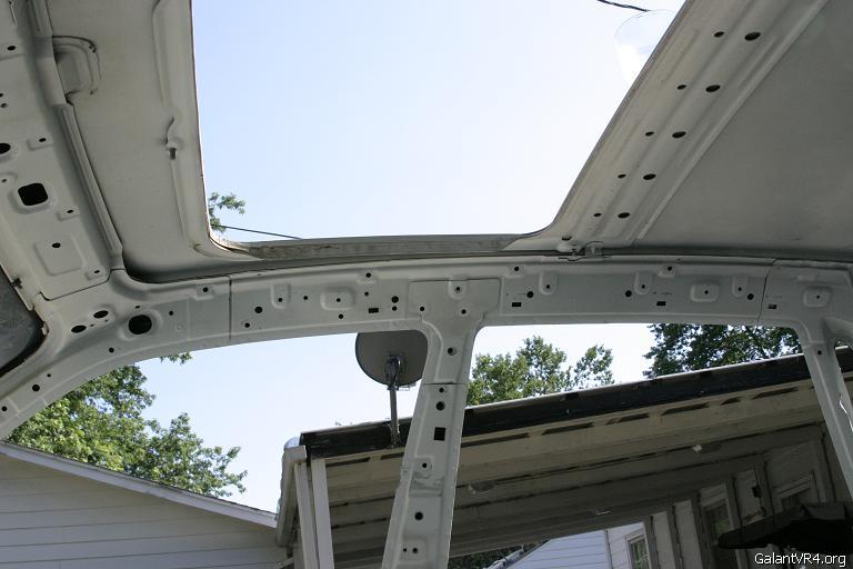

Here are todays new pics as you can see its getting even closer to getting Blasted /ubbthreads/images/graemlins/grin.gif

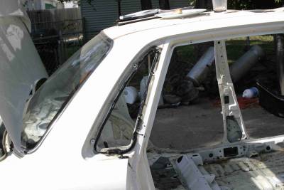

Glass too. Get it outta there. And paint or replace that trim while you're at it. /ubbthreads/images/graemlins/grin.gif
Yeah the guys at the paint shop are going to do that before they MediaBlast it.

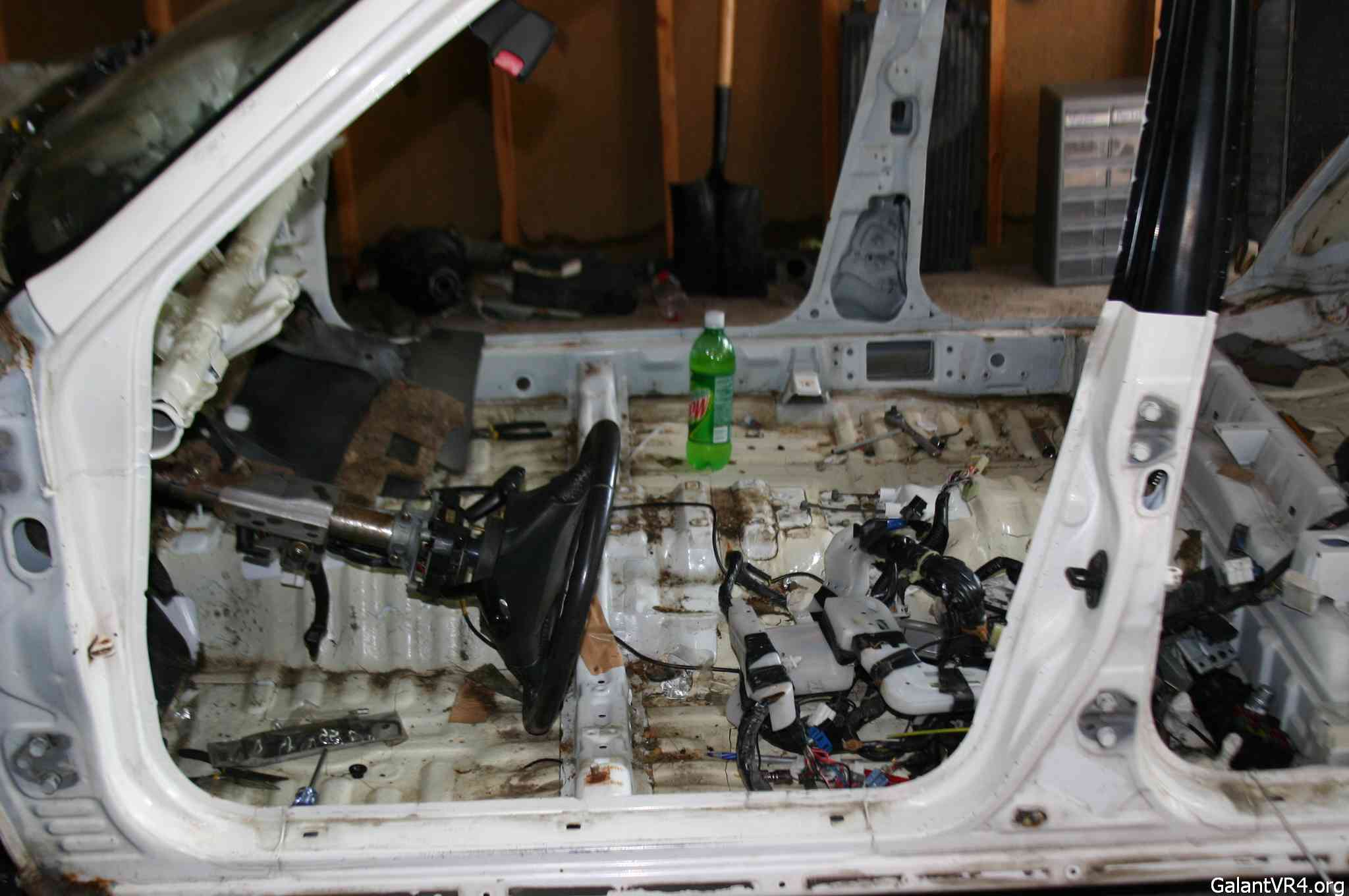

+1 I would have absolutely NO hope of ever getting the car back together if it looked like that.
G
Feb 24, 2004
8,896
zompton
dam bro, are you labeling everything you take out ? all the screws & bolts ? i would forget where everything goes /ubbthreads/images/graemlins/confused.gif
jcgalntvr4-244
Nov 9, 2003
3,135
DesMoines Iowa

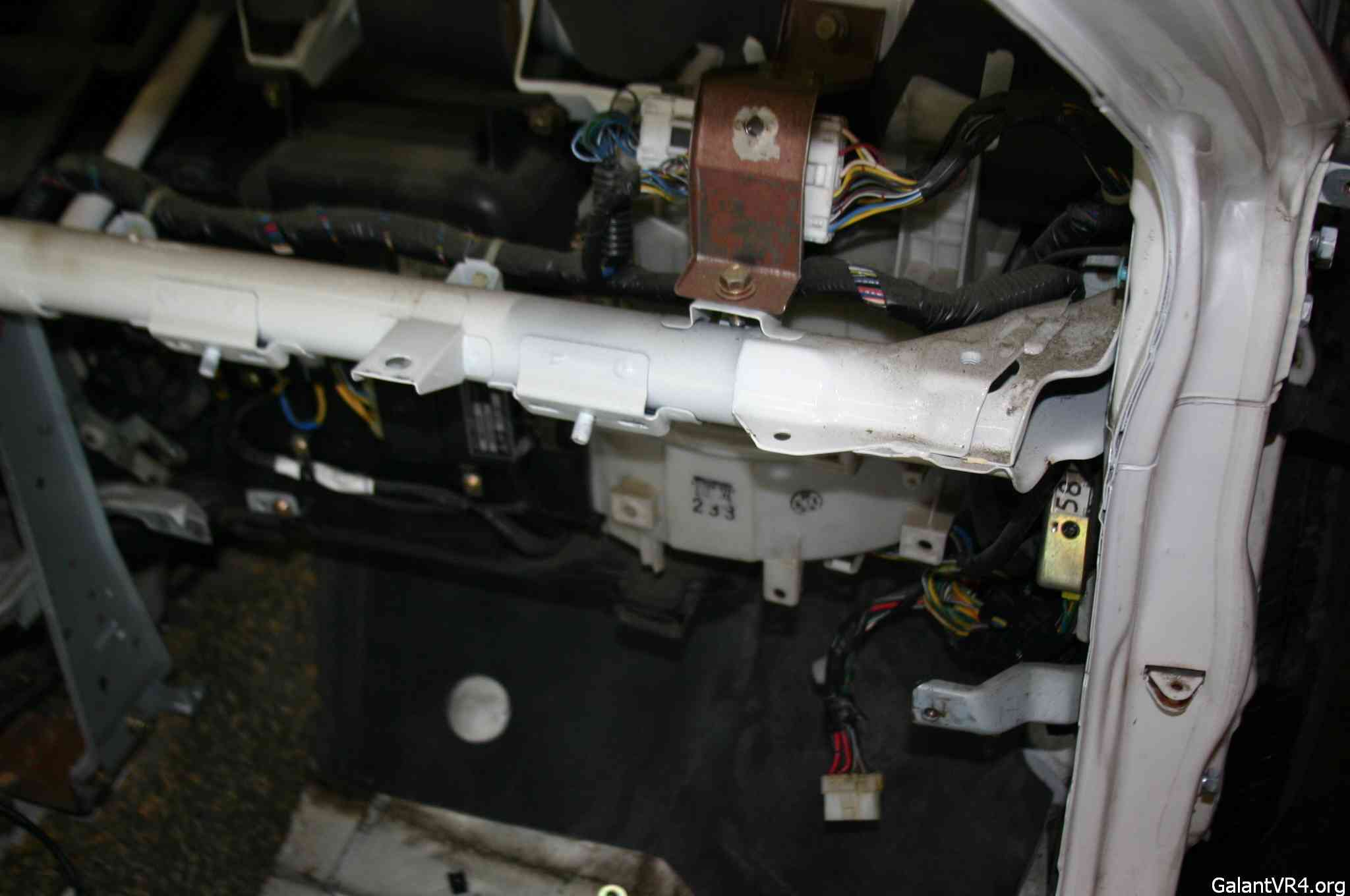

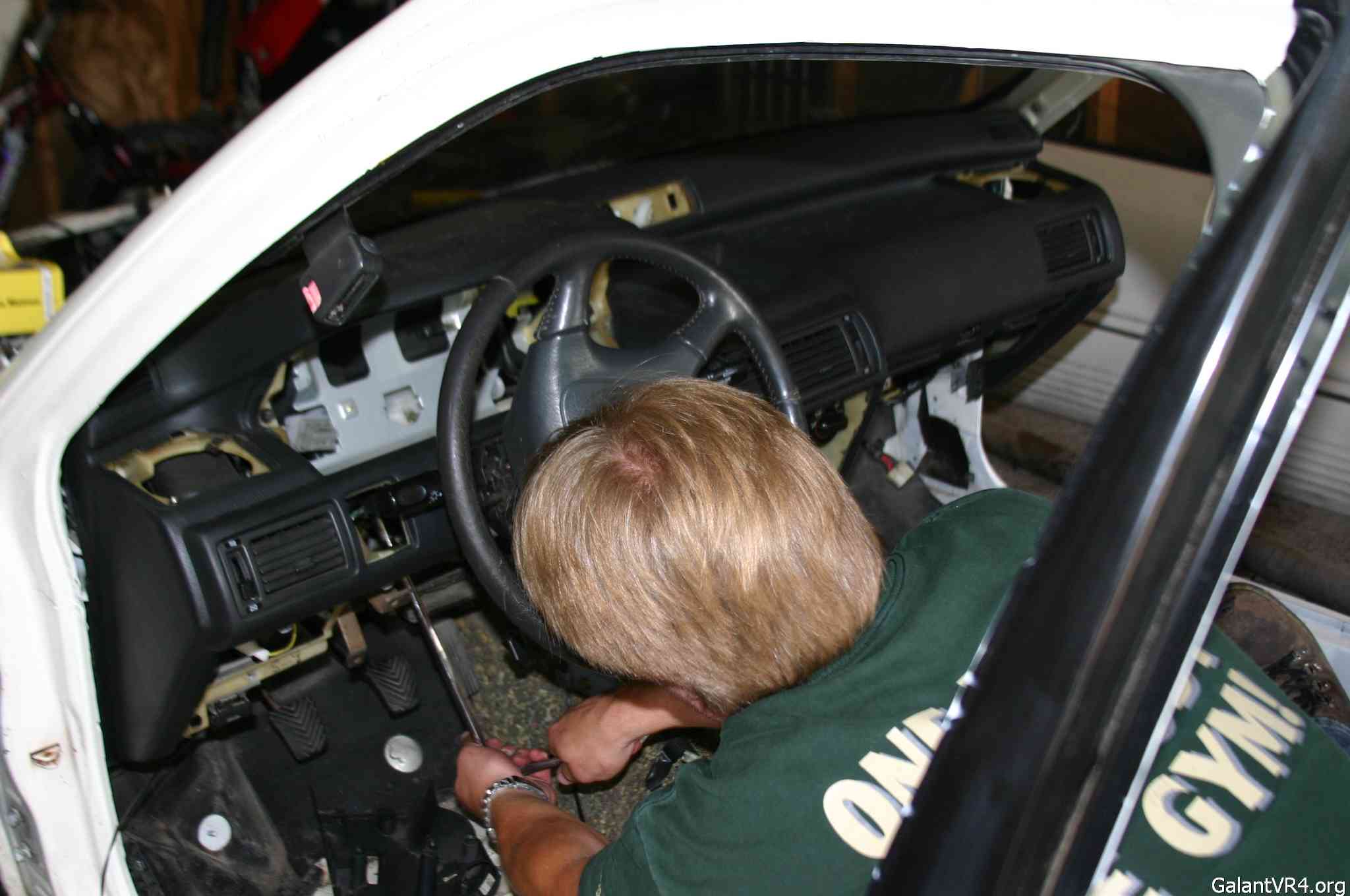

Yes G I am doing just that. Its actually real simple guys/gals. I just leave every screw in the stuff that I take out. Immediately tape it to the part where it goes with masking tape and put it in its proper box. I am not wanting to spend 4 hours trying to remember where stuff goes. I also take pics of where stuff goes like these so it makes me remember where stuff goes when I get to putting it back next spring.

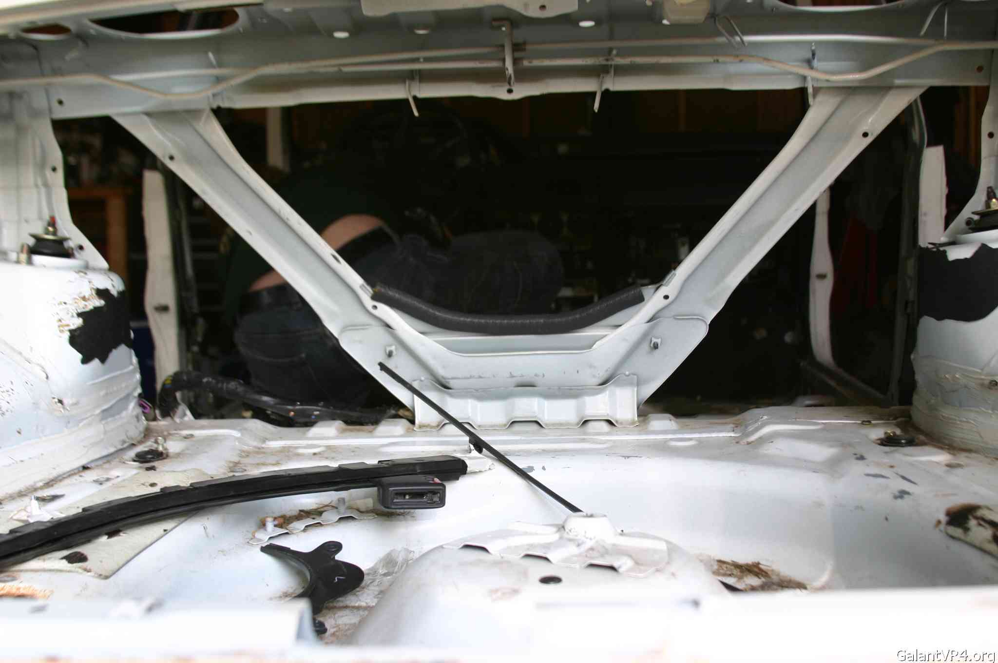

I still Have to pull all the sound crap off the floor...which sucks I might add.
Putty knife and hammer. works like a champ.
