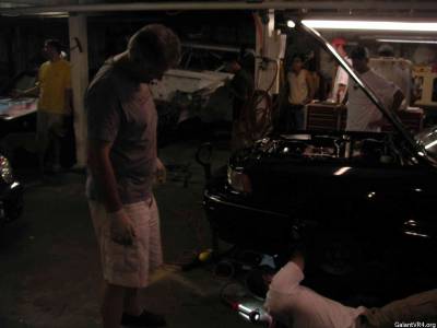

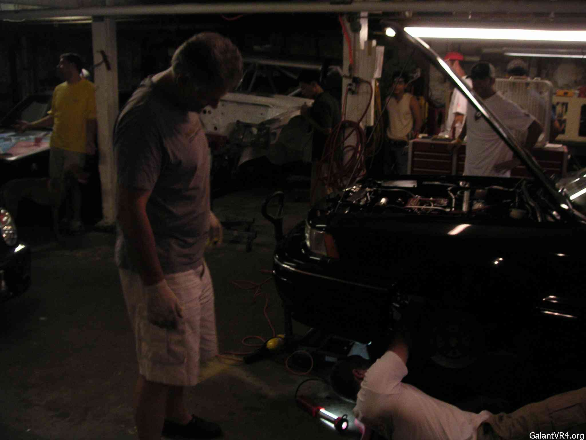

Thank you Cy! I knew it would show up at some point. /ubbthreads/images/graemlins/rofl.gif
However, check out my gloves and you will see I was not just standing around letting my son do all of the work.
We are taking our pressure reading from the same port as where the idiot light switch was previously installed on the filter housing.

When we did ours, as pictured above, we removed the Harmonic Balancer and bottom few bolts on the lower timing belt cover. For future access, it would make sense to do like Iceman said and drill the hole and put a plug in it. I hope we don't have to take ours off again anytime soon. The trip to NY Rally and back should be a good test!
