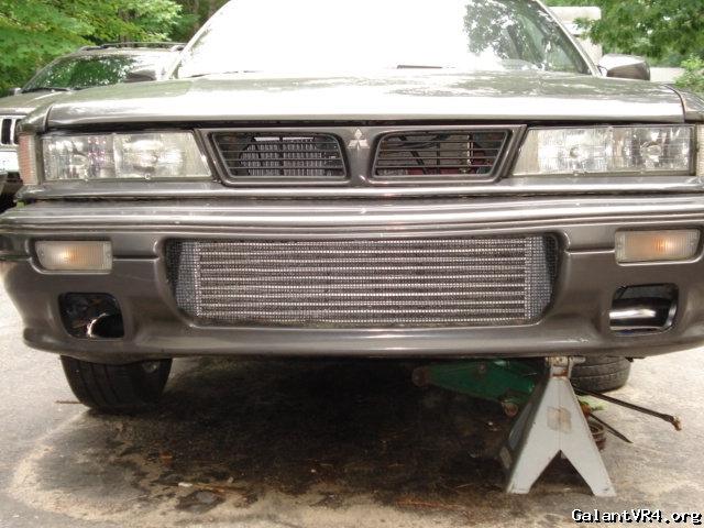

^^How's your coolant temperatures with that radiator?! I have a similar version but have been running into problems with over-heating...how many cfm fan are you using? Car looks great though by the way!
Thanks.
I have no A/C. The condensor takes a good amount of airflow away from everything, despite the galants "Refrigerator-Door" Flat style of the front.
Also a pusher fan is manditory when running a setup like this. Run it off a switch to go all the time.
All in all, I'm more Drag, and less Race-Track oriented. Biggest reason for the civic radiator.
Plus all the room that is freed up is incredible!

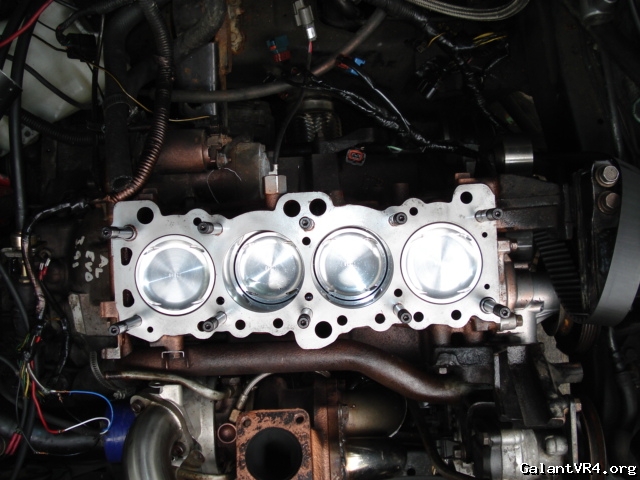

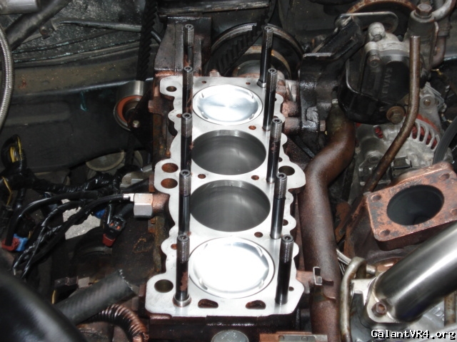

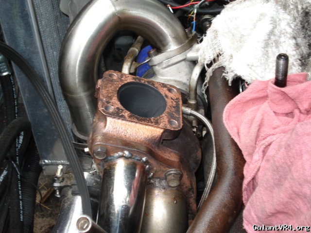

New cylinder head re-build. The old one has a warped surface, and a few broken guides.
To all those with ARP head studs, don't force the bolt past the valve spring.
There is a good chance the valve guide will crack, and drip oil into the cylinders.
Also there are some crap MIG welds I have to apologise for. Things happen, you gotta do what you can to get the car together.
Anyways..
Head will be back Thursday, and then I can finally enjoy the car more!

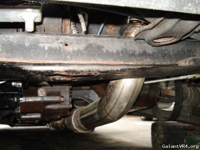

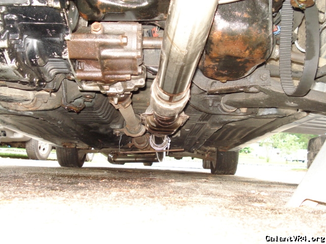

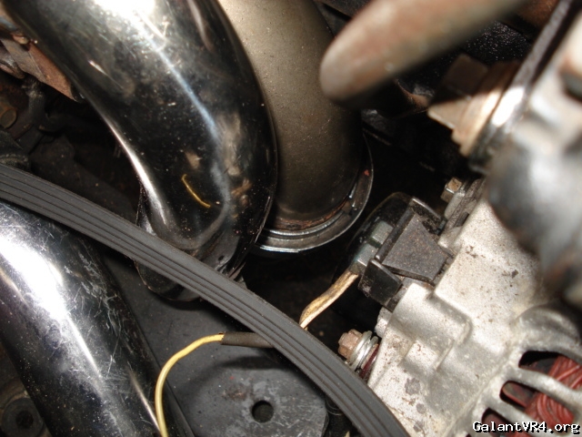

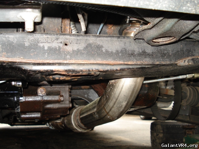

If that dump tube terminates right above the front crossmember, that's a surefire way to melt the wiring harness that runs right near it. You may wanna think about extending it down past the crossmember.
Its true. And I hate dump tubes.
This will be re-routed with an external in a few months.
Plus the car is fully undressed due to head removal. All will be tucked away.

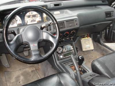

talons have an eagle on the wheel, this one has the diamonds which means its an eclipse wheel. either way they are the exact same other then the emblem.
Launch
Aug 17, 2006
350
Texas
some are leather wraped, others are not /ubbthreads/images/graemlins/wink.gif
