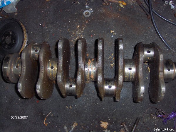

This is the wrecked crank. Can't even run a fingernail across the journal w/o stopping it multiple times.

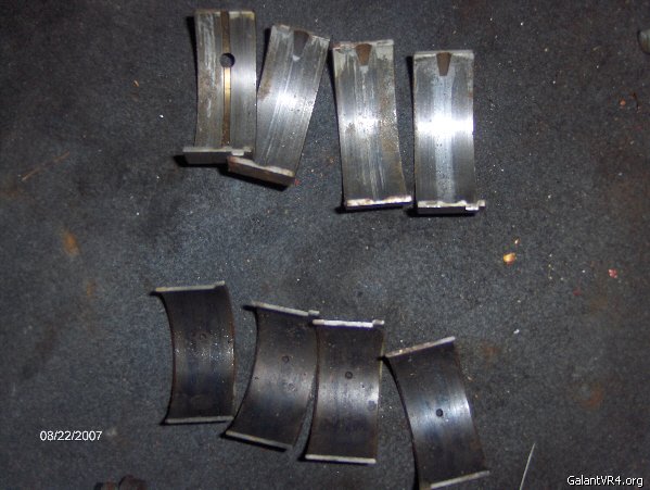

Bearings are obviously wrecked, and were never replaced despite getting charged for a "Rebuild". Look at the heat on the rod bearings.

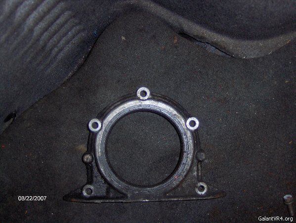

One of the leaking Main seals.

How long did that crank sit before you take that picture... there is acutal RUST on it, which is obviously not right.
You put a new crank in it I assume and didn't cut or polish that one?

And the crank has been sitting out since I tore the 2nd engine apart, only to find out none of the internals were any good. Everything on the engine is brand new.
i wondered the same thing...
as far as the tech comments, well, i see what you're getting at, but being that far out of "speck" tells you the motor is whooped. how or when is another story. 10k is just a silly statement. i don't think a brand new (remanufactured) engine AND new wiring harness would cost you that, but who knows what silly labor times/rate they had in mind....

I'm not a metalurgist, but I would think that a crank would not rust there unless it had some sort of damage to the surface.
Your right Hertz, it was gouged severley. Look at the bearing pic.

meh, i let a perfectly good set of stock cams lay around for awhile in the garage, and the are RUSTY!!! i'm sure any scoring expedited that process though.
According to the rod bearings, it looks like there was oil starvation.
