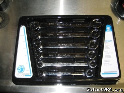

I concur a premium brand of flare nut wrenches can make/break you. I have both the Matco and Snap-On brand however I prefer the Snap to the Mat. Obvioulsy, they are pricey but well worth it. I think I paid $225.
Here's a picture of the Matco.
