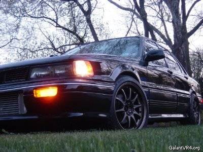

New Volk Racing wheels!
I really really like em. Bet you can't wait to put some wider rubber on those /ubbthreads/images/graemlins/smile.gif
Awesome wheels!!! let me know how they work out...I need a lot more rubber! What size tire do you think will fit?

Nice lawn /ubbthreads/images/graemlins/grin.gif, the rims look amazing as well.
the rims look. is it me or do they stick out harry? i could be seeing things since its early.

they look like they stick out a little bit.

They look perfect IMO.

They do stick out some. I knew this before I ordered them. The math doesn't lie.
I also own 9" wheels with 6.25 " back spacing and these are 8.5" with 6" back spacing.
40-45 in the front and 35-40 in the rear should put the tire 'under' the car farther but causes other issues on unmodified cars. (control arm and strut interference, and inside fender rubbing) With coilovers and other mods I have made to make the 9" wheels, I own, to work; I would have liked the above offset numbers. I would have liked the above offset numbers. But this is not a perfect world and Volk was 'nice enough' to the wheels "a pretty close to ideal" +30 mm. So it is what it is. They stick a little but I am hoping for less understeer and this shoudl help.
One of the racing teams runs a narrower wheel on the back vrs. the front of their EVO and it seems to work very well for them. I was tempted to do that myself.
I would have like them in a polished finish but again. I was told Bronze or nothing. /ubbthreads/images/graemlins/wink.gif I may have them stripped and hand polished like my SSRs some day if I decide I really like them. I ordered them to be my track wheels (once I wear out the 5 year old SO2) and the SSRs will be for get togethers.
If they don't grow on me I will sell them here first, I promise.

Volk did mine at +43 but i figured they knew best, so I went ahead and got them. fits perfect.
Hay Harry, please don't strip those beautiful wheels down. they look great just how they are.
ether way, your car kicks much arse!

/ubbthreads/images/graemlins/shocked.gif ... no no no !!!
I gotta agree with Sgt Dave on this one Harry. I love your car as much as the next guy but I just never liked the polished wheels. I just kept thinking to myself it needed black or bronze. In my opinion you just did about the only thing that could possibly make the car look better.
Really Harry I know I'm a petulant youth but sell the SSRs and keep the Volks ... PLEASE !!!

Never!

But how wide are they? My SSRs are +42 and fit perfect but are also only 7" wide.
