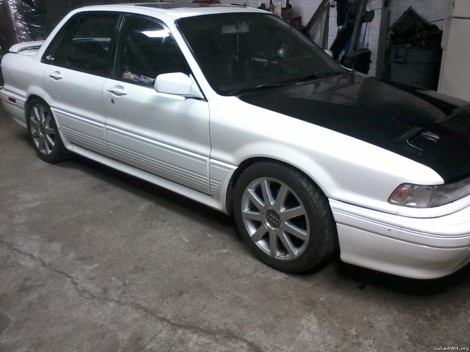

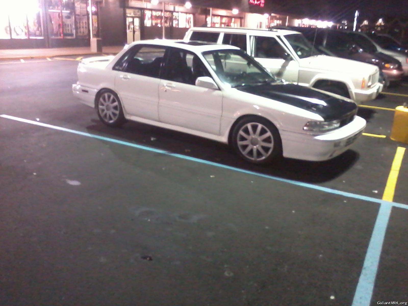

Looks good, prob not so safe though. Audi is 5-112, where as our 5 lug is 5-114.3, audi also uses a lug stud with a ball seat, as opposed to most lug nuts that are a 60 degree acorn seat. So, as there is only a 2.3 mm diff in the bolt circle, it appears to be "direct bolt" when it is not. I'm not trying to be jerk, just have tons of experience in this area, want you to know the facts.
