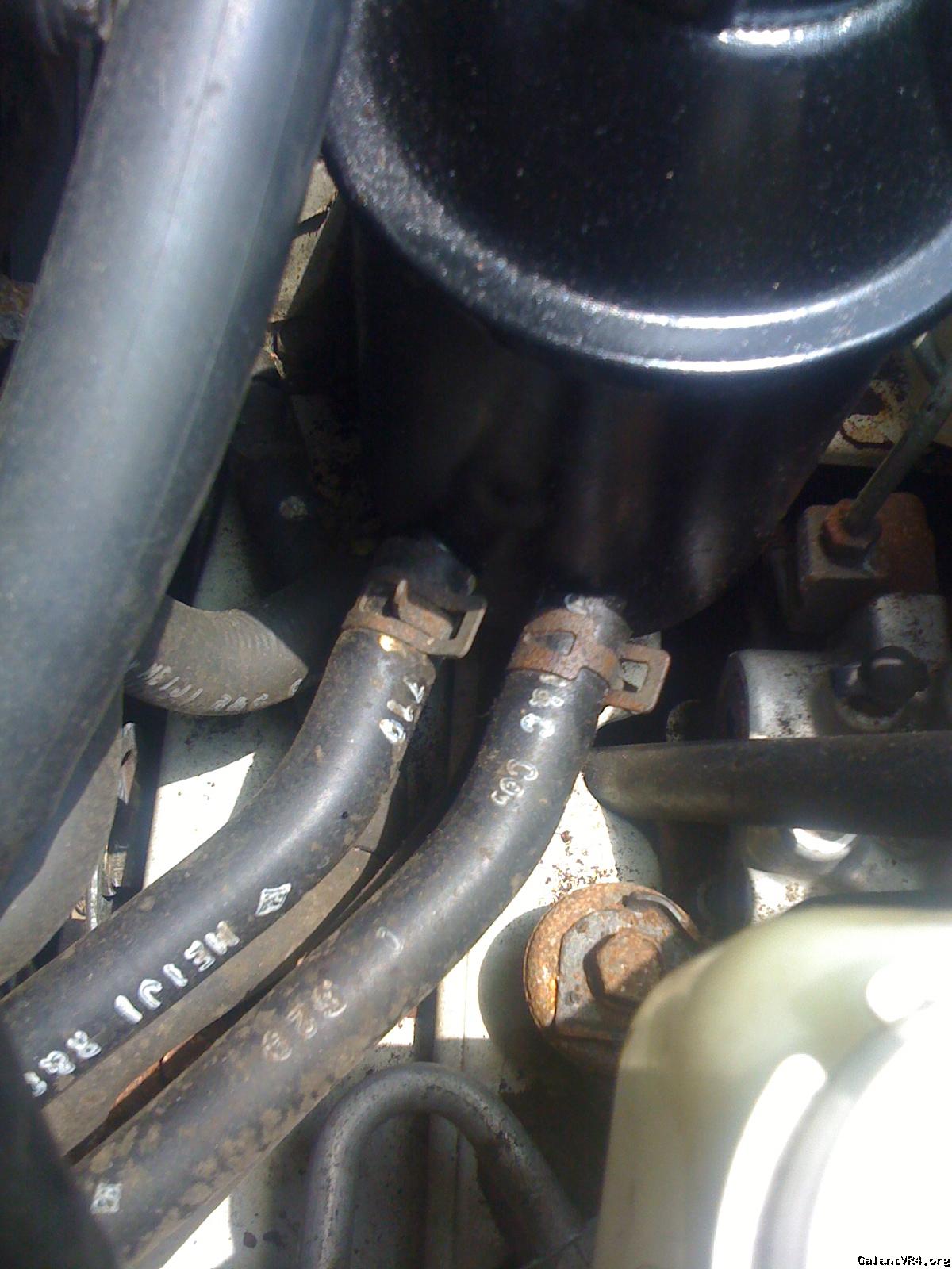

I did some further investigation and i think the line on the right goes to the cooler line, and the one on the top left is the one that runs to the rear.. i just need to find the other line to cap.

Could anyone chime in and let this newb know the quick temporary way to block off the 4ws to the rear just so I am able to drive to work.

Yea I know that thread from another member post above... You can block off the lines from the reservoir for a quick temporary fix. I just dont have a lift or a jack to get underneath my car.

If you can't get under the car, then you can't block off the rear steer. Get a jack, get ramps, go to a shop and use their ramps. If you cant find the caps you can weld the lines shut. But at some point you are going to be on your back underneath the car.
Are you trying to delete the 4WS or just plug it to get you by until you can fix it?

Just plug it until I can do a 4 bolt rear but its just leaking at the back and it drains the whole PS fluid out of the car.
