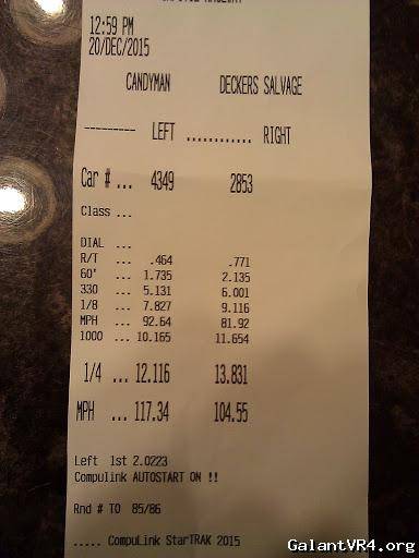

Well, I know I said I was done for the season, but I lied. Breaking an axle on the second pass last time I was at the track kept me from tapping into the car's full potential, which really sucked. Not only that, but I really wanted to push the car on the bastard 20G just to see what it was capable of, especially on E85. So, I figured what the hell, I'd hit the track up one last time before the snow files.
So, once again I drove the sh*t box an hour to Capitol to make a few passes. The high temperature was only 45* today, so I wasn't incredibly hopeful that I'd get out of the hole on a cold ass track. Turns out, the track prep guys were on their A game today, and that sh*t was sticky as f***. Of the half dozen times I've been there, the track has never been prepped that good, IMO. I was cutting 1.7 60's all day. First, let me say, I'm far from a pro driver. And second, I'm on Dunlop Direzza DZ101's at ~30psi...Not exactly a racecar recipe for good launches. The track was honestly just prepped really damn good. With consistent 1.7 60' foot times, the car ran 12.2's all day. The best pass was 12.1 @ 117.
Boost was peaking at around 28psi dropping to 26 at redline. Timing was still super conservative at 17* peak. There was plenty of room for more boost and timing, but before I got a chance to mess with the tune the car broke.
Somehow, 2 blades broke off of my brand new SPAL fan, which knocked a hole in the radiator. The car started pissing water everywhere, so I had to call it quits. I had one of my buddies grab some gas tank repair epoxy from the nearby parts store, and patched it up so I could limp the car an hour home. The is the second time I've had a SPAL fan that blades busted off of. It happened at the track BOTH times too, so IDK WTF is going on with that. It sucks, because the radiator and fan were damn near brand new.
Pretty much no fucks given that the car is broke, though. A new personal best isn't a bad way to end the season, broken car or not. I honestly think the car has a 11 second pass in it as it's current configured. With a better trans, I know it's an 11 second car as is. But, with plans to have the new 68HTA in new year, I'm not sure if I'll get another opportunity to push the car like it sits right now. I guess we'll see what next year has in store.
Per the usual, here's a photo dump of the day and some video of the 12.2 pass. There are a few shots of my buddy Dan's Talon and MK3 Supra as well.
1837 going 12.2
