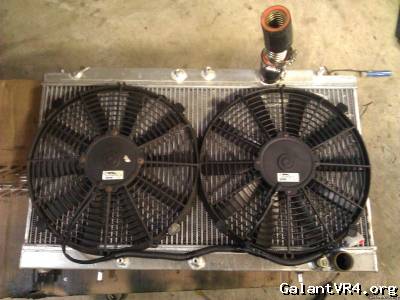

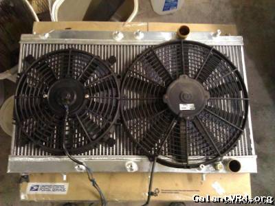

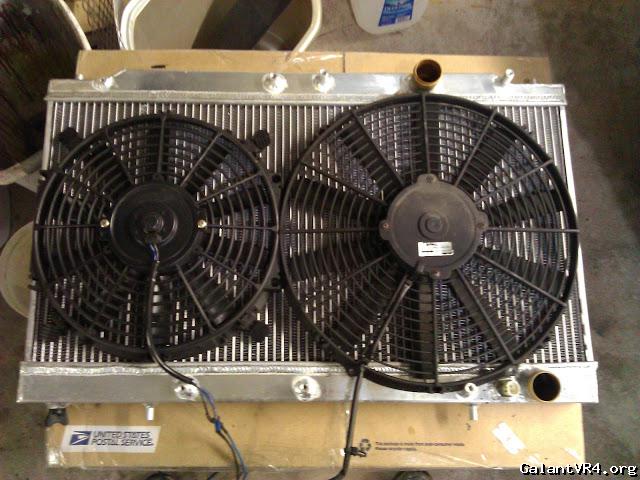

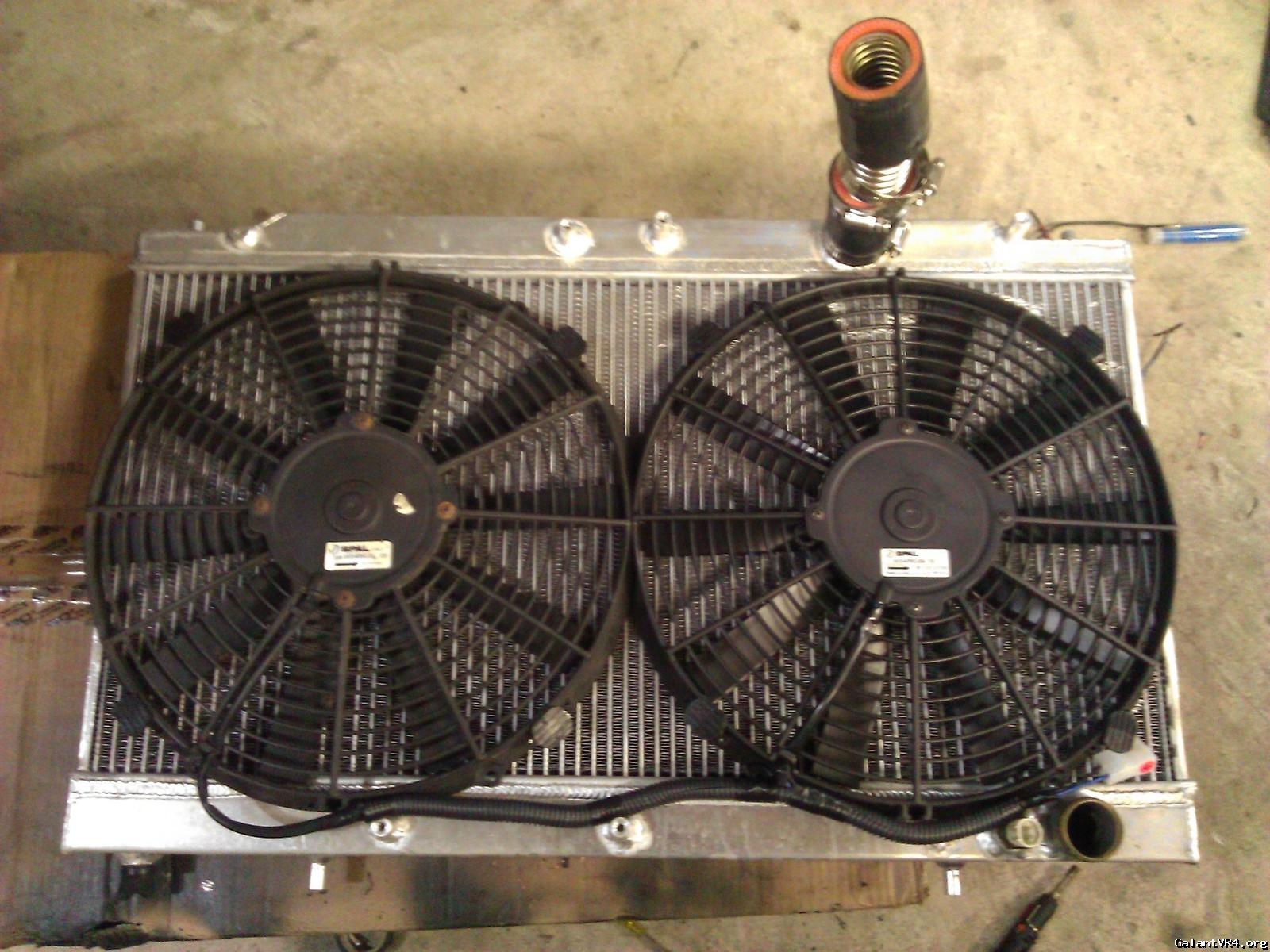

Something must be twisting/flexing/distorting to allow the blades to make contact with something.
I'd say your right! You don't install rad fans this way Brett...
3,479
That's an old picture of an old setup. This was the current fan setup:
There's a gasket on the perimeter of each fan. There's nearly a 1/4 of clearance between the blades and the closest part of the radiator. Apparently, that wasn't enough. To be clear, I know it's not the fault of the fan. It's something I'm doing. I'm guessing the plastic ties that push through the radiator aren't cutting it at 100+ mph, seeing as this only happens when I'm at the track.
No biggie, it's a cheap radiator and the fan isn't horribly expensive either. It just sucks I have to replace them both seeing as they were both fairly new. Gotta pay to play I guess.

Fan diameter is too big for the radiator. IMO, it should mount flush with the core. Congrats on the new times! Keep making that progress.
