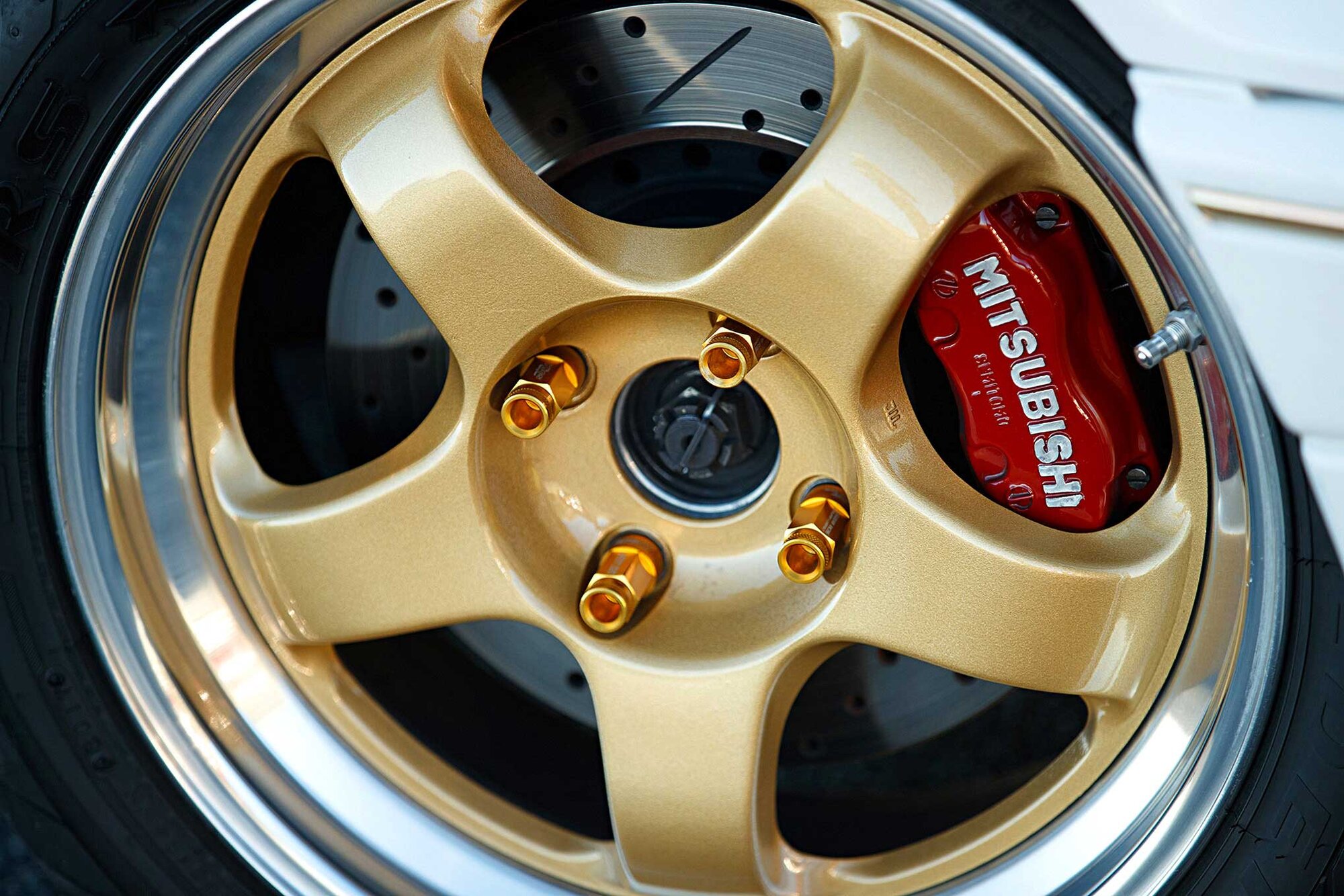

Also replaced the Muteki lugs with some project Kics Leggdura 2 piece lug nuts so nobody gets a free set of wheels.
v19he6jbkyn-nvhl9dsvaihifbhggdxyb37wapd1ldvhwjgiragfhyzbu0nfooelzi1vi0qrgjisguqbaig-w386-h685-no-jpg.335340
uojjtexvm0l4js6cz63oy2bqm7czyb1kxsjtndlzokv0rpucvitbim35qwwuqnrbj8uocghtpo6rzlyphg-w1218-h685-no-jpg.335341
fgwcvgea4iljs0vje48ace-nivgtdnc_hgp1agwo7j7d7toeb_qg11gv4zyqdlwh0gfvojvsm140bgmy2g-w1218-h685-no-jpg.335342

While the car was down, I also did some work to the front brakes. I gave the calipers a fresh coat of paint, and cleaned up the front hubs. I also installed new StopTech Sport drilled & slotted brake rotors and Hawk HP Plus pads.
gaqj6fp9vjlyvwpyfkkeo66_57_dqtp6wjjeyjioundxgbpjtad6nub2j07wqgjrkh8b1bkobseqrqkhwq-w1218-h685-no-jpg.336790
_pqmipe6yszvsn2azk1c9eqgb81avnmhpjmso2ad18viv0jh91uasew_h8icwbjmc1z5imbjqg1yggkiuw-w1218-h685-no-jpg.336791
nh-ylipk93csprafwhhgmvo6aaohy2cuti0zgbrykbfkyhx6alkojvc4filqogtcqh7qcodlug1nuh0tea-w1218-h685-no-jpg.336792
bdpqe9imqzqmvmfsqaj43mn3jgbl_cycgm5gfl1re9f9revi7kw1scxofimbs5e_gqsbnzw15fvsceyv-g-w1218-h685-no-jpg.336793

Looks good man. Are those 1g or 2g 3kgt calipers?
I appreciate it, G.
They are the 2nd gen (1994-1999 IIRC) 3KGT calipers which use the larger 12" rotors (12746052L (/R)). They look and work awesome on the Galant.
