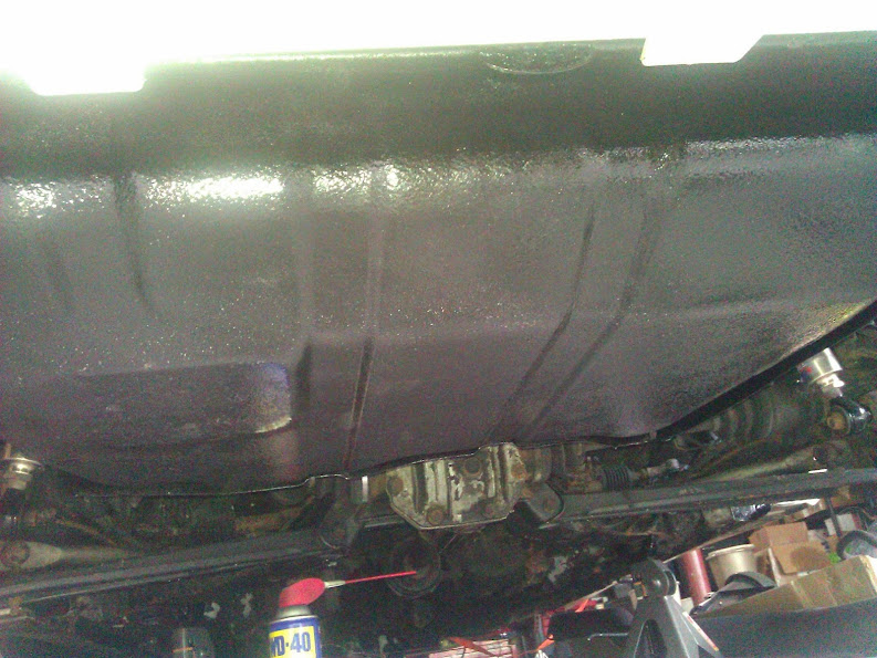

Fuel tank bolted up:

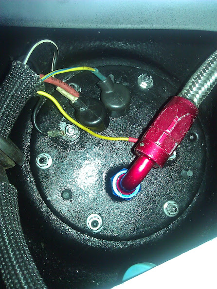

Fuel pump bolted in and rewired:

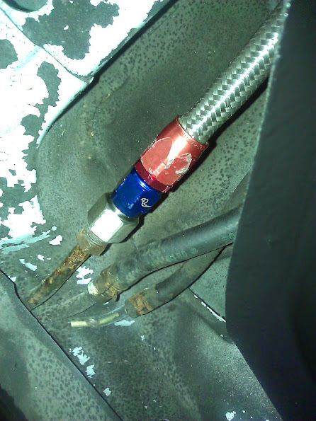

-6 AN pump to feed:
I fired up the fuel pump using the test port under the hood, and no leaks! I made an initial fuel pressure adjustment, and the fuel system should be good to go now. I'm just waiting on some piping and couplers to finish up the intercooler, and then this thing should be up and running.

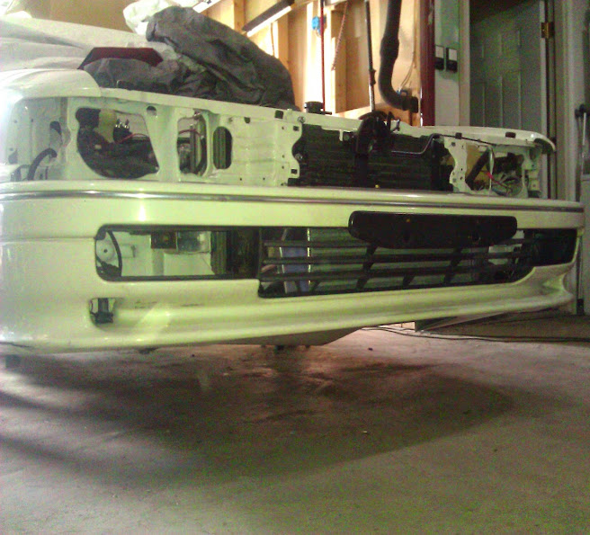

Got the radiator in.
And, now for the good part...
The core just barely fits behind the bumper. /ubbthreads/images/graemlins/grin.gif
