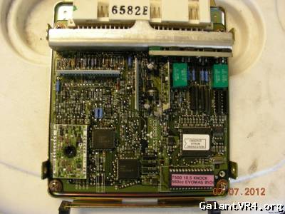

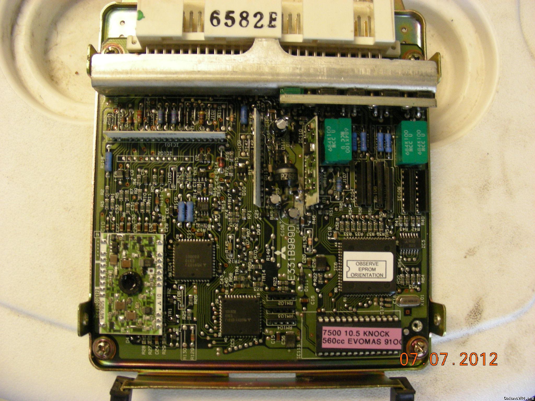

Like Driggsy had mentioned to me the original ECU has a BUNCH of what I would describe as paving tar all over the motherboard, most notably around the caps and driver PCB's. I'm sure it's some type of electrical sealant however I'm gonna write it off for parts and the mounting case.
Still trying to decide whether to have 'Link folks convert the extra non-EEPROM one or keep it for future troubleshooing and find an EEPROM local ( there are a few ).

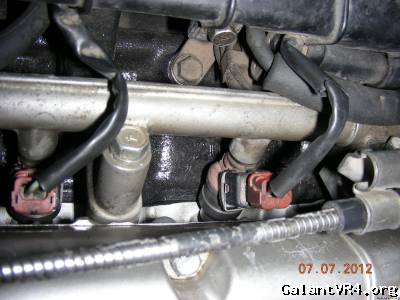

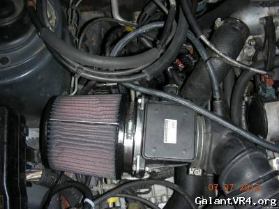

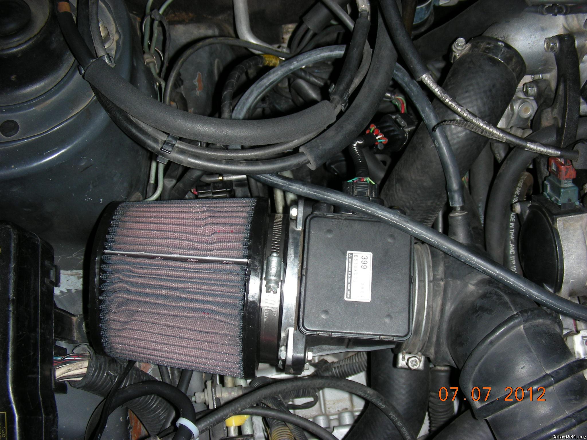

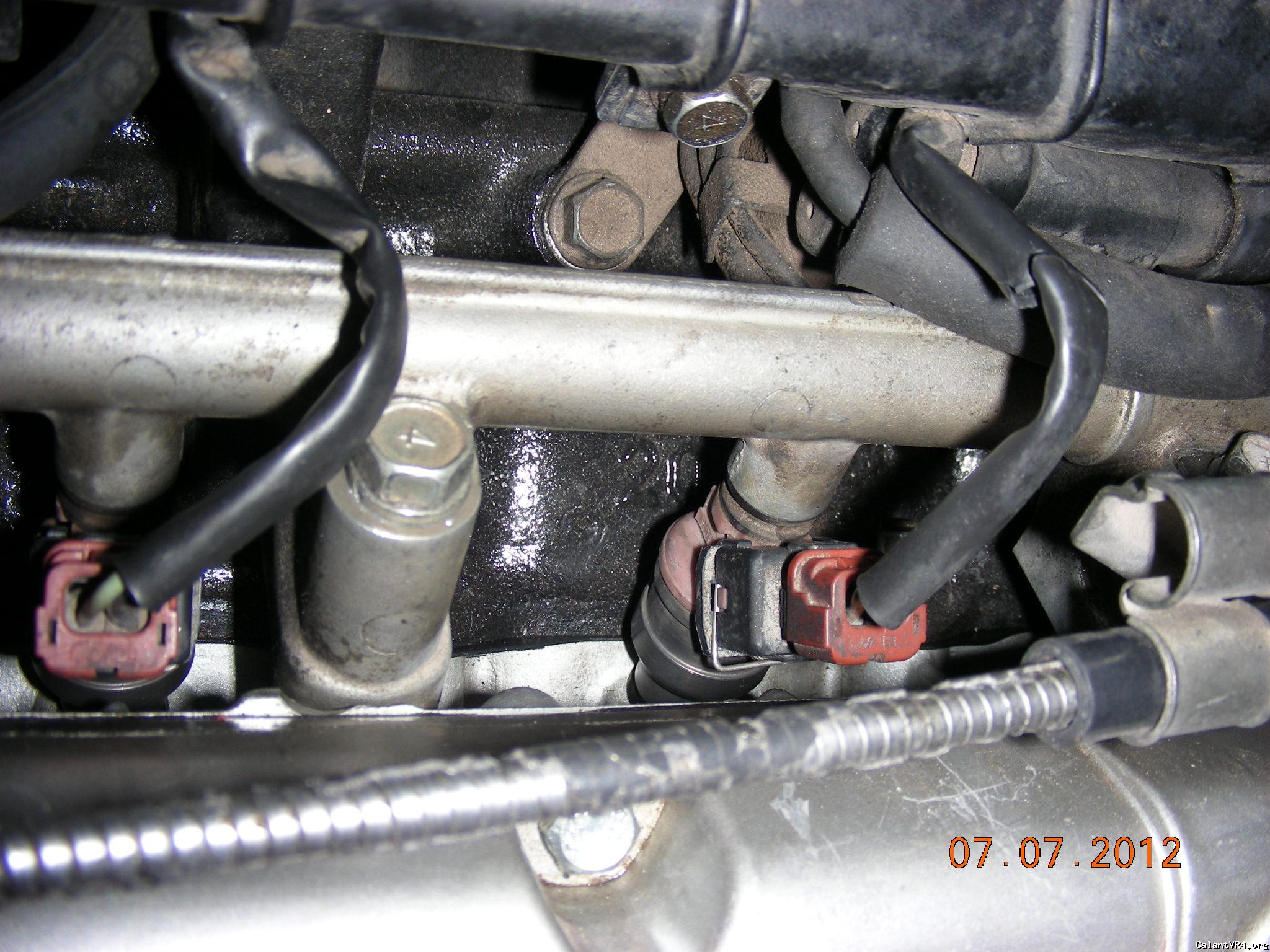

Installed the EVO MAF, 560cc pinks, and custom EEPROM just now. Success! Runs great, idles spot on, boosts to 15psi with no taper or problems. Gonna let things settle then start cranking up the boost a touch. Here are some pics:
