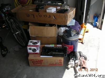

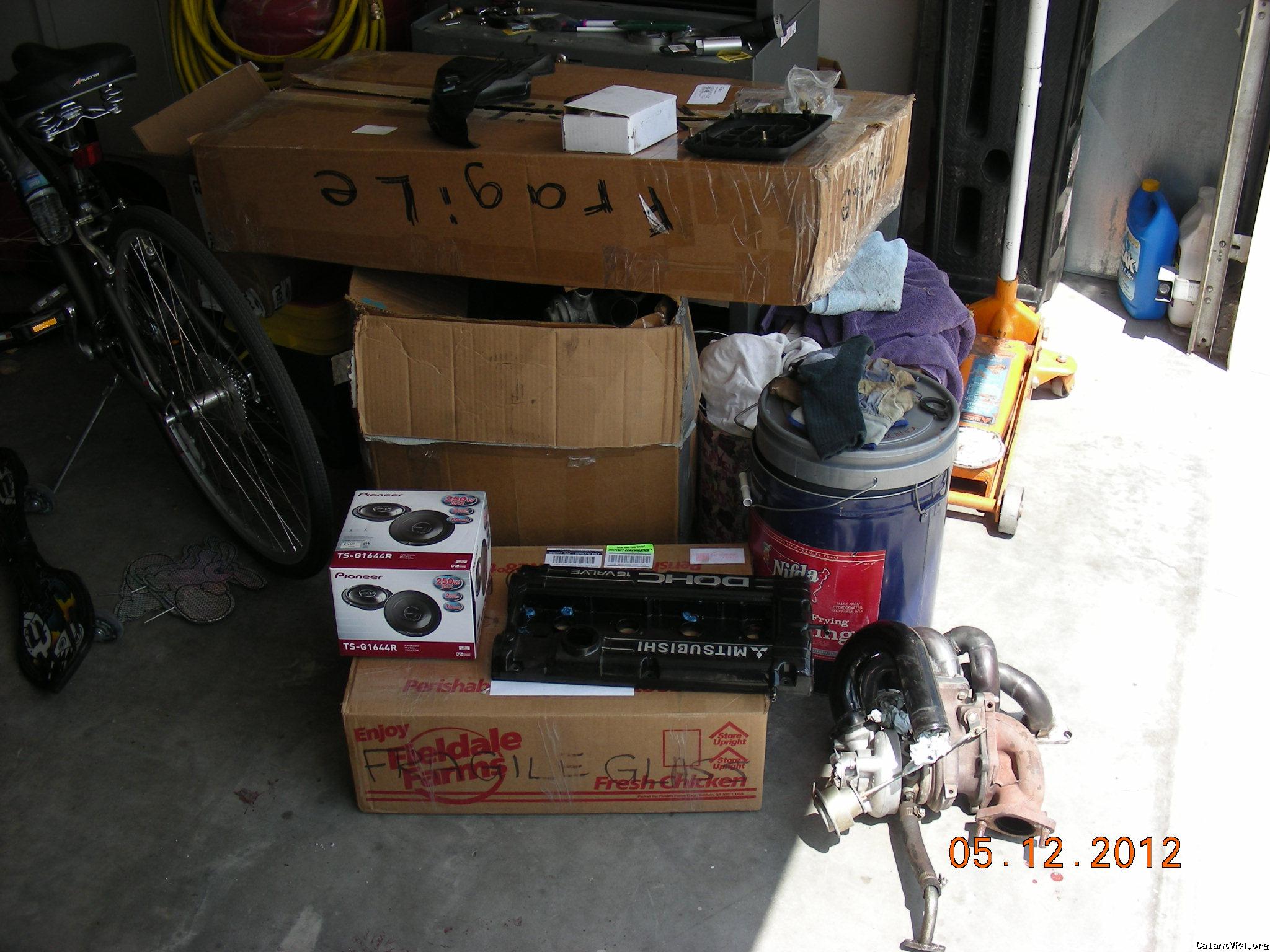

Went on travel immediately after getting 464 back to ABQ. Still have the pile of boxes/parts waiting patiently. Pic is below.
Managed to crack the VC before leaving PHX, oil all over the spark plug galley. Got another one from a local DSM buddy, all is good again short of the TEL silver color mismatched to B's nice black paintwork.

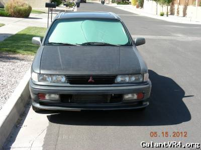

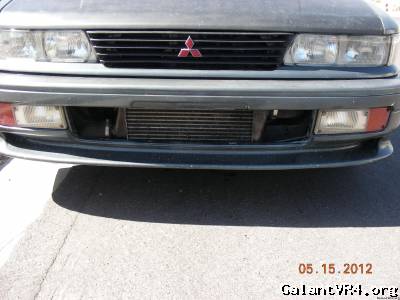

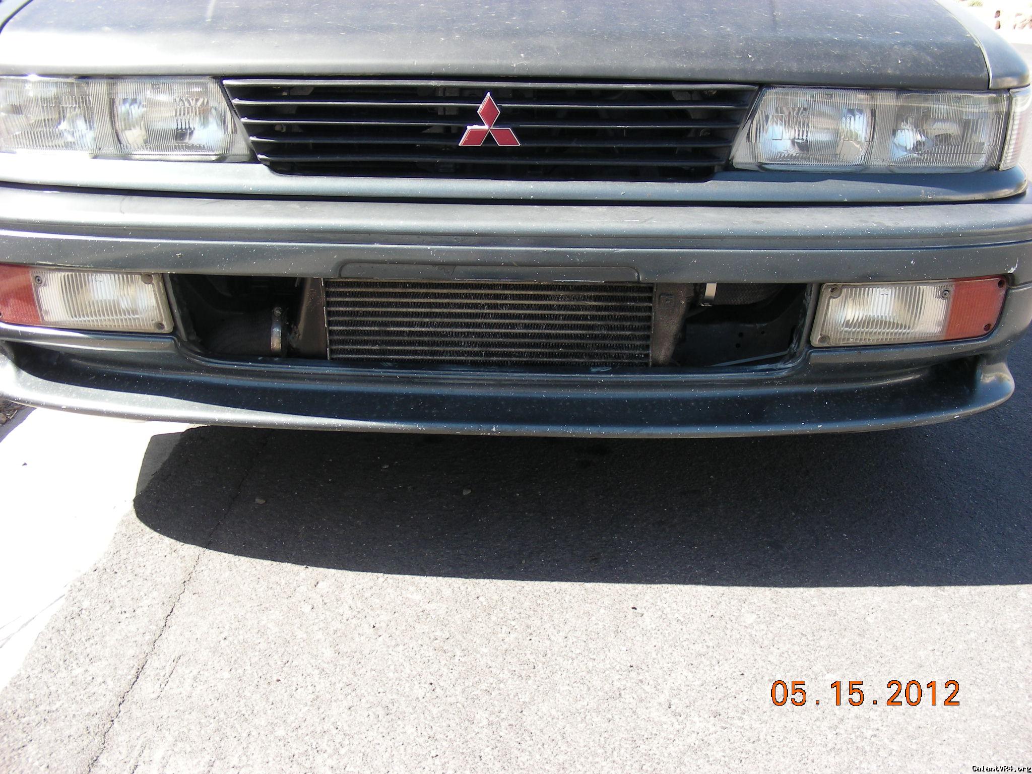

ktmrider
Sep 10, 2007
3,128
Tempe, AZ
Got the FMIC installed last night, actually "borrowed" the inlet pipe and hose from 86/2000 ( thanks Chicago1, made life waaaay easier ). Feels great, butt-dyno says spool is quicker/harder however it ain't too difficult to outperform the lousy stock IC.
I also hooked up the logger and reset my BISS due to the "new" ISC. Once it was dialed I checked the fuel trims again, my L value was near 105% vs 125% with the old ISC. Looks like it was the culprit for high/lean idle trims and elevated HC.
Gonna put a few miles on then tackle the B16g and tube manifold. Once they're sorted it's Game On for Link and related air/fuel items. Hope to be boosting to 18psi by July!
