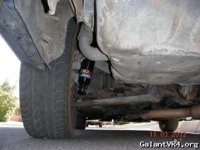

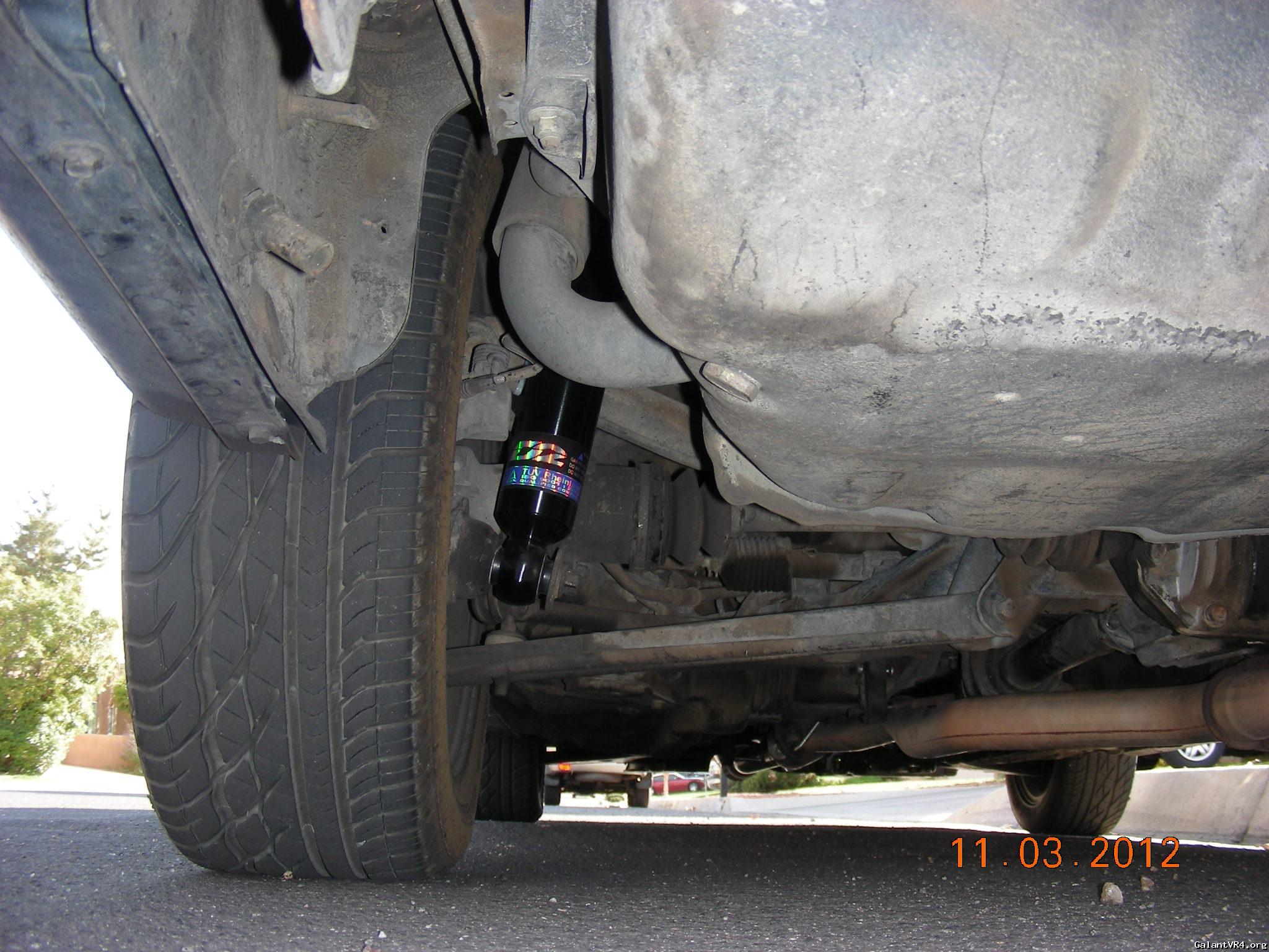

Next I installed the rear D2 coilovers ( waiting for alignment time from local buddy ). Set them to near max height and initial preload. Monster truckin' baby LOL. Will give them a few weeks to settle then do up everything.

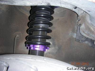

Installed the front D2's, been playing with the dampening and height settings for the last 2 weeks. Not too bad for DD duties, a bit stiff on small stuff but for the massive improvements in handling they're way worth it.

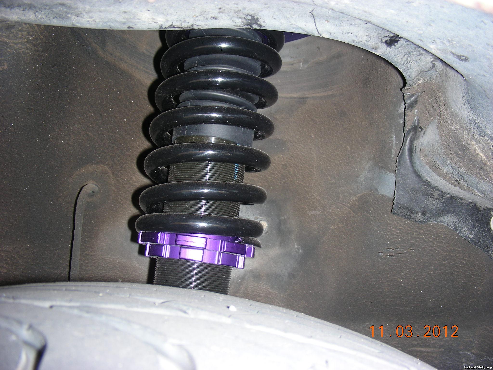

Here are some I just took, sorry for the glare:
Found the original rear stuff had GR2's with H&R springs. Fronts were Tokico struts with OEM springs.

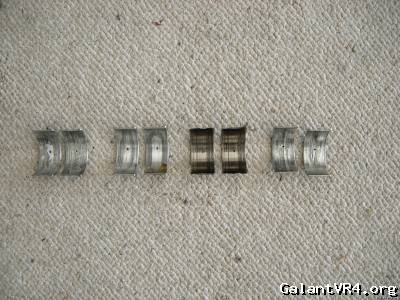

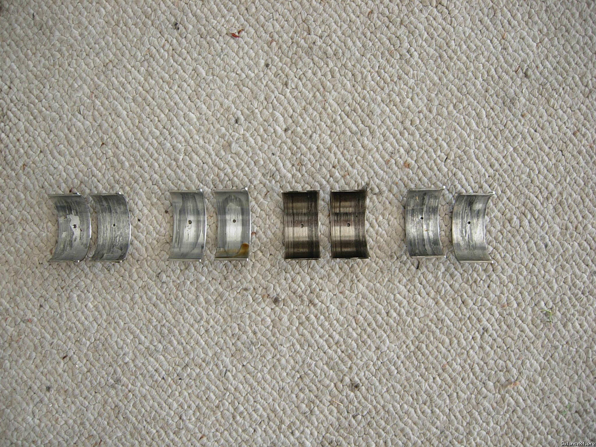

Here are the rod bearing pics, 4 -> 1 left/right.
Still thinking out the repair, lots of options.

Thanks for the pics, Mike.
It's never good when the register tabs ~diss~a~fawkin~peer~
Think that shell *may* made a lap or two around the big end before it found a spot it liked. /ubbthreads/images/graemlins/banghead.gif
Not *quite* sure what the root cause was, but it definately looks like the oil wedge was broken all the way down a time or two.
Did you have issues with knock/detonation on this engine at some point during it's history with you?
