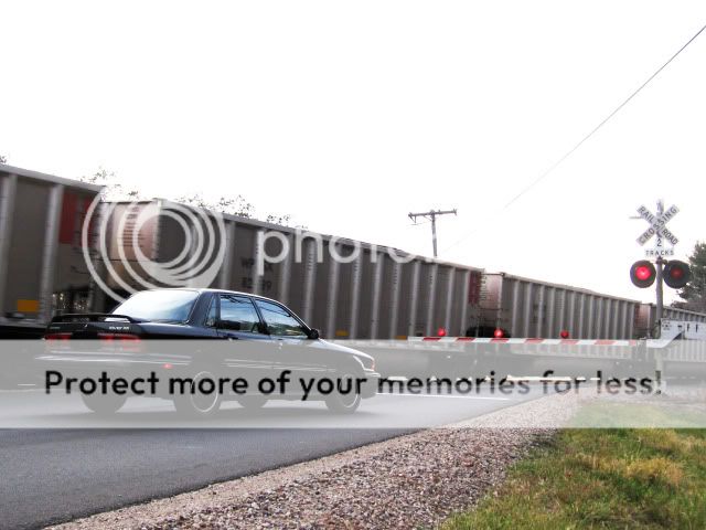

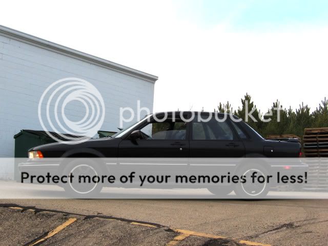

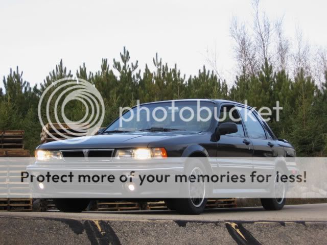

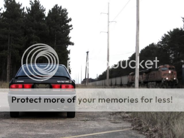

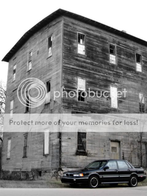

I went home to drive the car for a bit this weekend. I got it all clean and took it for a photoshoot. Here are some pics enjoy!
thats one sexy galant you have there! /ubbthreads/images/graemlins/applause.gif

BTW, the car does look very good. Although, with a completely stock Nile Black car myself, I'm slightly biased.

Also thanks for the headgasket tips, and the car compliment.
