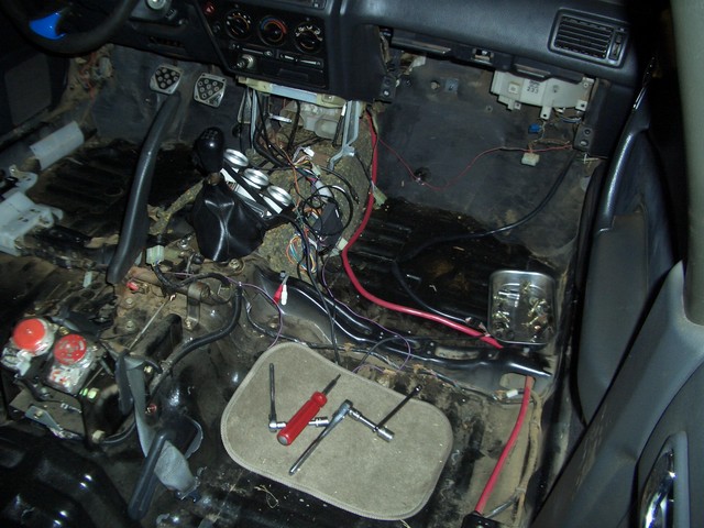

Picked up the heater core today. I guess I'll get started on it this weekend if nothing else comes up like honey do's. By the way, which approach is the best way to go at it? Pulling the dash or going from the passenger side. Which has better access whithout breaking stuff?
I have replaced this heater core (the whole thing with the core in it) with a brand new OEM unit, and my advice is to pull the dash. You will have better access to the core with the dash out. If this will be your first time to pull the dash then it will take some time. Plan on at least a whole day.
Barnes
Feb 9, 2003
6,249
Richland, WA
I also agree on pulling the dash. Very helpful tip: Unbolt the steering column from the big rail under the dash. There are 4 large bolts that hold it up. This allows the dash to lower down and sit on the seat, thus making the dash removal much easier. Other than that, just take your time and carefully label all the parts you pull out.

Finally stopped dragging my feet on this. It was in the 30's today and I got the heater box out. The Auto Zone heater core really fit well. It went into the box just like the one that came out. Even the tubes laid in the same location as the original. The only issue I saw was this core did not come with any insulation. Tomorrow I'm gonna add some foam insulation on the sides to make it realy fit like oem before putting everything back together. Gotta get some heat before it really gets cold around here.
