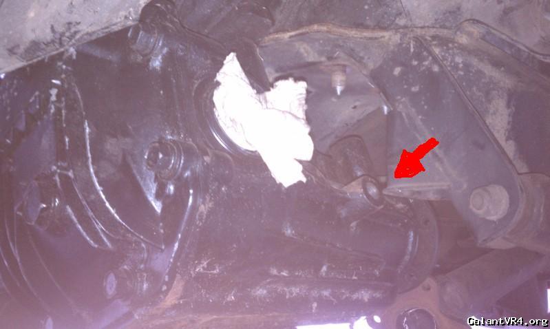

So I'm having problems putting the 4 bolt rear end in. Well the one problem is that the side part of the rear end keeps hitting the subframe. I took a pic and u can see what I mean. My roommate has been helping me but to no avail. Any tips?

That is probably the crappiest pic of all time, and it isn't doing you any good. Are you swapping the internals or the whole rear end? You don't have to swap the whole pumpkin. You can crack the pumpkin, put the lsd onto the stock ring gear and keep the 4ws all without much ado.

I know the pic sucks, ill get a better one tomorrow. I'm swapping in the whole rear end. Getting the old one out sucked but nothing compared to this.

I cannot tell what is hitting where in that picture. Looks like a scanned Polaroid from 1978. Circle something so we can see it better.
Dimension and bolt pattern wise, they should be almost if not totally identical, save for the pump section.

Is the pumpkin is hanging up at the arrow?
You can't just go straight up, it's got to come from the back (iirc)
Each subframe is a little different dimensionally, and if the bent over lip is prominent on your subframe, it may take angling/tipping the the unit up or down to get it past the lip.
Better pics would help! /ubbthreads/images/graemlins/smile.gif

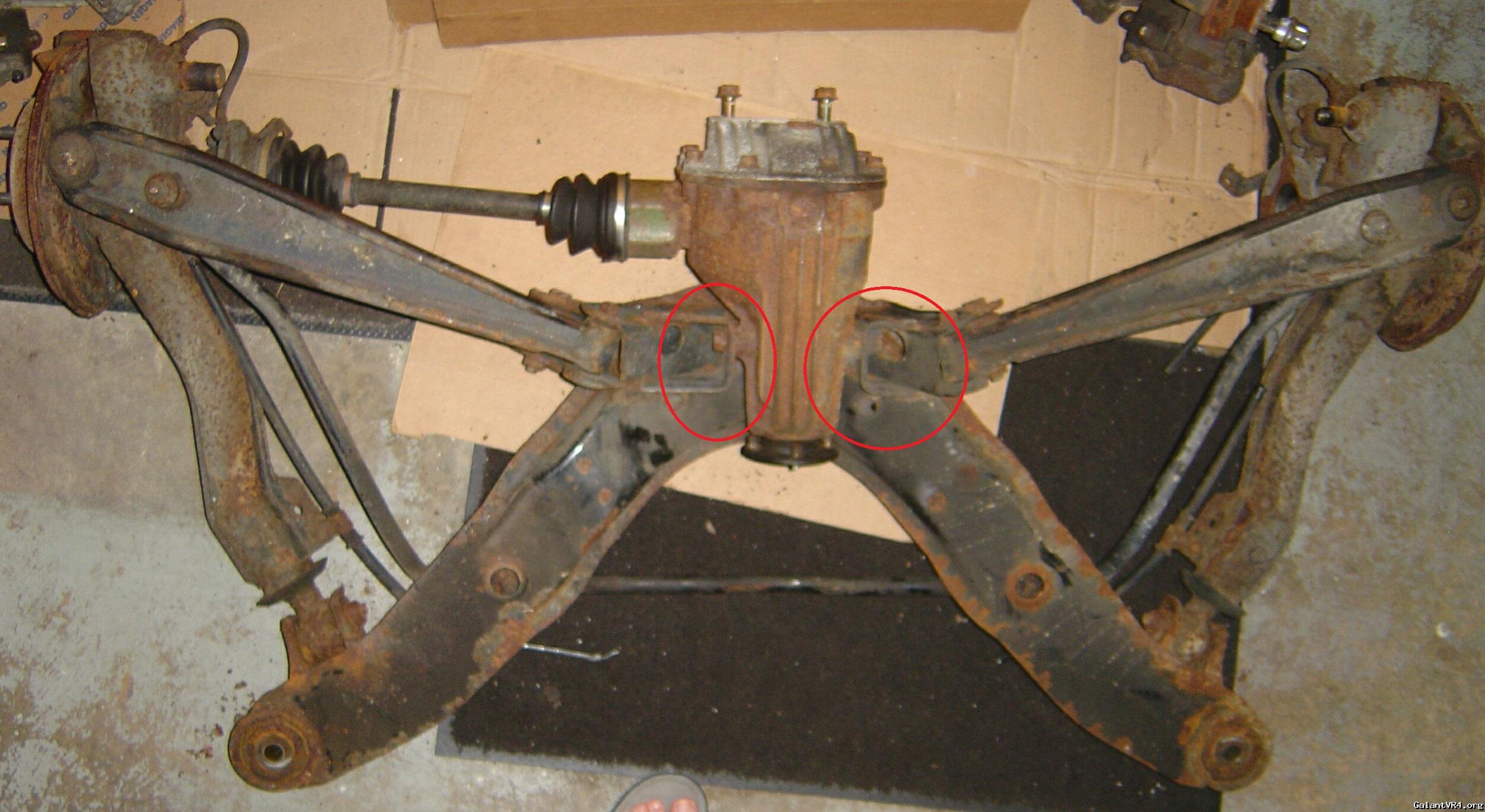

Yeah, Toybreaker nails another one.
They wont just fall out and go straight back up. Remove the moustache bar, drop the bottom mounts of the rear struts and lower the sub-frame as low as it will fall (of course, support the car very well with stands on the frame rails).
Once you have it low, slide the pumpkin into the frame and it will rest on those side mounts.
Once lined up and you have room to work, it is a simple job.

That boss needs to slide in from the back. You cannot go directly up. You will notice a little lip on the sub frame. As above, remove the moustache brace and enter from the rear... /ubbthreads/images/graemlins/smile.gif

Ok so thanks guys for the tip, moving the moustache brace worked great! Now I have another problem.
